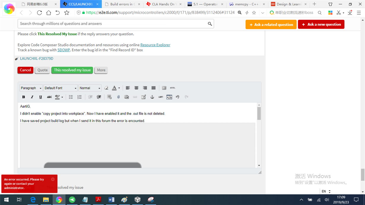

  • AartiG,
    I didn't enable "copy project into workplace". Now I have enabled it and the .out file is not deleted.
    I have saved project build log but when I send the log file in this forum the error is encounted.
    Jingtai

  • I need to see the build errors that you experience when building the project. The project archive does not help me because I have already verified that the project builds fine for me. I need to see your build log that shows the errors.
    Please try attaching the build log again using the "Insert File" icon.
  • Is this log file?
    I insert file and when I post the system prompts
  • I did in this waylog.rar

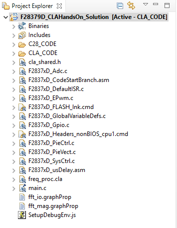

  • Thank you for attaching. The log does not show the compiler build steps as you probably did a Build instead of Rebuild, but looking at the linker build step I can see that your build is missing the F2837xD_FLASH_lnk.cmd. I don't know how that happened. Did you make any changes to the project after importing it?
    Here is a screenshot of the project after I import it into my workspace (with "copy project to workspace" checked). Note the file F2837xD_FLASH_lnk.cmd is part of the project.
    I am also attaching my build log here for comparison. Take a look specifically at the link step and notice that yours is missing the "C:/ti/CLA_HandsOnWorkshop_170317/CLA_HandsOnWorkshop_Camtasia2017/common/cmd/F2837xD_FLASH_lnk.cmd"

  • In my project explorer the F2837xD_FLASH_lnk.cmd is gray
    That indicates that the file is excluded from the project build. More information on excluded files here:
    http://software-dl.ti.com/ccs/esd/documents/users_guide/ccs_project-management.html#exclude-files-from-build
    The reason you do not see the F2837xD_FLASH_lnk.cmd in your Windows Explorer is that the file is not physically inside the project folder but is instead linked to the project. http://software-dl.ti.com/ccs/esd/documents/users_guide/ccs_project-management.html#adding-or-linking-source-files-to-project
    I don't know how or why that file got excluded, but the file needs to be "included" in the build. To do that, right-click on the file name in the Project Explorer view and de-select "Exclude from build".  Then rebuild the project. That should resolve the build error.
