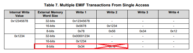

  • electrocc,
    Is it possible that you are observing the time for two back-to-back accesses?  The C28x is 16b-word addressible so each access will generate two 8b operations.
    This behavior is briefly covered in the EMIF appnote.
    -Tommy
  • Hi Tommy,
    Yes I think this is what's happens. So how can I proceed to write only one 8b operations?
    For example,  I want to write 8 bits data to the address 0x3FFE, and read datas (8 bits) to the adresses 0x3FFF?
    If I've understood the appnote, if I want to send data "0xA0" for example, first write is "0xA0" and second write is "0x00"?
    How can I proceed to send only one word "0xA0"?
    Because if the data viewed by the external memory is the 2nd write, it's not correct (0x00 instead of 0xFE)
  • electrocc,
    C28x address will always represent 16-bits of data so you will always write in 16-bit increments.
    Each Write operation shown in the table represents an atomic operation that acts upon different addresses as seen by the external memory.
    -Tommy
    TMS320F2812 belongs also to the C28x familly? So the behavior is the same between F2812 and F28379D?
  • Yes, any device with the C28x processor will inherit its instruction set architecture.

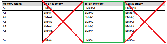

    I'm agree that C28x is 16b-word addressable. But why do you say external memory is 8b-(byte) addressable?
    So I have to divide all my addresses by 2?
    One address on C28x correspond to 2 addresses in external memory? (example : address 0x0030 0000 on C28x correspond to addresses 0x0000 and 0x0001 in external memory?)
    Following what you said, if I want to write, for example, to the Control register (address 0x3FFE in the memory), I have to write on address 0x0030 1FFF on C28x?
    If it works like that, for example, how can I have access to only Status Register (address 0x3FFF in the memory) on address 0x0030 1FFF, and not to the Control Register (address 0x3FFE in the memory)?
    From what I understand, the external device has an 8b data bus....hence 8b addressable.
    electrocc said:
    ISo I have to divide all my addresses by 2?
    Yes, each 16b access will produce two 8b operations.
    The purpose of observing the EMIF signals is to confirm the address bus translation from the C28x access to the external device. I am not comfortable with treating this theory as the root cause of your issue without confirmation. You can certainly experiment with different addresses to see if they line up with expectations.
    You would probably be able to do this by configuring the EMIF to operate in 16b mode and only using the 8 least significant bits of each C28x word.
  • Hi Tommy,
    I want to write 8 datas to the external memory, so obtain datas like below :
    (1)
    - External memory offset 0x3B00 : Data = 0x01
    - External memory offset 0x3B01 : Data = 0x01
    - External memory offset 0x3B02 : Data = 0x01
    - External memory offset 0x3B03 : Data = 0x00
    - External memory offset 0x3B04 : Data = 0x41
    - External memory offset 0x3B05 : Data = 0x00
    - External memory offset 0x3B06 : Data = 0x01
    - External memory offset 0x3B07 : Data = 0x00
    Following what you've said, each 16b access produce two 8b operations.
    I use this (part of) code :
    #define ABCC_PARALLEL_BASE_ADDRESS        0x300000
    #define iDpramOffset                      0x1D80
    UINT16      iBytes = 8;
    UINT8*      pabDpram;
        pabDpram = (UINT8*)( ABCC_PARALLEL_BASE_ADDRESS + iDpramOffset );
       for( iBytes = 0; iBytes < iLength; iBytes++ )
            *pabDpram++ = (*pbSource++);
    I've the issue I've expected :
    The external memory will see :
    - External memory offset 0x3B00 (address 0x301D80 on C28x) : Data = 0x01
    - External memory offset 0x3B01 (address 0x301D80 on C28x) : Data = 0x00
    - External memory offset 0x3B02 (address 0x301D81 on C28x) : Data = 0x01
    - External memory offset 0x3B03 (address 0x301D81 on C28x) : Data = 0x00
    - External memory offset 0x3B04 (address 0x301D82 on C28x) : Data = 0x01
    - External memory offset 0x3B05 (address 0x301D82 on C28x) : Data = 0x00
    - External memory offset 0x3B06 (address 0x301D83 on C28x) : Data = 0x00
    - External memory offset 0x3B07 (address 0x301D83 on C28x) : Data = 0x00
    - External memory offset 0x3B08 (address 0x301D84 on C28x) : Data = 0x41
    - External memory offset 0x3B09 (address 0x301D84 on C28x) : Data = 0x00
    - External memory offset 0x3B0A (address 0x301D85 on C28x) : Data = 0x00
    - External memory offset 0x3B0B (address 0x301D85 on C28x) : Data = 0x00
    - External memory offset 0x3B0C (address 0x301D86 on C28x) : Data = 0x01
    - External memory offset 0x3B0D (address 0x301D86 on C28x) : Data = 0x00
    - External memory offset 0x3B0E (address 0x301D87 on C28x) : Data = 0x00
    - External memory offset 0x3B0F (address 0x301D87 on C28x) : Data = 0x00
    How can I have the same result than above (1)?
    I need to use byte Intrinsic?
    Why there 're differences between F2812 and F28379D? Both of them belongs to C28x?!
  • electrocc,
    As I had suggested in my prior post, I think your primary course of action should now be to configure the EMIF to operate in 16b mode:
    Keep in mind that your original line of questioning led us to assume that you were using the EMIF with a generic 8-bit external RAM for data storage. With the revelation that the EMIF is being used to interface with an external controller, the debug approach and solution should be appropriately adapted.
    I suspect that the F2812 XINTF is operating in 16b mode with only the lower 8b used per C28x address.
    -Tommy
  • Tommy,
    I've changed the software and wiring to operate in 16b mode.
    Emif1Regs.ASYNC_CS3_CR.bit.ASIZE = 1;       // Asynchronous Device Bus Width. ASIZE = 1 selects an 16-bit bus
    I'm a little bit confused.
    Previously you told me :
    The C28x 16b 0x303FFF address will not map to the same location as the external 8b 0x3FFF offset.
    But now, I'm in 16-bit mode ; so normally :
    • if I send data on 0x303FFE address, it will map to 0x3FFE offset?
    • Received data will be correct because only the lower 8b (connected to my memory D0-->D7) are used?
    I've observing the EMIF signals, and everything seemed to be ok.
    Everything is consistent.  What you are doing by using the EMIF in 16-bit mode for this scenario is "hacking" its logic to gain 1-to-1 address mapping of C28x-to-External at the expense of losing half of the usable memory space (the most significant 8-bits of each 16-bit word are lost).
    This scheme would not be ideal if using the EMIF for data storage, but it is appropriate for supporting a communication link with an external controller.
