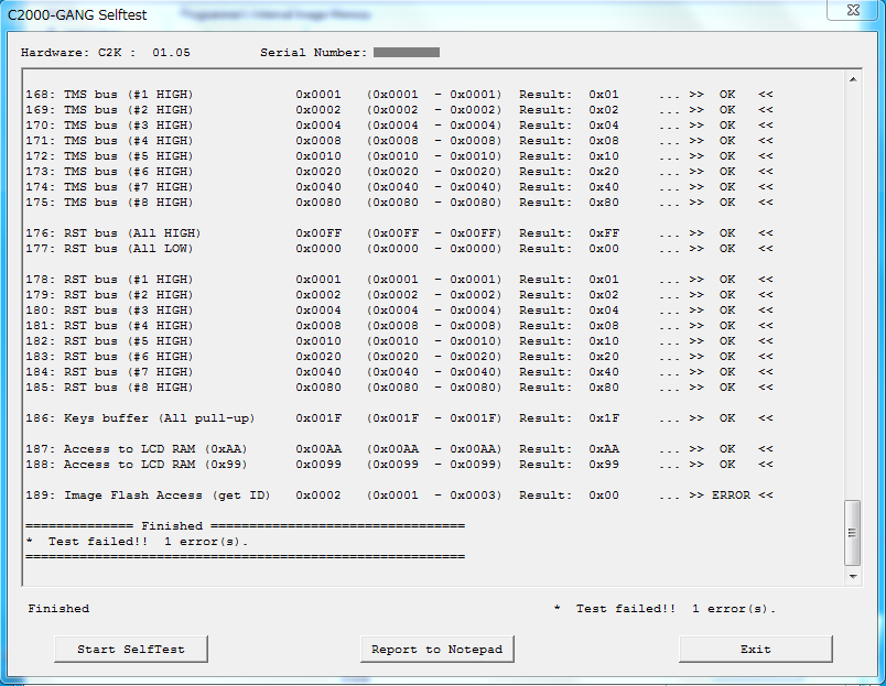

    Please find attached screenshot.
    Here is an additional information.
    Customer run self-test just after connecting C2000-GANG to host PC via USB, and then faced “Image Flash Access Error”.
    They run the self-test again after configuration is done, but the result was the same.
    Please find below screenshot.
    -Shibata

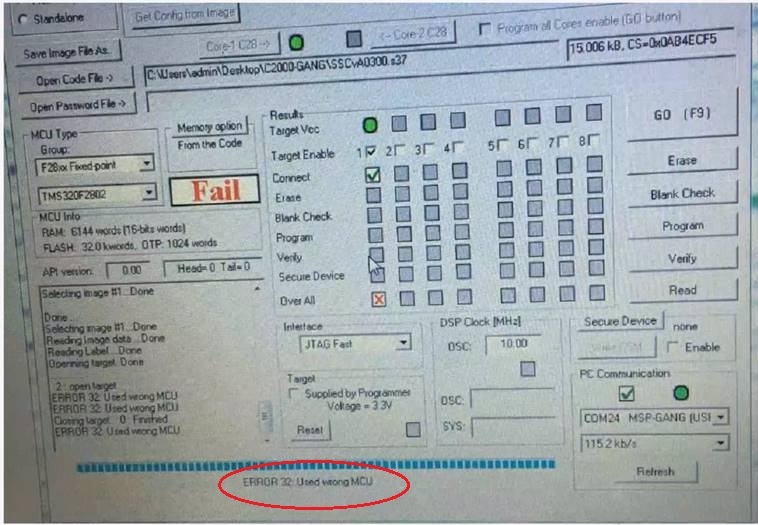

  • Hi Matthew,
    Customer tried it, but “Error 32 used wrong MCU” occurred.
    Could you please double check?
    -Shibata
  • Shibata-san,
    I noticed that in your post you mention the F28022 device, but the title of the thread is F2802.  Can you comment on the correct part number?  If it is helpful we can ask the customer to take a picture of the top of the device and attach the image here.
    I think the original error is still related to the correct/incorrect device being used.
    Matthew

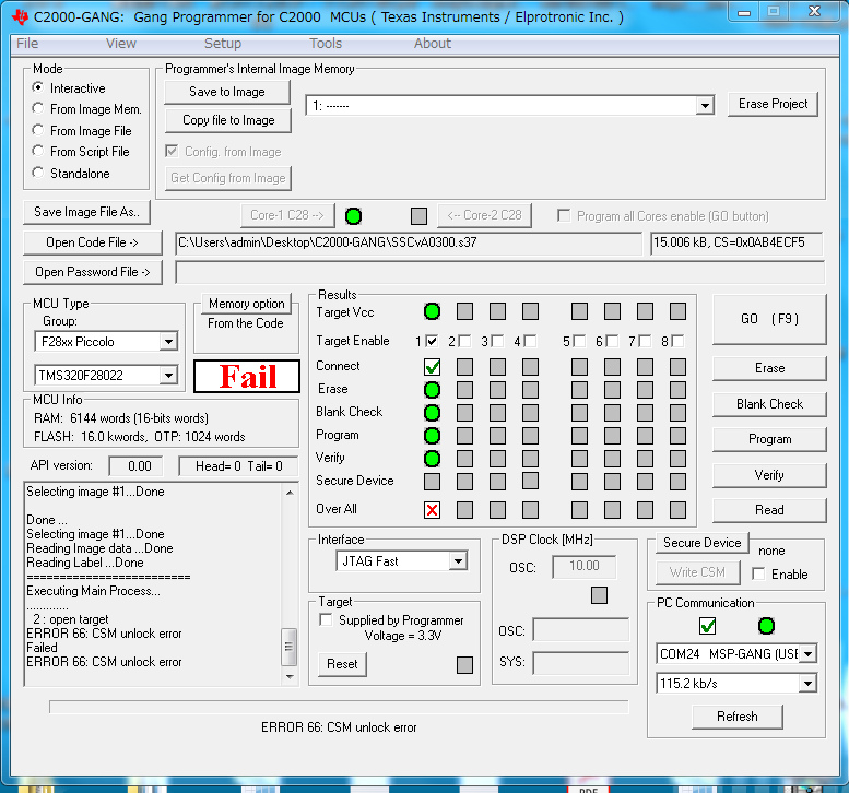

  • Hi Matthew,
    Customer tried following steps:
    - Reverted the MCU type to F28xx Piccolo, TMS320F28022
    - Set boot mode to wait boot
    Even with these changes they got Error 66.
    I will share the screenshot later.
    -Shibata
    P.S. Attached the screenshot.
  • Shibata-san,
    Yes, reverting back to Piccolo, F28022 was the right thing to do.
    Putting the device in Wait Boot mode has helped; this forces the C2000 to not execute code, most importantly code that is in secure memory.  On this device if a JTAG access is attempted while code is executing from a secure region, it will not allow the JTAG to connect.  I believe this was the first error the customer observed.
    Now that we are in wait boot, the device can connect properly but now is giving a failure that indicates that the CSM password is not erased(0xFFFF).  If this is a fresh/new device it should be in the erased state.  If customer has previously programmed the device, and wants to erase/reprogram they will need to provide the CSM password file they used into the C2000GANG GUI as part of the password file.  Once the device is unlocked they can program it as they want.
    Can you comment if customer had previously attempted to program either the password or programmed the flash and it did not complete?

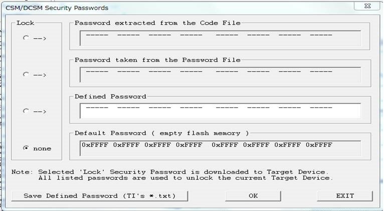

    Please find screenshot for CSM/DCSM Security Passwords below.
    They selected “none” here.
    In that case, Password is not configured, or default password is used?
    How to unlock?
    -Shibata

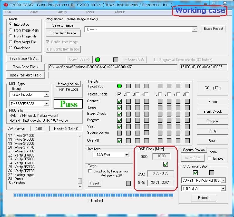

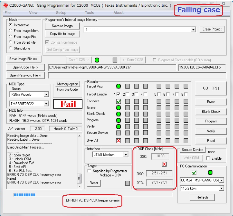

  • Part Number: TMS320F28022
    This is an another issue related to below thread.
    https://e2e.ti.com/support/microcontrollers/c2000/f/171/t/954781
    Customer is trying to program TMS320F28022PTQ mounted on non-socketed board by C2000-GANG.
    In previous thread, customer used socketed board and faced Error 66.
    Now they are facing different issue as follows:
    1. For the 1st time, programing by C2000-GANG can be done without error.
    2. For the 2nd time (using the same board in step 1), Error 70 is reported.
    3. The issue is reproducible with a couple of boards.
    4. When trying to program the board Error 70 is reported in Step2 by different programer (YOKOGAWA), they can program it without error.
    So please let us know:
    - Why this happens in 2nd time with C2000-GANG only?
    - How to resolve this issue?
    Please find below screenshot captured in working case and failing case.
    -Shibata

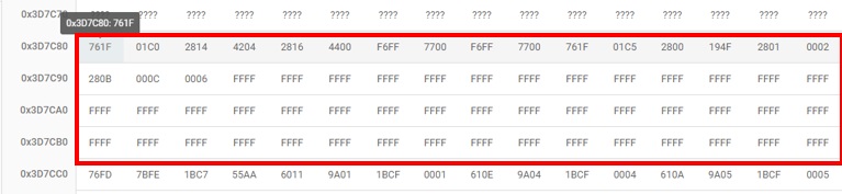

  • Hi Matthew,
    Customer checked the address in 2 TMS320F28022 boards with CCS connection.
    Please find below results.
    Test 1 - Reading address 0x3F7FF8-0x3F7FFF
    Board #1
    Board #2
    Test 2 - Reading address 0x3D7C80-0x3D7C0
    Board #1
     Board #2
    Further updates:
    - Kept Pin19 (GPIO34/COMP2OUT) open
    - Tried to program the TMS320F28022PTQ board from C2000-GANG
    - Result: Both 1st was programming was successful, but the 2nd programming onward failed with ERROR70
    - Connected Pin19 (GPIO34/COMP2OUT) to GND
    - Result: Both 1st and 2nd programming were successful
    Summary:
    - It looks like the ERROR70 issue has been resolved by connecting Pin19 (GPIO34/COMP2OUT) to GND, that means the device is in “wait boot” mode
    - I'm not sure why 1st programing was successful even though the board is NOT in "wait boot" mode?
    - In last month, customer tried “wait boot” mode with socketed board and faced ERROR66. It might be due to another HW issue.
    Please let me know your thought?
    -Shibata
  • Shibata-san,
    Thanks for the update.  I have merged the two threads since they were on similar topics and we can use this one thread to keep up with both issues.
    For the error 70, and data I requested, customer has confirmed that the device is unlocked and all the device cal is correctly in the TI OTP.  I believe that the C2000GANG attempts to calibrate the internal oscillator before programming.
    Since these locations are in OTP, they will be password/CSM protected if the device is locked.  As such it will appear to be all 0x0000s and will trim the internal oscillator incorrectly(hence the message out of the GANG on bad frequency match).
    Wait boot will ensure that no code is executed past a certain point in the BROM and that the CSM never gets triggered.  I suspect on an erased device the code will stall after it attempts to jump to flash, and CSM won't get locked either.  There could be some portion of the customer code that activates the CSM, even if there is no password programmed.  In this case a read of the password locations would unlock it, but I am not sure the C2000 GANG does this.
    For the other error, I think there is another scenario if customer code is executing from a secure region and CSM is activated.  On these devices, if JTAG attempts to connected(or is already connected) and the CSM is active it will not allow(or terminate) the JTAG connection entirely.  Wait Boot should fix that as well, however, so I'm at a loss to explain why this doesn't solve all issues.
    Has customer had a chance to look at those devices with a different error code?
    Matthew

  • Shibata-san,
    When flash is erased, and the boot mode is set to boot from flash the device will still attempt to run from flash.  Since erased state is 0xFFFF, executing this code will generate an ITRAP1 (Illegal instruction), and jump to that ISR.  I assume at this point it will be the default ISR which is in bootROM so the device will be executing from non-secure memory.
    I will ask Elprotronic about possibility of adding the error codes to the docs.
    Matthew
