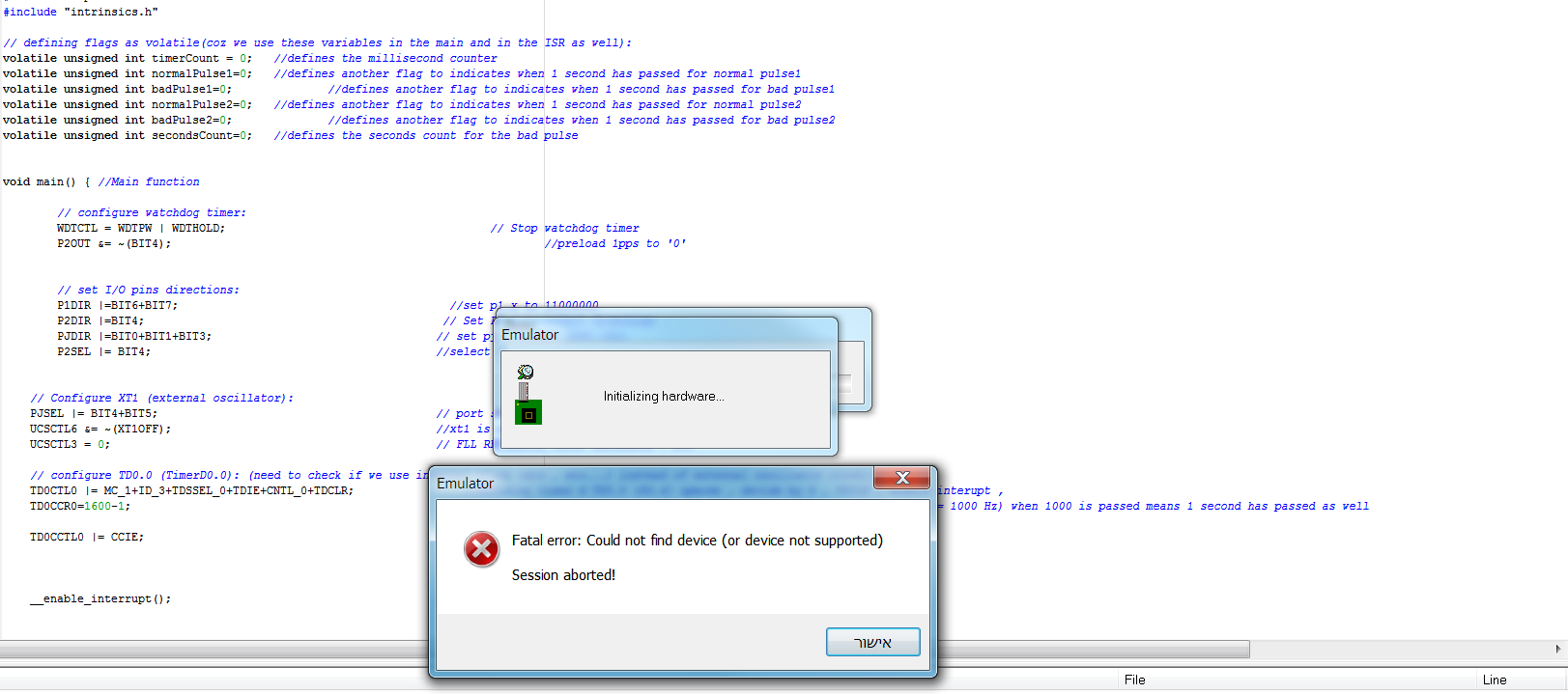

  • I'm having the same issue ant havn't found any solution yet . ill explain a little :
    I'm using MSP430F5131 and trying to program it by IAR Embedded Workbench while using the MSP-FET debugger.
    A short background of the PCB:
    After i compiled the code in IAR with not errors found , i connected the MSP-FET to the MSP430 in a Spi-Bi-Wire connection according to the datasheet.
    The MSP430 is placed in a PCB which includes 12V input voltage and 2 regulators of 5V and 3.3V . The MSP430 I/O's are connected according to the datasheet (including external pullup resistors and capacitors) along with the Spi-Bi-Wire connections.
    I energized the PCB with a 12V supply voltage , connected the MSP-FET's connector to a Header connector on the PCB and the other side connected to the PC by USB.
    My problem is :
    In the IAR , once i try to download the code into the MSP430 (by clicking the 'Download and Debug' button) it says that it needs a firmware update , so i clicked ok and download the new update , but when it tries to initialize hardware i encounter the error :
    "Fatal error: Could not find device (or device not supported)
    Session aborted!"
    I have tried multiple things in order to find the solution - with no success .
    Does the AVcc and AVss needs to be connected even if i dont use any analog options? coz its not connected to anything.
    I also tried to download the program to the MSP430 with code composer studio but encounter the same error.
     I connected the MSP-FET to the MCU that way :
    - RST/NMI/SBWTDIO of the MCU to TDO/TDI pin 1 of the MSP-FET.
    - TEST/SBWTCK of the MCU to TCK pin 7 of the MSP-FET.
    - a 3.3V that is supplied from a regulator in the PCB to VCC_TOOL pin 2 of the MSP-FET.
    - GND of the PCB to GND pin 9 of the MSP-FET.
    Here's the picture of the error i get:
    thanks.
  • AVCC and AVSS are internally connected to DVCC and DVSS through some clamp diodes. This is why they are allowed to differ a few mV from the digital supply. Or are indirectly supplied. However, even if you don't use any analog circuitry of your MSP (I'm not sure whether the SVS applies to this too), you should connect them to DVCC and DVSS. If you use the analog modules, then you should route AVSS separately form DVSS to a comon GND point, and put at least a simple R/C filter between DVCC and AVCC, so digital current (on DVSS) and voltage (on DVCC) ripple doesn't negatively affect the analog performance.
    Regarding your JTAG problen, be sure to have short wires and low capacitance on the SBW signal lines. Including parasitic capacitances etc.
    IIRC, the spec lists a maximum capacitance of ~2nF. The SBW signals are very sensitive to anyhting that can result in a low-pass filter.
    I'm not sure whether the VCC_TOOL pin is the right one. Double-check the specs. There are two pins, one supplies the PCB form the FET, one senses the PCB VCC to adjust the FET signal levels.
  • Does AVcc and AVss needs to be connected permanently to DVcc and DVss? or just for the programing process?
  • for programming, it can be left unconnected. But for operation, it should be.
    As I said, there's some sort of internal emergency supply. So if you really don't use any analog functions, it won't kill the MSP if they are left unconnected. But why not connecting them? On most MSPs, the pins are close enough for a direct connection without making the layout more complex.
  • The problem actually occur when i try to program the MSP , but i guess it's coz the MSP doesn't get the amount of voltage it needs (at least 1.8V) the regulator somehow supplies only 0.7V instead of 3.3V...I guess that's the problem when i try to program it.
    thank you i'll connect them anyway.
  • Double-check the required programming voltage.
    1x family, for example, works from 1.8V to 3.6V, but for programming, at least 2.7V are required.
    And 0.7V is of course way too low in any case.
    In Addition, the FET-UIF JTAG connector has two signal pins. One provides the (configuratble) output voltage of the FET, which can be used to power the device during programming/debugging. The other one senses the existing supply voltage of the target and adjusts the JTAG signals accordingly. Exactly one of them must be connected to VCC, the other one must be left unconnected.
    If you do not connect the sensing pin (so 0V are sensed), the FET assumes that the target is powered by the FET and the JTAG signals have the same level. If you also did not connect the supply pin, then this assumption is most likely false.
    So if the FET is providing 3V and the sense pin is not connected, then the FET will expect 3V signals form teh MSP (and will send 3V signals). If the MSP runs on 1.8V, the JTAG signals from the MSP won't be recognized by the FET. While the FET's JTAG signals will apply a much too high voltage to the MSP pins. It is possible that the 0.7V you see are injected by the FET into the unpowered MSP's JTAG pins. (IIRC, there's a series resistor of 1K on the signals for current limiting, so this won't fry your JTAG pins)
    If you connect both, you'll get a back coupling and the resulting signal voltage is unknown (including oscillation).
