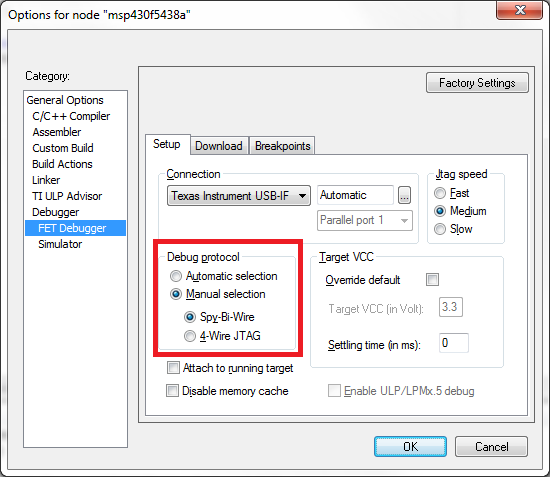

    Could you please check your IAR Debug Options??
    I'm getting the same error as you did (Fatal error: Could not find device) if I select the Spy-Bi-wire as the debug protocol. So please make sure you select 4-Wire or Manual Selection.
    If this is configured correctly, could you please download/install FET-Pro430 and see if you can read the firmware on you FET tool (go to Tools > Read MSP-FET430UIF) , this might us an idea on where the problem is.

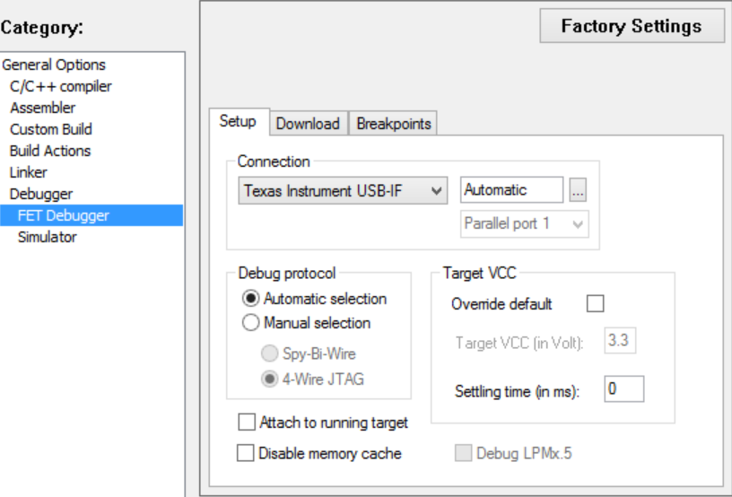

  • Thanks for the reply,
    I'm on automatic mode, I'll also attach a picture of it so you can see other configurations
