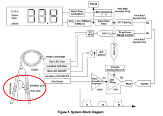

    actually I saw another document, https://www.ti.com/lit/pdf/SLAA274 (A Single-Chip Pulsoximeter Design Using the MSP430)
    in that document I can also see red led and infrared led. but I cannot see these 2 leds in SLAAE24 document.
    do not these 2 leds need for this new solution? or we have to make other PCB for the pictures below?
    and if it do not need and only need one photo diode, could you explain why do not need these 2 leds anymore?

  • Hi Chase,
    We need 2*LED(IR + RED) and 1 Photodiode.
