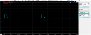

    I 'am probing the oscilloscope at to current setting Resistor of RED LED and at the cathode of the photodiode.

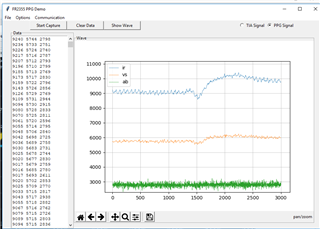

    I'm using the GUI provide by TI with the application note to view the PPG signal.
    This is the oscilloscope View and the corresponding PPG signal.
    Sometimes I get a very clear signal on the GUI and sometimes the signal is too distorted or just noise.
    The Application note is followed as it is. As you suggested it might be communication issue with MSP430 and PC, it can be a possibility. But even when I am not using communication between PC and controller and simply trying to compute SPO2 and Heart Rate the Computed results are neither consistent nor correct.

  • Irrespective of the  signal displayed on the GUI. The signals on the Oscilloscope remains similar. I cannot read the exact voltage levels because its a function of time. But the waveform looks similar every time.
    It's a possibility. If you move the wires does it introduce any visible noise?
    Yeah moving the wires also change the visible PPG signal.

  • Hi S. Iqra,
    If the scope output is stable but the GUI is not then I suspect the issue is somewhere between the PC and the MPS430. Can you confirm: you are not using the debugger when this issue is happening?

    I can even observe something strange on the readings on the oscilloscope.
    The waveform used to drive the LED. ( Its set to 500mV in the code by me).
    But for some readings it has a different value and for others it has some other value.
    LED Driving Waveform.
    Observed Voltage levels.
    70mV
    300mV
    150mV
     Although the PPG wave was independent of this variation as well.

  • Thanks for the detailed response.
    I'm not surprised that some of the LED driving waveforms are different from each other. If you read section 5.1 of the guide there are provisions for the LED drive strength to be modulated.
    We still have not determined any correlation between signals we are observing on the HW and the "bad" GUI readings which is making it difficult to determine where we need to focus our debug efforts. Do you have any thoughts on what configurations are causing "bad" readings? Is the setup changing at all? Is the finger clip always clips to the same finger in the same way?
