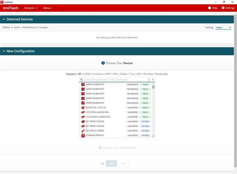

when I try to connect the MSP-FET to program the MSP430F2617 chip, Uniflash shows me the message "No debug probes/devices detected", both in Auto and Manual setting.
I tried with different cables but the connection still doesn't work.
The drivers are updated, and I can also see 'MSP Application UART1' and "MSP Debug Interface" device in device manager.

Can you provide a screen shot of the error message?
Hello Dennis,
thank you for your reply. Yes, I am able to connect the debugger to CCS and it works.
The version of Uniflash I am using is updated to the 6.4.

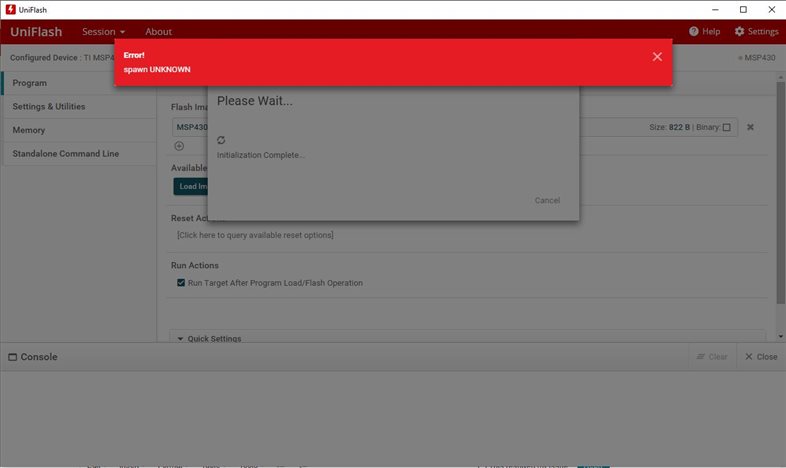

Here is a screenshot of what it shows me everytime I try to program with Uniflash.
Even if I try to add manually the .ccxml file I cannot flash the image during the second step and here is the message I see.

OS is win10 32 bit.
This is the issue.
CCS 8.1 is supported on Win32.
UniFlash 6.4 is not. It only supports 64-bit Windows.
The last version of UniFlash to support 32-bit Windows is UniFlash 4.6:
http://software-dl.ti.com/ccs/esd/uniflash/docs/release_archive.html#uniflash-v4-releases
ki
Thank you,
I installed the older version 4.6 and now Uniflash correctly identify the FET.
