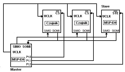

mSP430F2618 spi OR uart?
Other Parts Discussed in Thread: MSP430F2618
In MSP430F2618 mixed signal DS pins:
P3.4/UCA0TXD/ UCA0SIMO
P3.5/UCA0RXD/ UCA0SOMI
have same PxSEL configuration that is P3SEL = 1 for both the pins for both UCA0TXD/ UCA0SIMO where we can configure for UART and SPI.
i have clock and SPI init functions are below setted for 9600 baud rate:
int main(void)
volatile unsigned int i;
WDTCTL = WDTPW+WDTHOLD; // Stop watchdog timer
if (CALBC1_8MHZ ==0xFF || CALBC1_8MHZ == 0xFF)
while(1); // If calibration constants erased
// do not load, trap CPU!!
BCSCTL1 = CALBC1_8MHZ; // Set DCO to 8MHz
DCOCTL = CALBC1_8MHZ;
P1SEL |= 0x00;
P1DIR |= 0x20;
P3SEL |= 0x31;
P3DIR |= 0x01;
P3DIR |= 0x10;
P3DIR &= ~0x20;
//Slave SEL pin P4.4
//// P4SEL &= ~0x10;
UCA0CTL1 |= UCSWRST; // **Put state machine in reset**
UCA0CTL0 |= (UCMST+UCSYNC+UCMSB); // 3-pin, 8-bit SPI master
// Clock polarity high, MSB
UCA0CTL1 |= UCSSEL_2; // SMCLK
UCA0BR0 = 20; // /2 change to /1
UCA0BR1 = 0; //
UCA0MCTL = 0;
UCA0CTL1 &= ~UCSWRST;
IE2 |= UCA0RXIE + UCA0TXIE;
UCA0TXBUF = 0x21;
_BIS_SR(GIE); // Enter LPM4, enable interrupts
// Echo character
#pragma vector=USCIAB0RX_VECTOR
__interrupt void USCIA0RX_ISR (void)
while (!(IFG2 & UCA0RXIFG)); // USCI_A0 TX buffer ready?
UCA0TXBUF = UCA0RXBUF;
but my code is not working... i want to configure for SPI how to do? is the baud rate setting fine?
Regards.
    in this moment your microcontroler finish executing code  :)
    set   while(1);
    or   some LPM mode for example lpm0
    ( not lpm3 and lmp4 because you use SMCLK)

  • connection should be like on picture below:
    (check your connection MSP430 - slave chip )
    example for 1 master 3 slaves
  • Hi Lukasz,
    It is same way connected
