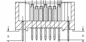

Can the MSP-EXP432P401R Launchpad be used to program/debug board that I am designing with an MPS432P401R (XMS432P401R) processor?
Need to get 1.27mm pin header from Digi-key: 1212-1331-ND & mate with example S9008E-07-ND
Pretty hard to solder and not creating solder-shorts.
Spend the $10 and get a dedicated j-link sw programmer
http://www.ebay.com/itm/1pcs-J-Link-OB-ARM-Debugger-Programmer-Downloader-replace-v8-SWD-M74-/351235114957?pt=LH_DefaultDomain_0&hash=item51c73e87cd
You would have to cut the support pins.
