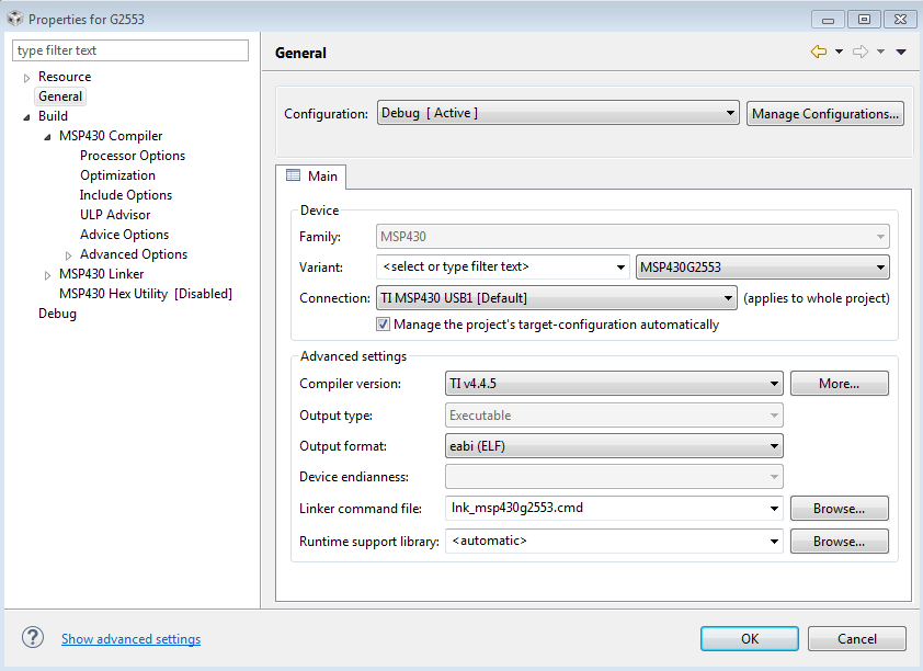

And here is a screenshot from my properties window with a running G2553 project on the G2 LaunchPad:

Karim, your one works here. I created a new project and inserted your code - could you try if you get the same error message with the project I created. Then it has nothing do with those settings.
Again;
The LaunchPad is not using the ‘MSP-FET430UIF’ and CCS is not using any COM port to communicate with your LaunchPad.
It looks like you have selected the wrong Target Configuration or misconfigure the Target Configuration.
Verify you are using the right USBn (1, 2 or 3).
Selecting a MCU doesn’t implicit selects the correct Target or Debug Configuration.
Go to “View\Target Configurations” open the folder of your Project and the folder “targetConfigs”.
To be sure right click the “…G2…” ccxml and select ‘Set as Default’.
Double-click the configuration and check in both Tab’s (Basic and Advanced) if everything is correct, and press Save.
Click on the Arrow down right next to the Debug icon and select the correct Debug Configuration.
If still a problem you can also select from the drop down ‘Debug Configurations…’ and modify the Debug Settings or create a new one.
