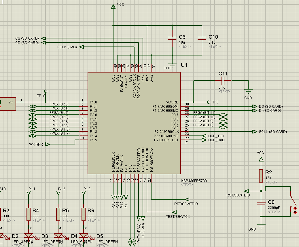

I have designed a custom PCB with the MSP430FR5739 as the core microcontroller. My design is with respect to the design specifications on the MSP-EXP430FR5739 schematic, and I have been trying to program my custom PCB with the emulator of the MSP-EXP430FR5739 experiential board, but everytime I try to load a simple program like switching on 2 led's I get an error from the code composer studio such as this:
[ MSP430: Error connecting to the target: Could not find device (or device not supported) ]
I am able to program the experimental board (MSP-EXP430FR5739) on it's own, meaning that works well, but I can't use that emulator to program my custom PCB.
I have connected the SBW (Spy-Bi-Wire) configuration from the experimental board emulator (TEST, RST, GND & Vcc) to the custom PCB (MSP430FR5739) corresponding pins, yet I still encounter the same error message on my CCSv6.1.1.
I've verified that the power going into the custom PCB is: 3.56V on Vcc and 1.48V on VCore. Likewise, the only differences I can see between my schematic for my custom PCB, and experimenter board (MSP-EXP430FR5739) are slightly different capacitance values on VCore. I have a  0.1u capacitor on VCore instead of 470n on the experimenter board. Otherwise, as far as I can tell the schematics are the same.
Could someone assist me regarding this? is there something that I'm missing on this matter?

  • Hi Ryan,
    Thanks, for the advice I might have overlooked the capacitance value of VCore, I'll change it and get back to you, The decoupling capacitance values for  DVcc & AVcc are kept as 10uF + 100nF, on RST line I've used a 47kOhm resistor as the pull up resistor and a 2.2nF pull-down capacitor.
    My question to you is, should I change the pull-down capacitor to 10nF as you have stated, because I cannot see it specified on the datasheet?! I will also find a 3V power supply in my workshop and apply the recommendations you have mention, and get back to you with my results.
    Please also find attached the screenshot of my schematic diagram for further help.
    Lubabalo

  • Hello Lubabalo,
    2.2 nF is fine and is even what's recommended on the MSP-TS430RHA40A target board. The AVcc & DVcc pins are recommended to each have 10 uF + 100 nF, not a shared capacitance, although this is less critical than the Vcore capacitance and operating voltage level. Please keep me updated after making the changes.

  • Hi Lubabalo,
    Please also post a clip picture of debugger port circuit. I want to check the debugger connection.
