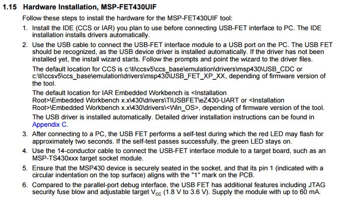

  • Hi Vinay,
    Here is the MSP430 Hardware Tools User Guide: http://www.ti.com/lit/ug/slau278y/slau278y.pdf
    Below is a snippet of the hardware installation for the MSP-FET430UIF. Please go through the steps and let me know if you continue to have issues and if so, at which step.
    Also if you could attach the word document that you collected screenshots in, that would be helpful. Thank you.
    Akash Patel

  • Dear Akash,
    The point where i am stuck is 3. The red light DOES NOT glow. It was glowing a week ago when everything was working perfectly. Unfortunately , nothing now.
    regards,
    Vinay
