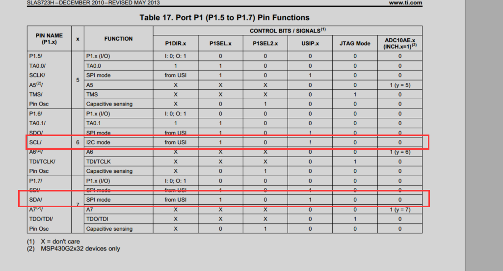

I'm using MSP430G2102, In the CCS example msp430g2xx2_usi_09.c, the IO configuration is:
P1OUT = 0xC0; // P1.6 & P1.7 Pullups
P1REN |= 0xC0; // P1.6 & P1.7 Pullups
I don't find the example configure the P1SEL and P1SEL2 registers, but In datasheet, I find that:
Should I configure the  P1SEL and P1SEL2 registers?
I also find the MSP430x2xx Family User‘s Guide says that:
'On some I/O ports on the MSP430F261x and MSP430F2416/7/8/9, enabling the
pullup/pulldown resistor (PxREN = 1) while the module function is selected (PxSEL = 1) does
not disable the logic output driver. This combination is not recommended and may result in
unwanted current flow through the internal resistor. See the device-specific data sheet pin
schematics for more information. '
This passage doesn't mention the MSP430G2102, is this means MSP430G2102 can set PxSEL = 1 while enabled Pullups?
If there are pull-up registers outside, Can I disable the internal pull-up registers?
Thanks!
  • Hi Qiuhu,
    When the UIPEx bits are set in the USICTL0 register, the appropriate P1SELx settings are automatically generated. This is can be seen in Section 14.2.1 of the user's guide. You can also use external pull-up resistors and disable the internal resistors if you desire.
