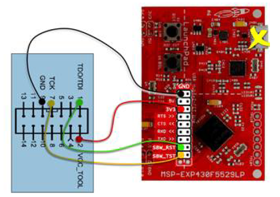

I have been using "MSP-FET stand alone debug probe" since few months. It was working fine till now. Since yesterday I am getting this error:
"error: MSP430: Error connecting to the target: Unknown device"
After getting this error I tried to code a different board (MSP430FR6989 Launchpad), and I am still getting the same error. So I am guessing there is some trouble with the debugger.
Does anyone know what could be the problem ?
Connections are as follows:
Hello Aditi,
Which IDE are you using for programming IAR/CCS... In IAR you have option of Automatic/Manual selection.. If it is manual select Spi-bi interface as your connections are for the same.. rest connections looks ok and it might be hardware fault..
regards,
Vikas Chola
Yes. I already did that. So as of now,the problem is solved.
However, I want to know that what exactly went wrong, so that similar mistakes could be avoided in the future.
