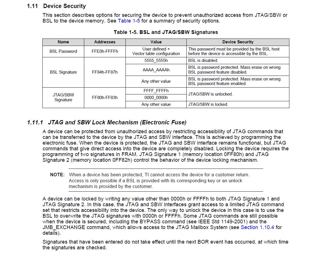

 We are having customized MSP430FR5994 board for our application. While debugging/programming we’re facing severe error i.e. “debug interface secured”
Once the error popped up on debug window we are unable to program/debug the customized board.
 If we are replacing the Microcontroller (MSP430FR5994) on customized board the error got resolved and it will allow us to program/debug for several times. Again, after executing the program/debug cycles few times the replaced Microcontroller also goes in to same secured mode and the pop up window with error “debug interface secured” display on debugger.
To overcome the above error, we gone through few forum post and tried to follow below process using document, Ref slau319s we given a pulse from a function generator as suggested in point 1.3.1 To enter in BSL mode.
After following above process, we observed that the Microcontroller goes in to “Unknow device” rather than “debug interface securedWe observed the similar behavior using Code composer studio & MSP flasher command line tool.
Below are the FRAM memory details used by our application and we have also added protection in software to do not write on “JTAGSIGNATURE” section.

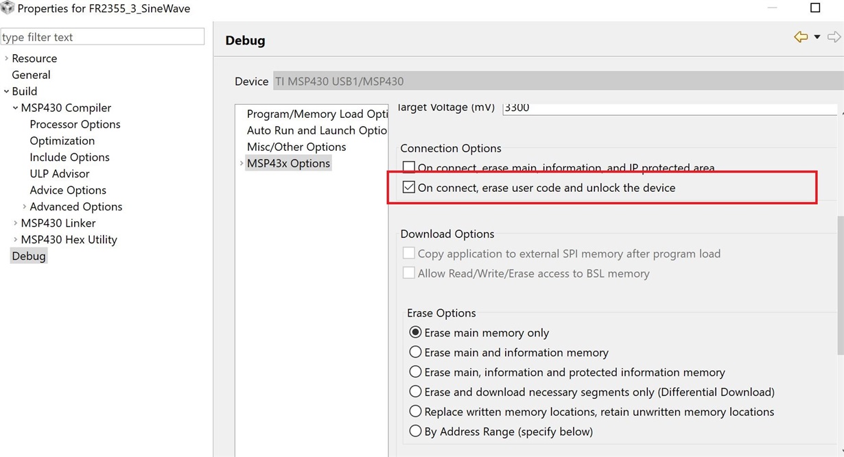

    It seems that your electronic security fuse was blew. You can try "On connect, erase user code and unlock the device" option. This option will erase JTAG Signature and unlock the secured state.

    USER_CODE_ERASE (0x1A1A) is working only on FR4xx devices, not on FR5xx/6xx. First unchecked box on Connection options is related to FR5xx/6xx (MAIN_ERASE 0x1A1A, TOTAL_ERASE 0x1B1B), but it is working only if JTAG fuse is not blown.
    For unlocking FR5xx/6xx devices, I am using BSL that will do mass erase (back to factory state).
