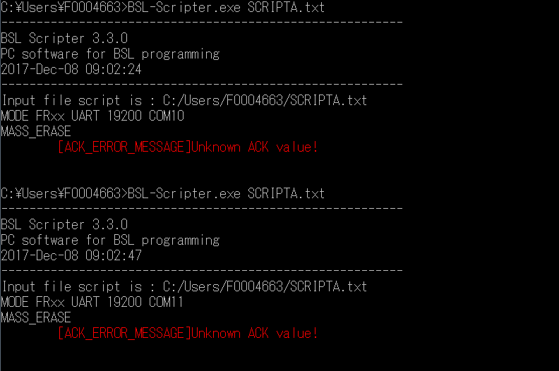

Im using the launchpad of MSP430FR5994 and after using it to write and debug code for several days, an erroroccured during debugging saying "The Debug Interface to the device has been secured" and I am no longer able to able debug any code.
I tried mass erase through BSL Scripter but I keep getting [ACK_ERROR_MESSAGE]. Ive attached a screnshot of the same.
Are there any other ways of getting rid of this debug interface error?
  • Shaaina,
    The debug error you receive means you have locked the JTAG on the device. A mass erase of the device via BSL, should unlock the JTAG, and you are correct in thinking that a wrong password should erase the device. The Unknown ACK Value error messages typically indicate that you are not getting good/correct communication with the BSL. Please check your COM Port to make sure you are talking to the correct one for the MSP430. I would also check that the jumpers at the top-center of the Launchpad are populated.
    You can also modify the BSL script for this device to do a MASS ERASE command explicitly.
  • JH,
    Thanks for your reply.
    I rechecked my COMports and tried the MASS_ERASE command, but still no avail. It shows the same unknown ACK value error. I even tried the script on both the MSP Debug Interface COM port and the Application UART COM port, just to be sure. Also, 19200 was the baud rate i was using to do serial communication with the board before the JATG stopped responding. The  jumpers at the top-center of the Launchpad are populated. I've attached a screenshot of the COM ports and the BSL Script. Am I doing something wrong in this process? Is there any other way to unlock the JTAG?

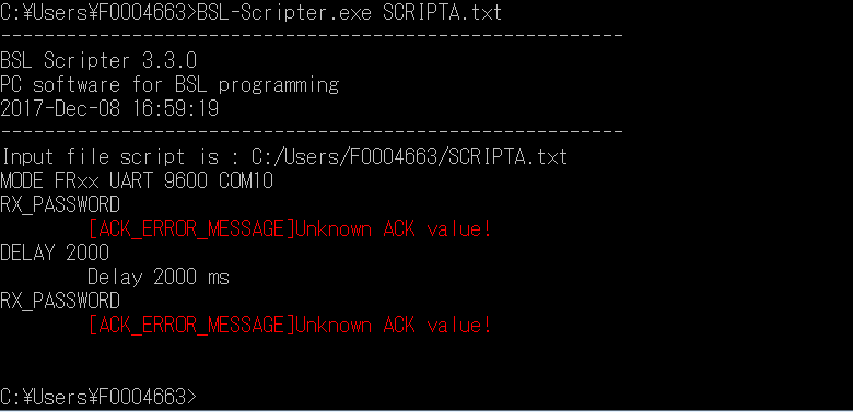

  • Hi Shaaina,
    the Mass erase and wrong password in FR5994 shall return the [ACK_ERROR_MESSAGE]Unknown ACK value, as on the device, the execution does not reply anything. that's why we need to add delay. But I wonder why it still gives you the same result for the next RX_PASSWORD with correct one. assume that your device is empty, can you try these steps:
    MODE FRxx UART COM<number> 9600
    RX_PASSWORD
    DELAY 2000
    RX_PASSWORD
    Let me know the result. we just try to use the default password.
  • Hi Fatmawati,
    Thankyou for your reply.

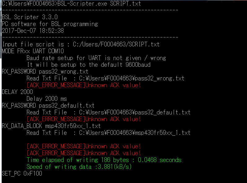

    I entered delay for the MASS_ERASE command and also tried the steps you suggested. The JTAG on my launchpad still appears to be secured. I am attaching the results.

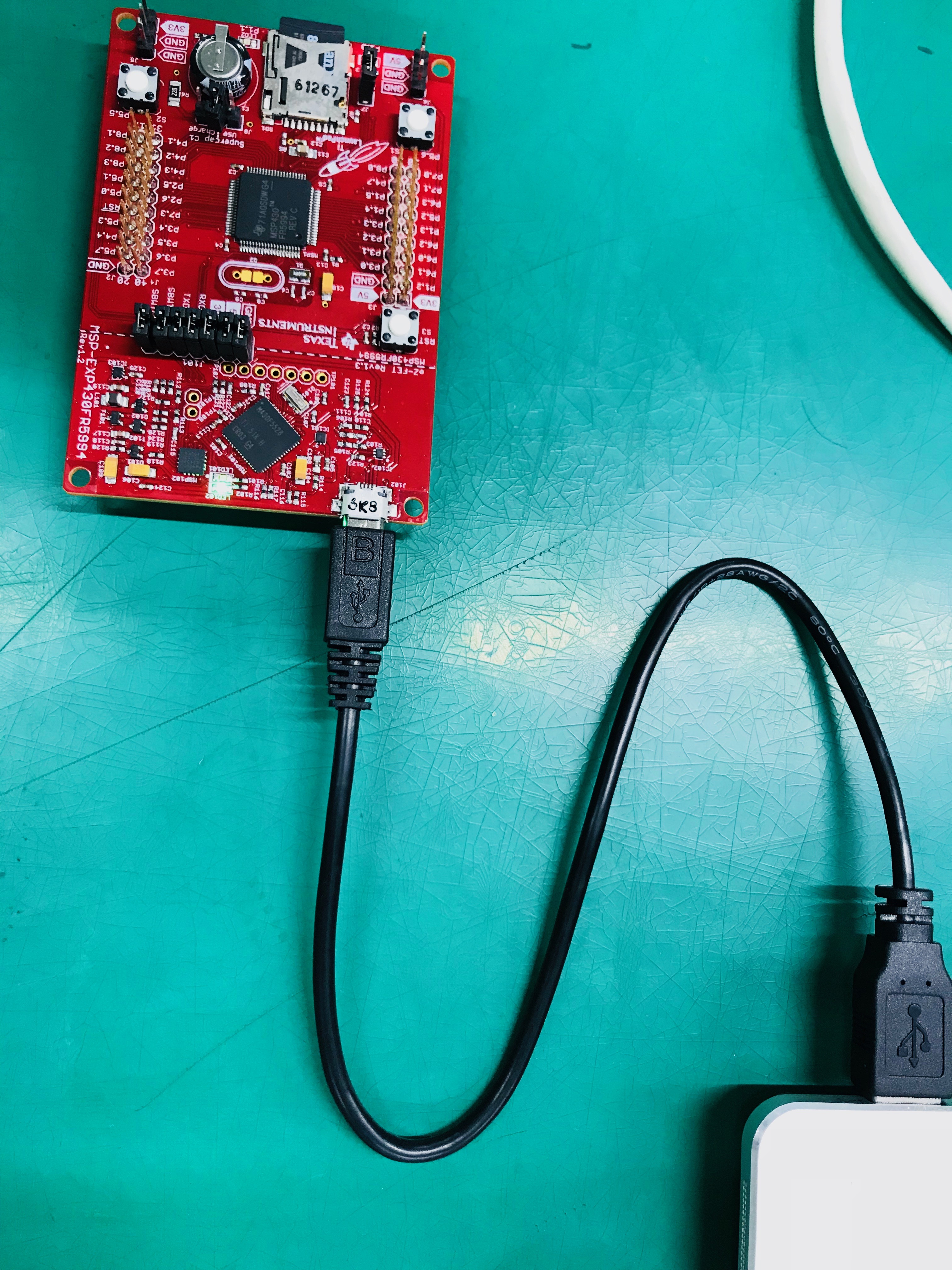

    As I understand, the BSL pins are accessible through the miniUSB (J102) on the launchpad.  I hope I am correct.  I am using the eZ-FET board which is attached to the launchpad through jumper pins. Hence I have a USB connection between the launchpad and my PC.
    Am I supposed to use a different type of connection between my launchpad and PC?
