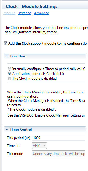

Our customer is seeing a timing inaccuracy with the MSP432 and the TI-RTOS.  (Posting in this Forum since the TI-RTOS Forum is READ ONLY)
It looks like based on digging through the TI-RTOS docs ,that the 32KHz clock is being setup with a period of 32 for the tick timer.  However when I create a clock on top of that that fires ever 100 ticks.  I get a routine delay of 97.5 ms.  When I set the timer to 1000 ticks I get a delay of 974 ms.  So it looks like the clocks are not being setup properly, although it looks like they are, but the system is not keeping time properly.
Per Scott, what we are observing is a limitation of trying to get a clean 1 msec tick from a clock source running at 32768Hz.  To get a precise 1 msec tick would require programming the timer to generate an interrupt on every 32.768 counts.  But the timer only supports programming integer counts so the 32.768 gets truncated to 32.  (By convention, if we can’t get the precise tick rate we will interrupt early rather than late.)  So every tick will occur at 32/32768 = 0.9765625 msec.    So for 100 consecutive ticks the overall delay will be ~97.7 msec;  for 1000 it will be 977 msec, etc.  The numbers we report above don’t match exactly but this may have to do with measurement accuracy.  We suggested other ways to handle this;  reducing the tick rate, using a different timer such as SYSTICK, calculating the total # of ticks to wait a particular delay and/or using a suppression feature which might be a little more complicated.
However, much to no avail, we need further insight.  There does not appear to be anything to change the clock source directly.  Everything seems to direct to create a user based timer and call Clock_tick by the user.  However that isn’t working either because when it is configured to use a user timer according to instructions - a build error results that ti_sysbios_family_arm_msp432_ClockFreqs_setFrequency_E is missing or uninitialized.
 ti_sysbios_family_arm_msp432_ClockFreqs_setFrequency_E --- can’t figure out where this is referenced, or get an idea of what it should be set to.  We find it hard to believe that you can’t change the clock source for the tick timer somewhere.  Probably just not finding it readily available.  Finding references that it is not possible and to do it another way.  Which apparently is blocked or not clearly enough documented to figure it out quickly.
When using SMCLK for a timer that is created, it should be 12 MHz according to the spec.  which should have a nice easy division to a 1ms timing but it results in ~994 usec.  Which doesn’t make sense if the system is running off the 48 MHz crystal divided down.  It seems to have some slop too so the worry is that it is off a PLL from the 32KHz crystal.  Which would not be the desire for the system configured--- but I can’t figure out where that is configured either.  It is buried so deep in indirect links within the BIOS it seems tough to get there.
    Can you describe what you did to get this error?

  • Scott,
    They get that error code after they change the settings for the clock module for the application code to call Clock_tick as was instructed in several WIKI on the TI website to get a more stable clock.
    SMCLK is configured by the defaults of the boot power module.  But they have not made any changes, nor can find documentation to figure out where to make changes.  There are a lot of buttons for configuration items that don’t seem to go anywhere.  It has been somewhat frustrating for them.

  • Chris,
    Where did you get that screen shot of the Clock module configuration?  It mismatches what I would expect for the SDK you indicate.  Is that from a wiki page or are you seeing this in your install?  I tried to recreate the build error reported but am still not clear on what exact steps led to this.  It would help if you can send me the .cfg file for the case where the ClockFreqs build error was thrown.
    Also, are you using MSP432P4111 as implied in your latest post, or MSP432P401R as in the thread subject?  I ask because the Boot module for MSP432P4111 does not have support for initializing clocks at boot. (The Boot module for MSP432P401R does.  There are reasons for this difference that I won’t detail now.)  For MSP432P4111 there is support for configuring clocks in the Power driver.  If you want to use the Power driver to configure this you will need to create a custom performance level.
    You can find some documentation for creating custom performance levels by opening the Driver API descriptions: open tidriverAPIs.html, it should be in the install at this location: C:\ti\simplelink_msp432p4_sdk_2_20_00_12\docs\tidrivers\tidriverAPIs.html.   Click on the PowerMSP432.h header file, then on the PowerMSP432_PerfLevel structure.  The page this opens describes the elements of a performance level structure, and shows an example of defining a couple of custom perf level structures to the board file.  To have SMCLK source off of the HF crystal you need to specify  “.SELS = CS_HFXTCLK_SELECT” as shown in myPerfLevels[0].
