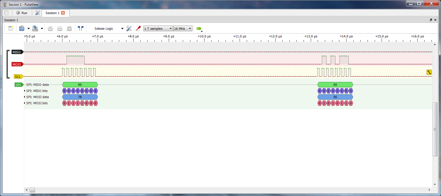

  • So I have attached a screenshot of the SPI communication.  It seems that both 0x78 and 0x56 do get sent by the master.  The protocol is to send the MSB first.
    I run the setup as follows:
    1. I start the IDE in debugging mode for the STM32
    2. I start CCS Studio IDE for the MSP432
    3. I continuously run both boards through the IDE
    4. I set a breakpoint on the master after sending the initial command bytes
    5. I set a breakpoint in the MSP432 in the SPI receive interrupt
    6. The SPI communication does not initiate until I press a pushbutton.  When I do so, I see the attached traces on my logic analyzer.  In the CCS IDE, I only seem to receive 0x56 but not 0x78 even though the logic analyzer shows that this was sent.
  • This is useful, since it shows that the 0x56 is sent second, which lines up the symptoms.
    Your slave is being overrun. The trace shows about 7usec between the bytes. Your MSP432 (MCLK) is running at about 3MHz, so that's 21 clocks, not nearly enough to execute that ISR.
    I suggest you speed up the slave clock (MCLK).

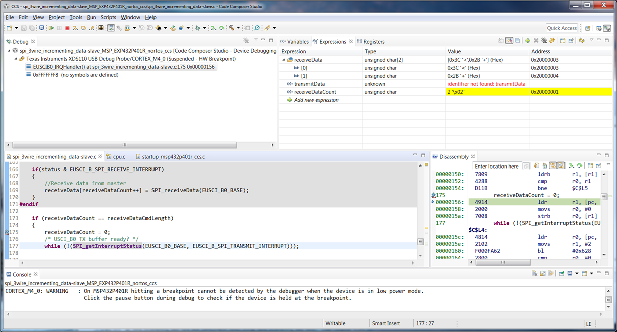

  • So interestingly, this did work.  I put a breakpoint on the "receiveDataCount = 0" line.  So my question is why doesn't the sample provided by TI work?  Is it that the main clock of the master SPI device is too fast for the original ISR as provided by TI?
    Do you think this has anything to do with low power modes?
    Actually, running this multiple times. I notice that sometimes the MSP432 does not receive the bytes properly.  For example, look at the screenshot:

    Yeah, I tried temporarily removing the LPM0 line and did not see a difference in behavior.
    Any insight as to why I do not always get the same behavior (refer to the screenshot in my previous post). Sometimes I get 0x56 and 0x78, but other times these become 0x2B and 0x3C.
    Could this have to do with improper reads as a result of clock speeds?

    So a few questions:
    1. Why was the RX IFG still high?
    2. Should I set this bit low when disabling the interrupt enable, or is the fact that it's high a sign that there is something going on?
    As a point of reference, I set a breakpoint on the master code after sending the acknowledgement bytes, preventing it from transmitting anything on the MOSI line.
    Mehdi
  • The RXIFG is set independent of whether the RXIE is set. The RXIE just says whether a CPU (NVIC) interrupt happens. RXIFG (and TXIFG) is set for every byte in the transaction, even if you (the human) view any particular byte as "transmitted" or "received".
    A simple answer to your immediate question is to mimic the original code and work with only the enabled IFGs, which is pretty cheap:
    > status = EUSCI_B0->IFG & EUSCI_B0->IE; // Enabled interrupt flags
    > if (status & EUSCI_B_IFG_RXIFG) // Received?
    More generally: TXIFG/RXIFG remain set until you do something with them. The TXIFG behaves intuitively with turning the TXIE off and on, but the RXIFG is prone to becoming stale. This is complicated by the asynchronous (as seen by the slave) nature of the SPI. It might be possible to design the protocol so that you can always just clear RXIFG when you set RXIE. My first temptation would be to leave the RXIE on all the time and just (read and) throw away RXBUF if I'm not interested in it, just to keep track of the RXIFGs.
    Unsolicited: In
    > else if(EUSCI_B0->IFG & EUSCI_B_IFG_TXIFG0)
    > while (!(SPI_getInterruptStatus(EUSCI_B0_BASE, EUSCI_B_SPI_TRANSMIT_INTERRUPT)));
    The while() is completely superfluous, since that's what the if() just tested.
    Even more generally: You're introducing new library calls into this ISR, when the library calls were (apparently) what was slowing it down before. I didn't dig into why those calls were (relatively) expensive -- part of it may simply be thrashing the Flash read buffer with all the branching. You should be measuring regularly to see how much all this is costing.
    Unsolicited: Keep in mind that a "volatile" variable must be read/written to memory whenever it's referenced. Usually you can ease that by caching it in a local variable. In this program -- where main() never does anything after startup -- I would say none of those variables needs to be "volatile".
