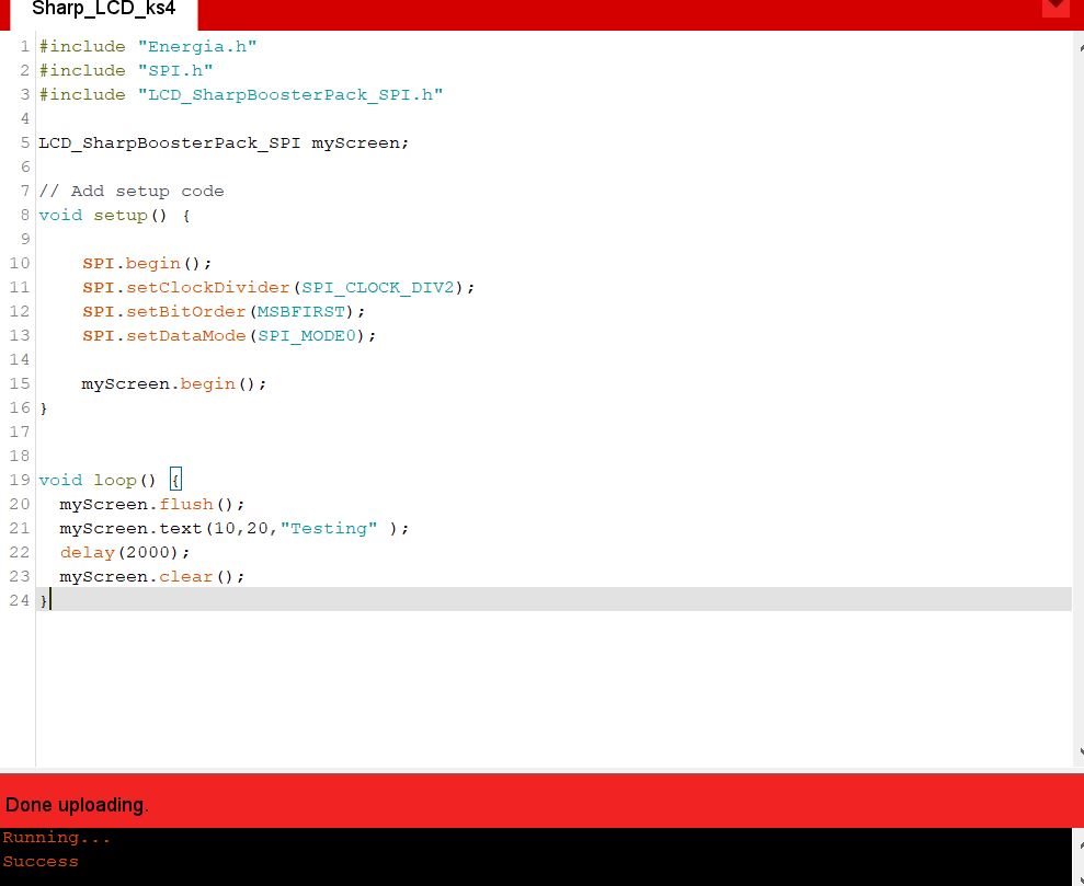

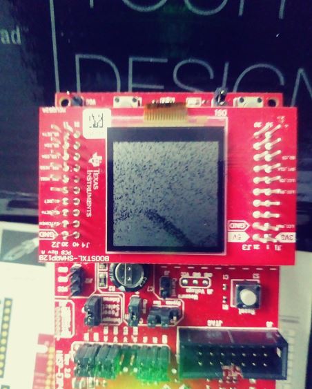

    I have found some Energia examples on-line, but I can't get it to work properly. Does anyone know what I'm doing wrong? See below.
    Display is just a load of random dots and dashes. I can use myScreen.clear() to clear the screen.

    I had this problem because the software was set for the 96x96 LCD not the 128x128. A simple change to the define fixed it. (Note this was Ti software, not Energia.)
    What change did you make to the define?
    I've tried adding the following, to no avail.
    #define LCD_VERTICAL_MAX    128
    #define LCD_HORIZONTAL_MAX  128
  • Again this was for Ti, not Energia,
    I had to change BOARD_DISPLAY_SHARP_SIZE in boards.h

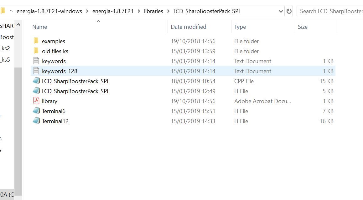

  • The library in Energia was update a while ago for the Sharp 128 display but there was no release since that time.
    Meanwhile you can find the files here:
    https://github.com/energia/Energia/tree/master/libraries/LCD_SharpBoosterPack_SPI
     Stefan
  •  Using the files. Still unable to get it to compile. Any idea what I'm doing wrong?

    I've removed them and it now compiles; however, there still appears to be a problem. See below. I've noticed that the sketch doesn't get past myScreen.begin().
  • Hi Kris,
    right the problem is that the FR5969 does not have enough RAM to hold the Buffer for the LCD.
    But we can also use the FRAM for data handling.
    So just pushed an update to github which does implement this.
    After pulling this new version please go into the LCD_SharpBoosterPack_SPI.cpp file
    and replace
        uint8_t _frameBuffer[128][128/8] PLACE_IN_FRAM;
    with
        uint8_t _frameBuffer[128][128/8] __attribute__((section(".text;")));
    As this is an pending issue which will also get fixed in the next release.
