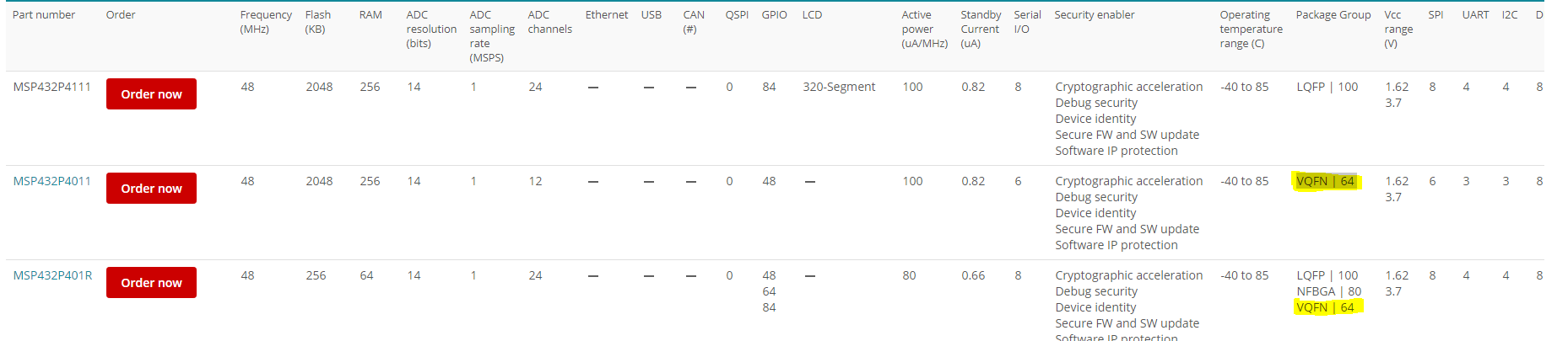

Robert Cachro said:However, we are limited to the 64pin P401Rs package size. The 100pin P4111 is too large for our PCB.
Can you use the MSP432P4011 device? It has the bigger memory but the same 64pin VQFN package as MSP432P401R. See screenshot below. The power consumption is slightly higher for the MSP432P4011 when compared to MSP432P401R. Also some of the peripherals are less on MSP432P4011 when compared with MSP432P401R. Please review the differences carefully!
