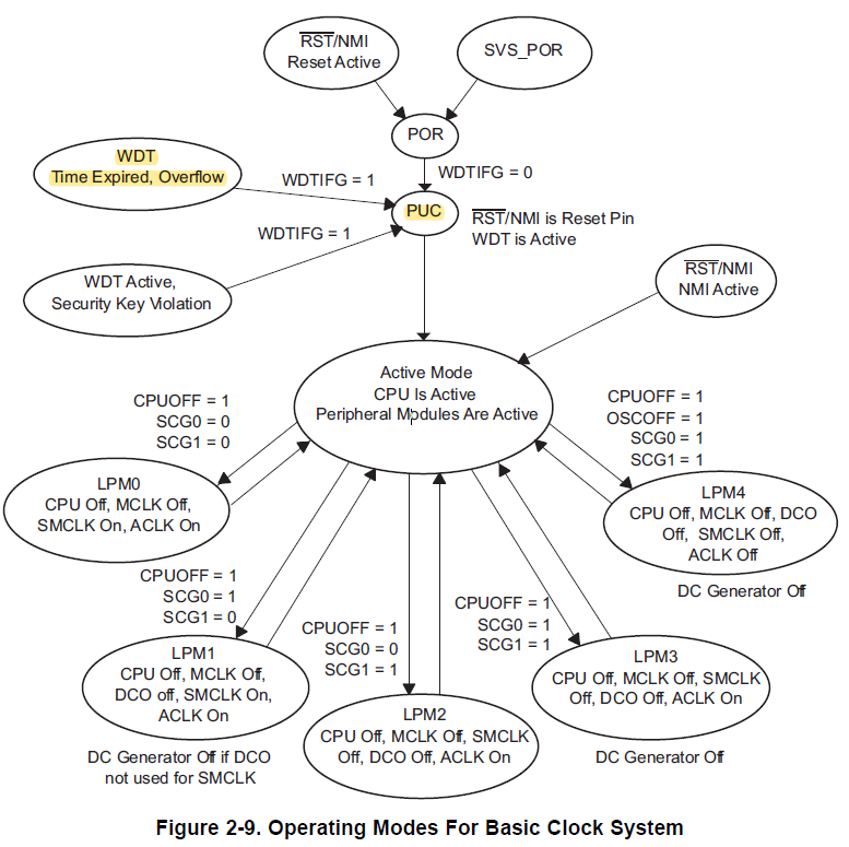

I am facing a difficulty where after the watchdog timer expires the ADC stops working. All other parts of the code works fine but the ADC reads out 0. But after resetting the power, the ADC starts working. Also, if the watchdog timer expires again then ADC starts working.
What could be the possible reason for this?

    The WDT only can generate a PUC(power up clear) signal. It is different from POR(power on reset).
    When you reset device ,the ADC may convert a new data and working normally.
    But PUC may clear the ADCMEM register so you may find the ADC reads as 0.
    Hope this may help you.

  • Hi
    I understand that it wipes out the ADCMEM but it should fill it out again with data once it has been asked to do  the ADC conversions. But even after 10-15 minutes I don't see the ADC reading other than 0. But due to same error if I make the watchdog timer to expire again, then ADC starts reading the actual values again.

    What I meant was ADC just stops and just reads 0x00 in the buffer register storing ADC result via DMA. I got a workaround for this problem by putting ADC10SA = 0x00 before initializing the ADC. So now whenever the watchdog timer expires the ADC10SA = 0 is the first statement to be executed before initializing the ADC again (as the code starts again from the beginning after watchdog expires) and magically it started working.
    Also, is it correct to put ADC10SA = 0 as be default it is 0x0200 and in the initialization part I point it to some other memory location. Or should I avoid writing to 0x00 and just write the memory address where the flash end?
