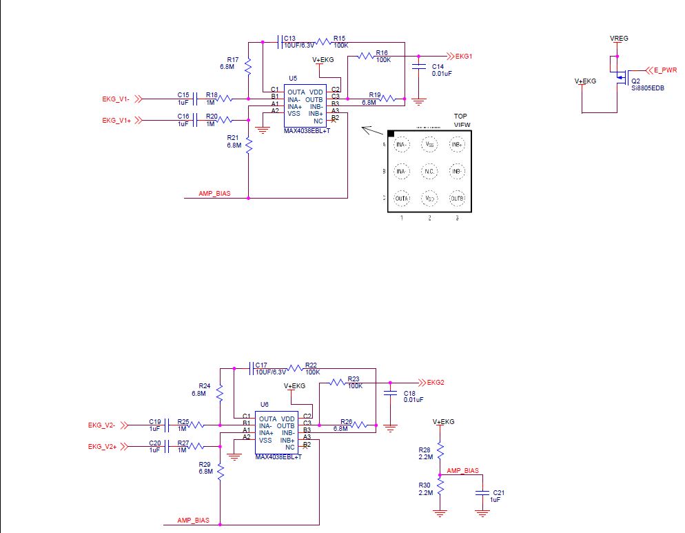

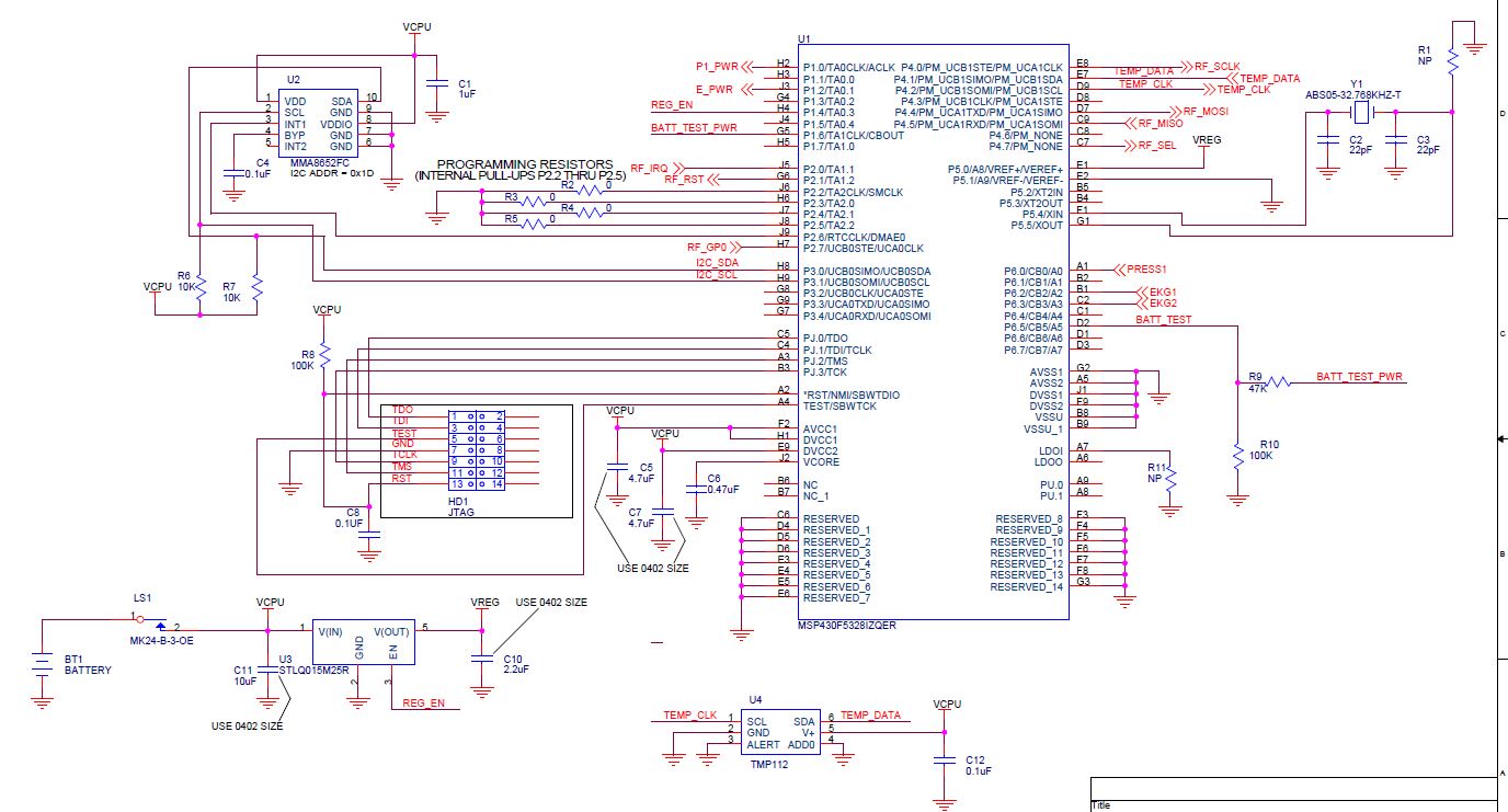

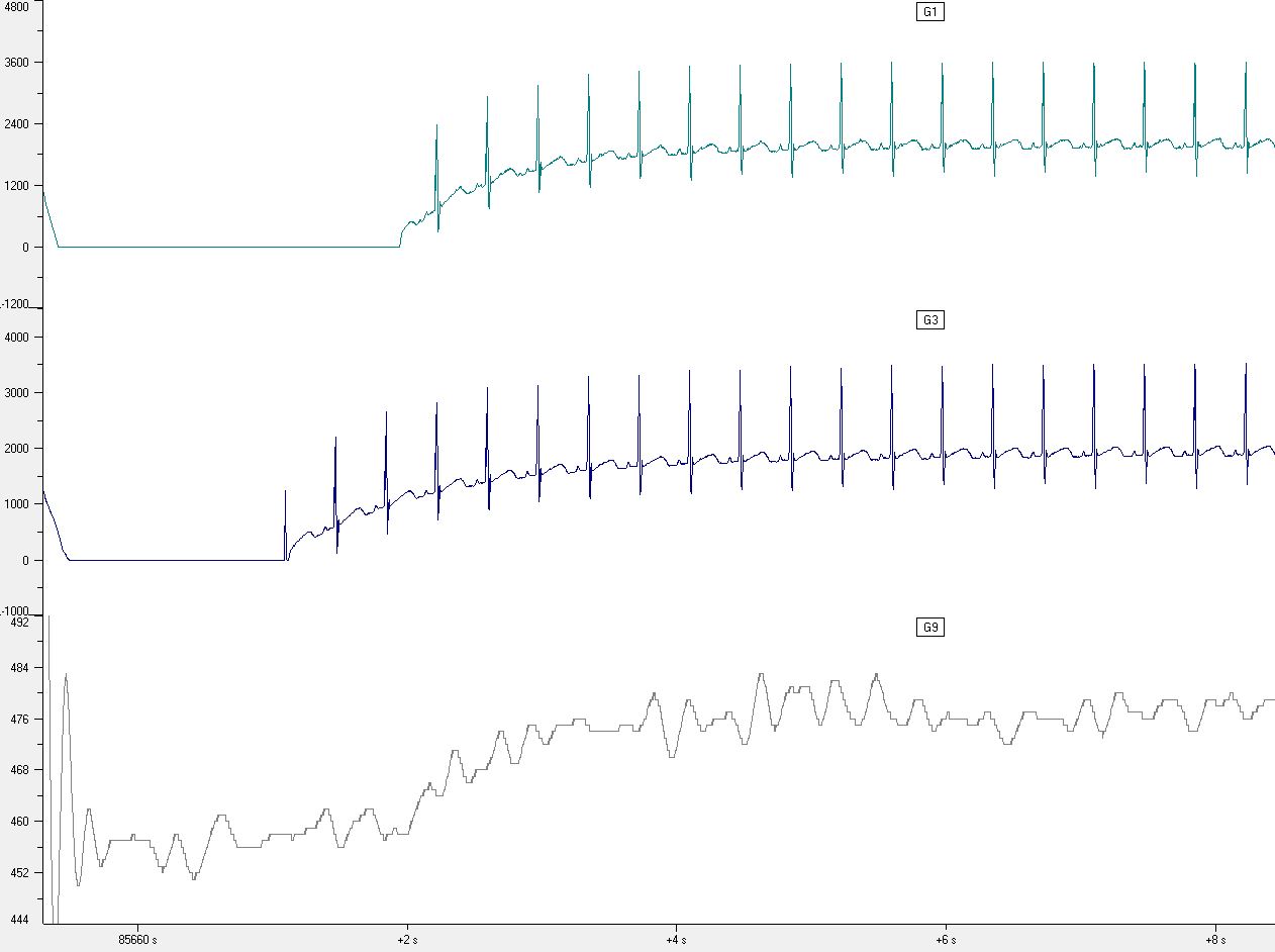

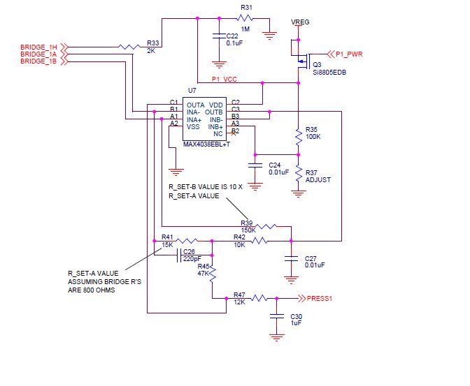

  • Hi Gary,
    Below is the schematic as well as two screen shots of the signals. The scale on the left is actual A/D raw counts.
    The supply to the MSP is from a 3 volt battery. The voltage to the processor is the same (meassured) The voltage from the 2.5 volt regulator is confirmed at 2.5 volts. The regulator is also the REF voltage to the processor. It turns on to stable in about 200 microseconds when any of the amps are turned on. The last two screen shots show the two AC coupled amp outputs, the bottom signal is the DC coupled output. You  can see the DC signal moving up as the AC amps are charging. When meassuring just the DC amp (last Screen shot) the base line is different from the baseline when including the AC amps. You will also see that the DC signal when meassured alone come upto a stable level very quickly in the last screen shot.

  • Call me old fashioned but I like the standard opamp symbol for circuits rather than a package outline. The outline makes it much harder to see what is going on. But I have questions:
    1) Do the sensors have a ground reference? They must as every bridge sensor I have seen is a four wire device. Also in the category of things unseen is the ground system. I see only one symbol used but the ADC front end should be on AVss and AVcc. Some filters to isolate those from the digital side would also be nice.
    2) When you say that only the DC circuit was measured, exactly what does that mean. Was only the ADC configuration changed? Was power to the AC coupled circuits enabled?
    The design of the ADC input mux makes it very unlikely that the mux is the cause of your trouble. More likely is a fault in the analiog front end. The time constant of the problem appears to match the time constant of the voltage reference circuit (why not the ref included in the MAX part?) so look there.
  • Hi David,
    Thank you for the reply.
    1) Yes the connections to the amp is output of a full bridge. The power and ground to the bridge comes from the voltage regulator for all sections, bridge, amps, amp references and processor REF. The grounds are all connected on an internal ground plane on the board. The board itself is only about 1/2 inch in diameter.

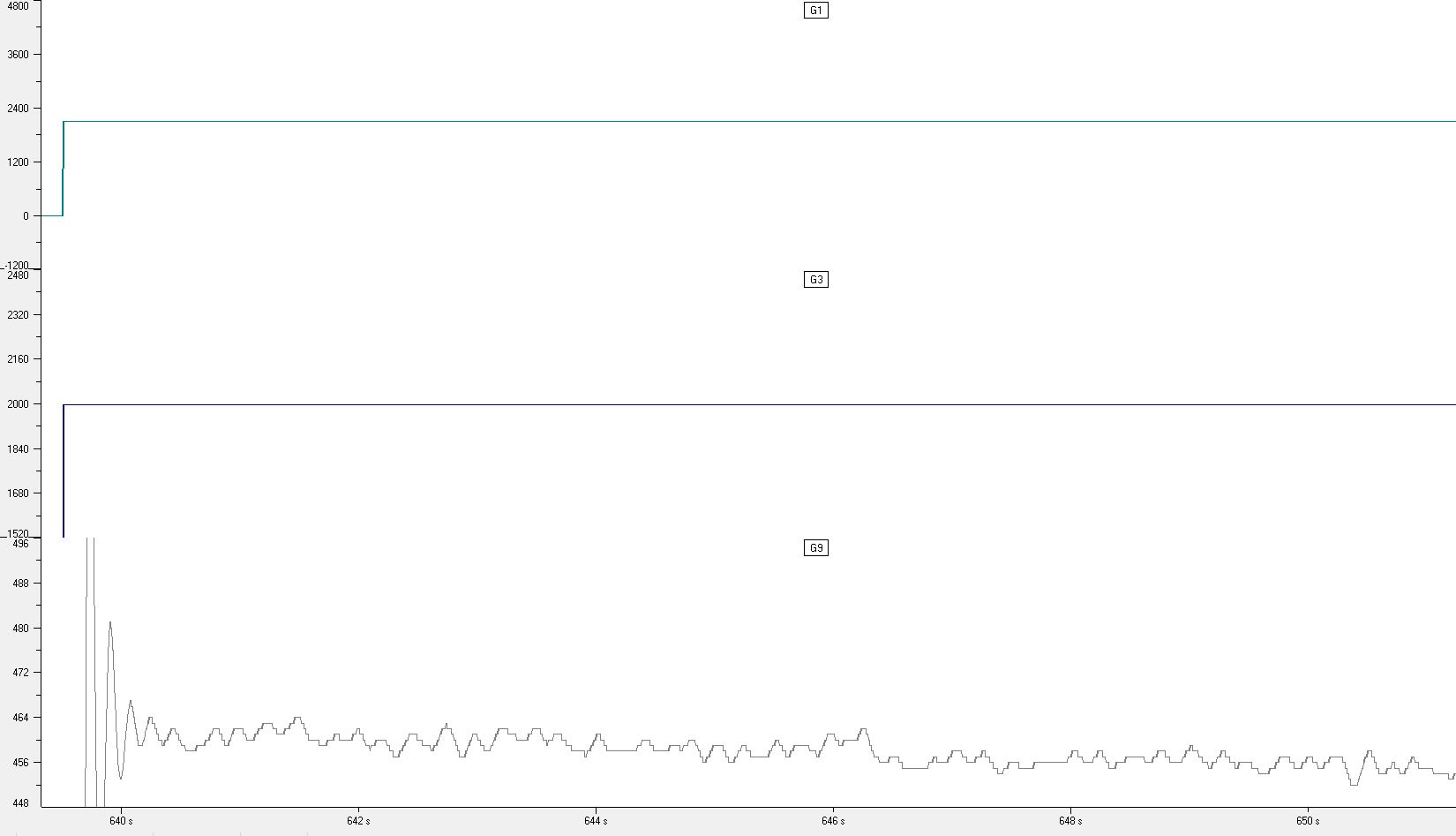

    2) When measuring the output of the DC amp through the A/D. The other amps are not turned on and the A/D configuration is changed accordingly. When we measure the analog voltage directly from the DC amp we do not see any of the charging using an oscilloscope. We only see the charging in the A/D readings from the DC amp when we turn on the AC amps and read them through the A/D.
    We measured the output of the voltage reference (voltage regulator) and this is very stable within about 200 microseconds. The charging effect on the readings is about 5 seconds.

  • The reason you don't see the voltage ramp when the AC coupled amps are not powered is because the AMP_BIAS also gets its power from that switched output. This is the long time constant signal that I am referring to.
    Because you have RC low pass filters between your opamps and the ADC input you do have to worry about things that don't happen with nicely buffered signals. This works well at low sample rates where the capacitor voltage has plenty of time to recover from the charge transfer between samples. You don't lose a lot of charge per sample to that 20pF sample and hold capacitor but it can add up at high sample rates. The amount of charge transferred is effected by any residual charge on the sample and hold capacitor.

  • More things you left out.
    I don't see C14, C18, or C30 on that list and those are the caps on the ADC inputs. I still suspect an interaction between those capacitors and the sample and hold capacitance. Short out the R in those RC filters to verify. If the crosstalk goes away you have to do something to buffer your signals.

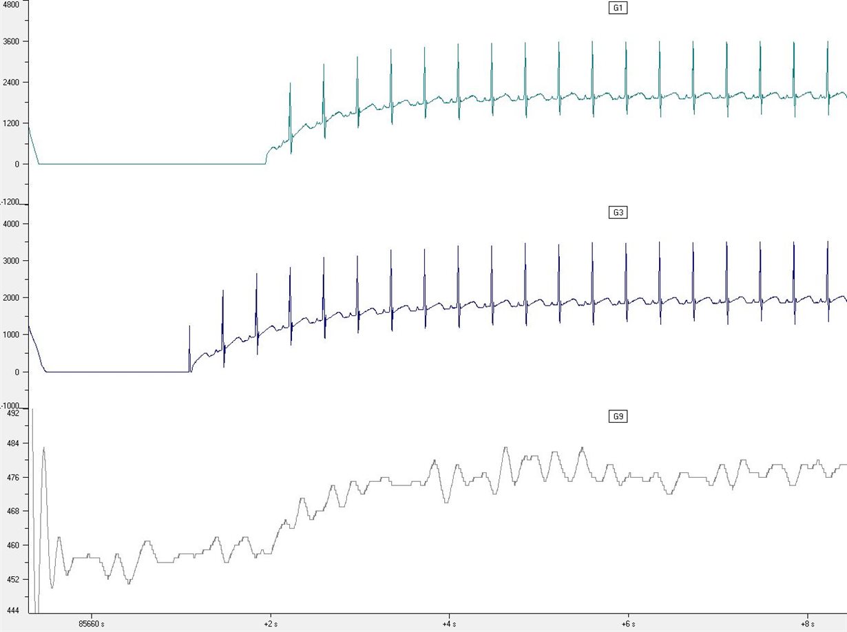

  • Hi David,
    Removing C14 and C18 did not do much.
    There is virtually no cross talk to speak of any longer after we moved the A/D channels around so that the DC amp is measured first in all cases.
    Now the only problem is that when we measure the DC amp by itself the base line is 1338 counts and when we add one of the AC amps we get counts of 1370 for the DC signal and finally when we add the second AC amp we get 1388 counts for the DC signal. The counts are changing depending on how many channels we include.
    We are turning on the DC amp for about 200 microseconds every 2msec and taking a measurement about 140 microseconds after the amp is turned on. I can see when the A/D is sampling because we have an output pulse generated on an output pin from the processor when it is triggered. This pulse does not change its position at all on the output signal of the DC amp when measuring both the pulse and signal with an oscilloscope. The point of measurement based on this pulse is the same no matter how many amps are turned on.
    Any Ideas?

    I just confirmed that there is something going on by turning on the DC amp 100% and ran the same tests. Although the A/D counts are much closer they are still a little different, only about 8 counts different.  I would expect them to be a little different and 8 counts is acceptable.
    There must be some change in the timing of when the A/D samples the DC signal when adding more channels. We would have thought that if the DC signal is always the first one sampled it would be the same (at least we assumed this is the case).
    Looking back at your message from earlier today you mentioned something about uniform sampling and this might be our issue. We are only sampling whatever signals were turned on and this might be where the issue is. If were are taking 2 samples from each sensor the amount of time it takes to come back for the second sample after conversion of the first sample is longer with more channels getting sampled. Thinking about it now when doing this you would expect the average of the two samples to go up with more sensors because the output on the DC amp has not reached its stable point, this is actually true, the readings go up the more signals we sample.
    What we are now trying is to measure the same number of A/D channels no matter what signals or amps are turned on so the timing stays the same. We will just use the data according to what signals we intend to use. If the issue is with this timing then this should correct the problem.
