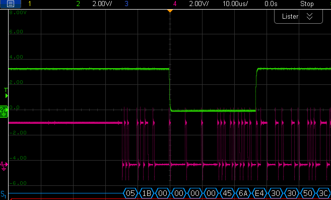

I've setup my system with a 2Mbaud UART (our use of DMA comes from the high speed of the UART) and a pin toggling whenever the "Start bit" interrupt fires.  The data comes in bursts of 48 characters, so I'd expect 48 interrupts.  That is not what I get.  For each burst, I always seem to get the first toggle on the 3rd character and then after that I get a toggle every 5 or 6 characters, but sometimes it misses one.  Its interesting that I get a toggle after the data burst completes.
My interrupt handler (HWI) looks like this
  uint8_t intStatus_u8;
  intStatus_u8 = MAP_UART_getInterruptStatus(EUSCI_A2_BASE, EUSCI_A_UART_STARTBIT_INTERRUPT_FLAG);
  if (intStatus_u8 & EUSCI_A_UART_STARTBIT_INTERRUPT_FLAG)
    MAP_UART_clearInterruptFlag(EUSCI_A2_BASE, EUSCI_A_UART_STARTBIT_INTERRUPT);
    P4->OUT ^= GPIO_PIN3;
Looking in execution graph, we can explain some of the behvaiour.
  • The missed toggles look like they might occur because another HWI ran.  0x20006640 is an unrelated timer interrupt has the same priority as the start bit interrupt. It is not clear why the start bit interrupt never ran.
  • The failure to toggle on all characters might be due to the turnaround time in the interrupt handler.
  • prior the first interrupt, the device is quiet - why didn't it hit the start bit of the first character (or at least the first character).  Why doesn't the start bit interrupt ever trigger on the first character?
