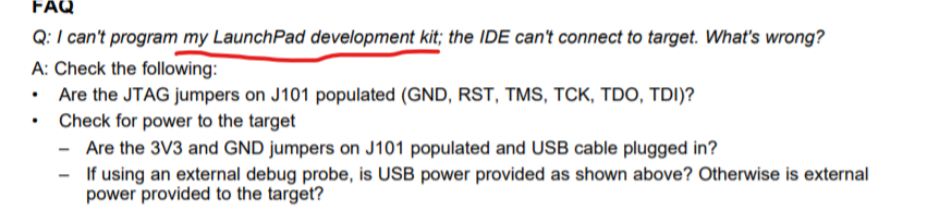

  • The trick with the Factory Reset sequence is that it doesn't try to connect to the device, only to the DAP (Debug Access Port) which gives it access to the mailbox registers. Are you following the sequence in Launchpad User Guide (SLAU597B) Section 5?

  • I tried doing Factory Reset through the DAP, as described in SLAU597B, but CodeComposer can't see the DAP as a non-debuggable core. I can see the DAP listed in "Target Configuration" and when I select "Routers" under the Debug Configurations, but it doesn't appear when I try to select "Show All Cores" so I can't run the Factory Reset script.

    The new issue is that my MSP-FET can't see the DAP as a nondebuggable core when I try to follow the instructions to do a factory reset - even on a board with a fulling working MSP432. I'm double checking the requirements for the DAP to make sure I didn't miss a hardware connection since I'm using a custom PCB.
    Thanks!
  • Hi
    I think the problem is that it is talk about launchpad. On launchpad it use XDS110. It is different with MSP-FET. XDS-110 can be used for all TI arm core device. But MSP-FET can be used on MSP432 and MSP430. Maybe it is the reason.
    Eason
  • Sure. I'm using a MSP-FET to debug an MSP432 on a custom board. I don't have an XDS. Is there any reason why an MSP-FET wouldn't be able to communicate with the DAP on an MSP432? And the run the same Factory Reset scripts that an XDS would run on a launchpad?
