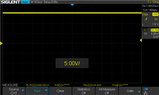

  • Thanks for the quick response Andrew. To answer your first questions,
    1. Voltage on GVDD pin is stable at 16.2V
    2. When BSTA is at 15.6V, SHA is at 2.8V w/ 0.1uF bootstrap capacitors (I can't seem to get this any higher with other cap values...)
    -both are "stable"
    3. for input PWM, I'm just using the defaul example FW which seems to be spitting out reasonable signals, besides the noise mentioned

  • BSTA:
    SHA:
    INHA:

  • Hi Andrew,
    Thanks for the additional information.
    My SHX outputs are now within 2 to 3 volts of BSTX which is good, but they aren't switching with the PWMs.
    Yellow is the rising edge of PWM INH_A, and purple is SHA. You can see some effect on SHA, but it's not switching low.
    P.S. Yes, I am using 6 pwm.

  • Hi Andrew,
    I had the mode pin set to inverted rather than non-inverted. I'm all set I believe.
    Thanks much for your assistance.
