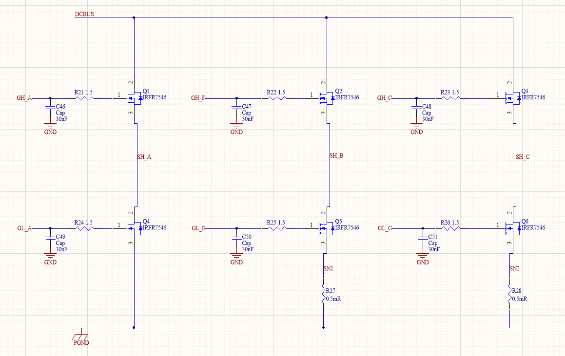

Recently, we designed a motor driver. After power on, we found that the nFAULT pin reported an error. After reading the SPI controller, we found the GVDD_UV, then measure GVDD pin, found to be zero volt, excuse me, why this problem?
Here is our schematic:
The gate capacitor in the schematic is not welded

    Thank you for the waveforms!
    The gate drive setting you are using is really high for the IRFR7546. Because your MOSFETs have a low Qgd (18nC), The 1.7A setting will likely cause the MOSFETs to switch on and off too quickly, causing ringing and oscillation on the gate/source nodes which could be feeding back to GVDD, causing it to behave incorrectly. Can you try adjusting the gate drive setting to the lowest setting (0.25A) by changing D0 and D1 of register 0x02 to 01? Most customers consider 200nS to be a fast turn on time, and depending on the PCB design even 200nS could still be too fast. Even with the lowest setting for this device we still may need to increase the resistance of the gate resistors to slow down the gate current even more.

    4. When you are measuring the gate control signal, are you measuring from the high side gate to the high side source of the MOSFET? Or are you measuring from the high side gate to ground?
    5. The 1.5 ohm resistor may not be quite sufficient to slow down the switching time enough For this particular MOSFET even with the lowest iDrive setting. You may try using a 5-10 ohm resistor instead. It is also possible that the DRV could have been damaged when operating it at the 1.7A gate drive setting, so you may try to switch out the DRV and test it again with a new DRV while making sure the gate drive setting is on the lowest setting.
