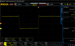

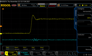

    To add some more info for you. I have scoped the SW2 pin of the TPS55288 and got the following plots:
    To me it appears that the ringing on the edge transients are excessive, with the voltage going negative to -1.4V (SW2 only rated to -0.3V). I also believe there is potential for the ringing on the rising edge to exceed the 25V limit on the SW2 pin.
    Do you think this would cause a failure like what I am seeing?
    If so, do you think this ringing is due to a layout issue? Or does our application need a snubber to help dampen this overshoot?
    I have been experimenting today and have successfully dampened the overshoot, but I would like to be sure this is our only issue before sending a new board design out for fab.

    For an update on the ringing, with the 1uF capacitor installed on the current PCB there wasn't much improvement on the overshoot:
    Based on this, it looks like the RC snubber is needed. Below is a capture of the SW2 node with the snubber installed:
    The TPS55288 has now been operating for some time with the RC snubber installed and has not failed like the previous two, so do you think this looks ok?
