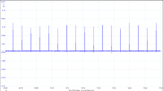

  • Hi Eric,
    We repeated the tests, but with very similar voltages on pins 10 & 17.  This is strange as we did this test twice last week where pin 17 was 1V.
    Attached are results and waveforms. I have captured pins 18 & 19 together, 18 & 20 together and 19 & 20 together as i only have 2 ch scope.
    FYI, we are waiting on the delivery of a better scope.
    I really appreciate all your help so far.  Thanks!

  • Hello Jeff
    As you can see on the #19, #20 waveforms, the high-side MOSFET switches now.
    Next step is to connect the inductor. Before connecting the inductor, please set your power supply current limit to 0.2A and remove the load.
    -Eric Lee Applications Engineering)

    We got good numbers on the IC, but once again, blew the IC after the 47uH inductor was connected.
    I have attached a trace from SW (pin 20) and the voltages obtained before the inductor was re-connected.
    Jeff10 - TI - Feb 18th.docx
  • Hello Jeff
    1. #15 pin voltage is wrong, or the device is damaged already.
    2. Please measure  #18 minus #20 voltage too.
    3. Pin 20 waveform without inductor is normal
    4. Pin 20 waveform with inductor is abnormal.
    -Eric Lee (Applications Engineering)
  • Hello Jeff
    1. Please see the SW voltage drop when the high side switch is on. I see about 5V drop, which can be caused by 500A inductor current if the high-side MOSFET Rdson is 10mOhm.
    2. Based on your waveform,  the high-side MOSFET turns on for more than 10us, which is also not normal.
    - Eric Lee (Applications Engineering)
