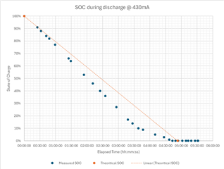

We are using a BQ28Z620 BMS with LiPo batteries in 2s configuration and are having some issues having a valid SOC value.

After that, the SOC was tested by charging the battery to 100% capacity and discharching at a steady rate of 430mA (~C/5). The SOC, voltage and current was manually logged to observe the discharge.
We would expect the SOC to be mostly linear with a discharge rate that should match with the orange line for 2100mAh. However, the relative SOC procides invalid value and indicates 0% charge about 45 minutes before the real empty state.

    Firstly, I recommend you refer to this FAQ to ensure you are calculating the SoC Accuracy correctly. Additionally, can you please provide me with the report you receive from the GPCCHEM tool?

    I programmed your .srec file onto my EVM, and it appears that you have not successfully completed the learning cycle, and update status is still 0x04. Please ensure that you have successfully completed the learning cycle before referring to the SoC accuracy. You can refer to this application note on Successfully Completing the Learning Cycle

  • Hi Jonny,
    We have completed the learning cycle all over again. Everything went as expected, except for the update status register which is still 0x04 after the last relaxation. According to the procedure, the update status should change to 0x06 when the VOK bit is cleared. However, it did not happen.The log and golden image are attached with this message.
     20250205-BQ28Z620-LiPol Rev2.1.zip
    We have been trying to run the learning cycle (which takes multiple days each time) for a while now and it still isn't working. Do you have any idea why the learning cycle is not completing or if we can force the learning cycle to finish?

  • Hi Jonny,
    I checked the post you provided. Looking at the log file, the DOD0_x registers were close to 90% change, but did not reach it most probably due to the batteries' internal protections when discharging. The undervoltage protection kicks in at 2.75V.
    In the previous cycles, our charging voltage was set to 8.3V. Would increasing the charging voltage to say 8.4V or 8.5V help to increase the DOD0_x change?

  • Hi Jonny,
    Good news!
    We successfully completed the learning cycle by increasing a little bit the charging voltage.
    The Update Status went from 04 to 05 after charge and to 06 after discharge.
    For anyone curious, here are the 3 things we did differently this time.
    1. Just after the first discharge, we manually balanced the batteries too reduce the discharged voltage before the DOD measurement
    2. We reduced the termination current to allow the battery to charge more before disconnecting
    3. We increased charging voltage a little to increase the difference in DOD measurements
    We did run the same kind of test as before to measure the accuracy of the SOC and the results are much better.
