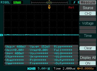

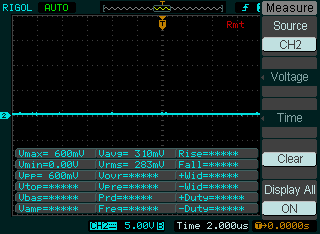

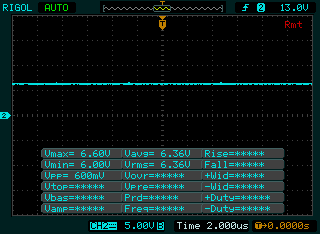

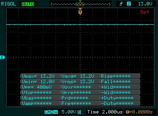

  • Steven ,
    The signals are the following ones
    12. REGN
    13.
    14.
    15.
    As the signals can tell, I assume that the IC was partly damaged because I still can measure de VREF 3V3 and the REGN 6V voltage.
    The signals for the LODRV and HIDRV were taken with the MOSFET fitted. Will this affect the measure? Should I remove the MOSFET and take new plots?
    Kindly - Jose
  • Jose,
    The charger may think that a charge is not needed and thus there is no switching. Measure VFB, STAT1 and STAT2 and give results please.
    HIDRV and LODRV may have been affected by damaged MOSFETs, after doing what I asked above, remove the MOSFETs and make measurements again for HIDRV, LODRV, VFB, STAT1 and STAT2.
    Steven

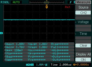

  • Steven,
    Before removing the MOSFET
    VFB
    STAT1
     STAT2
    In a moment will attach the plots without the MOSFET
  • This are the plots without the MOSFET fitted in the PCB

  • Jose,
    BTST voltage should be 13.1 + 5.5V = 18.6V. Check this measurement.
    The bq24650 may have been damaged. I would check the MOSFETs and bootstrap diode individually for functionality outside the circuit as well (continuity, drive the gate with 5V and see if there is any current passing through, etc). I would just replace anything that could have been damaged if its possible.
    Steven
