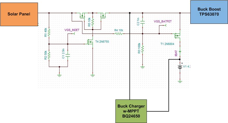

  • Hey Emilija,
    For the power-path, you could implement something like the following. You would need to tweak the threshold voltages and capacitor value to add some turn on delay as well as select the appropriate P-Ch FET. Remember here that the voltage will either be the battery voltage or a diode drop below the input voltage.
    As far you question about the BQ25895, I am a little confused as it seems you are putting a regulated DC/DC in front of the charger? Will the front-end DC/DC provide power point tracking for you? As far as the charger, the default VINDPM voltage will be 5V - 600mV = 4.2V if the unloaded output voltage of the DC/DC is indeed 5V. This means the charger will allow it's input voltage to crash to 4.2V and then subsequently regulate at that threshold.
    Joel H

  • Hey Emilija,
    That input PFET configuration will not work. You will effectively keep that FET always on as long as you have voltage present on either side. This means the battery will shorted to your solar panel. This could trip battery pack protection and/or feed current from your battery to the panel if it is in a poor condition/heavily shaded.
    I would recommend adding another PFET in the reverse direction with a small control NFET to drive the gates to ground when the solar panel input is present. And you are correct. I would actually add the delay circuit to this NFET to delay the turn-on of the input PFETS to give the "BATFET" PFET time to fully turn off.
    As far as the back-to-back FETs you drew up, I would just use a single PFET with its body diode in the direction of VSYS from VBAT (effectively Q1 only in your circuit). This will achieve power-path.
    In regards to the BQ25895, you will need a host controller to re-program the VINDPM threshold from the default value of VOC - 600mV.
    Joel H

  • Hey Emilija,
    You are close to what I was suggesting. For reference, this is a modification to the circuit you attached:
    The 1uF at the input and 40uF + 1A load at the output is an example of what is part of the required charging circuitry. The rest is similar to what you gave but adjusting the drive of the BATFET (Q1 in your circuit).
    As far as the solar panel and battery interaction: We only want the delay long enough to allow the BATFET to be turned off before the input protection FETs turn fully on. You will have to play around with the capacitance and resistor value in a SPICE simulator to get a feel for how much voltage drop you will see based on a particular delay you implement. The voltage droop and any oscillation will depend on several factors including:
    1) System load current and output capacitance
    2) Charging current
    3) Delay based on RC and voltages applied to the control NFET and the P-Ch. BATFET.
    4) FET threshold voltage
    5) The charger's programmable MPPT pin voltage setpoint
    6) Resistor divider ratios and lowest operating voltage of the panel
    This is not a complete list but it will get you started. Again, the main reason for the delay is so your input does not source as much current as possible into the battery.

  • Hey Emilija,
    I ran a quick SPICE sim on this circuit and replacing the diode with this is fine. Because you have that control NFET (T4).
    One thing that is missing in my circuit is a pull-up between VCMSRC and the shared gate connections of both T2 and T3. You will want to add a weak pull-up here.
    In this configuration, the body diode cathodes of the PFETs T2 and T3 face each other towards VCMSRC.
    As far as power transfer, when the input power is applied, the T4 NFET will be turned on and pull down on the gates of PFETs to ground, well below the common source voltage. With no input power, the common source voltage will be a diode drop below VSYS. With input applied, before the FETs turn fully on, the common source voltage will be a diode drop below the input voltage VIN.
    Joel H

  • Hey Emilija,
    A resistor is the pull-up I was referring to in my previous reply.
    VCMSRC was just a simulation node in my SPICE simulator. It does not have to be physically connected anywhere else.
    When VIN is not valid and very low, both T2 and T3 are off. The body diode of T2 will conduct and show a diode drop below VSYS at the VCMSRC node.
    When VIN is valid, both T2 and T3 are turned on as their gates are pulled to ground. VSYS will see VIN. T1 should be turned off by this point.
    And the reason we are using the BQ24650 is so you don't have to use an extra DC/DC at the input. If you will do that, there is no point in using this charger and instead go with the BQ25895.
    Joel H

  • Hey Emilijia,
    I just tested this on both TINA-TI and LTSpice and the result was the same as what I stated before. Make sure your spice model is utilizing a real PMOS instead of an ideal model without a body diode. Also check your simulation conditions. The voltage thresholds have to be set such that Q5 will turn on sufficiently and Q1 will turn off sooner than Q4 and Q2 turn on.
    The back-to-back input PFETs are needed so you do not short the solar panel and the battery. Right now, Q7 in your circuit has no function because it is always pulled to ground. Effectively, the battery can push current to the input with this always on PFET.
    I would also remove R18 or at least put it in series with the "Solar" and the Q1 gate.
    As far as your comments about using the BQ24650 for the MPPT and the extra DC/DC converter. Since you are looking for a fixed 5V rail, I would recommend using the BQ24650 plus a buck-boost DC/DC converter such as the TPS63070. In this case, you are looking at a model like this:
    Joel H

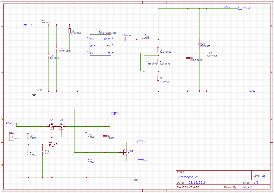

  • Hi Joel,
    I thought I replied but I cant see my message from today.
    The design you suggested looks great! I will design a PCB and build it.
    I've just got a few questions. Where do connected points IN1 and IN2? I dont really need Q7 if I have two back to back FETs before. Do I just short IN1 and IN2? Or do I connect left side of the first FET to IN1 and right side of the second FET to IN2?
    Also I'm not sure what voltage should I set as MPPSET? I read that I should set to 80% of the VIN. But I have two solar panels I might be using either 6V or 12V. Do I set 80% of 6V?
    Thank you for your support!
    Emilija

  • Hi Joel,
    Should I add a diode to prevent the leakage current going back to the charger as suggested in this document? http://www.tij.co.jp/jp/lit/an/slva829/slva829.pdf
    The document states that just having a diode and no extra capacitor will remove a battery detection function. Maybe that would be a good solution for my application? I could connect the load to the battery and I wouldn’t need a power path circuit? Would it work? Or will it have issues as the battery will be always in charging mode because the load will draw current and that means that life of the battery will be reduced?
    Also I found this power path design document:
    http://www.ti.com/lit/ug/sluu410/sluu410.pdf
    It looks more complicated than my design and it’s using a PG pin or STAT2. Do you think I need to take anything from this circuit?
    I would like to keep it simple, but I just wanted to check with you if anything’s missing.
    Please see my schematic below. Let me know if there is anything wrong.
    Thanks.
    Emilija
  • Hey Emilija,
    If you are using the configuration I recommended in my previous reply, the left back to back FET will be connected to IN1 and IN2 will be connected to the right FET.
    As far as MPPSET, you should base this value on either the 6V or the 12V. Not both. 80% is typically a decent estimate of the voltage @ MPP of the solar panel. I would also suggest looking at the solar panel datasheet and look for the peak power point voltage (usually on an I-V curve given).
    Joel H
