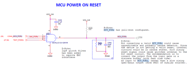

    MCU_PORz
    Leaving MCU_PORz unconnected is not allowed or recommended. Connect to a valid reset input with minimum slew. use a 22-pF glitch filter.

    Please keep in mind the AM62Ax device requires the MCU_PORz input to have a maximum rise/fall time of 1000ns. This may be difficult to achieve with a pull-up on a signal sourced from an open-drain output buffer. You may need to buffer the open-drain signal with a push-pull buffer that has hysteresis on its input to ensure the AM62Ax device never receives a short reset pulse that violates the minimum pulse duration defined in the "MCU_PORz Timing Requirements" table. For example, it may be possible for noise to couple on the slow rising open-drain signal just as it crosses the input buffer threshold which could cause a short glitch on the reset signal. Normal device operation could be compromised if this occurs.
    See the "Input Slew Rate" parameter in the "Fail-Safe Reset (FS RESET) Electrical Characteristics" table.
    The MCU_PORz input is the only input on the AM62x device that is fail-safe and 3.3v tolerant. Therefore, you can pull the MCU_PORz signal to 1.8V or 3.3V.
    See the "Steady-state max voltage at all fail-safe IO pins" parameter for MCU_PORz in the "Absolute Maximum Ratings" table.
     important point about the MCU_PORz input slew rate. It is very easy for noise to couple on slow rising signals such that it creates non-monotonic transitions. Your MCU_PORz reset source needs to be monotonic to prevent the chance of creating glitches on internal reset as it transitions through the input buffer switching threshold. A faster slew rate on the MCU_PORz will increase your system noise immunity. The min slew rate defined in the AM62Ax datasheet is acceptable to the AM62A device but may not be acceptable for your system noise immunity requirements.
     We define a minimum slew rate in the SOC datasheet for inputs and this creates a maximum rise time requirement. The rise/fall time for the reset signal must be less than 1000ns, not greater than 1000ns. To ensure your design meets this requirement, you may need to use a buffer between the PMIC and SOC or select a pull-up resistor value that is strong enough to charge your PCB parasitic capacitance and the SOC input capacitance in less than 1000ns. A rise significantly faster than 1000ns is preferred to minimize the potential of noise coupling to the reset signal.

    (+) [FAQ] AM625 / AM623 / AM620-Q1 / AM625-Q1 / AM625SIP: MCU_PORz input slew rate - Processors forum - Processors - TI E2E support forums
    Usually add RC filter on RESET signal to anti noise, but the slew rate requirement of RESET signal on AM62x datasheet is quite sharp, on customer board it is about 10V-100V/ms, can it meet AM62x reset requirement, if not please help to explain the basic mechanism.
    There can be long-term reliability issues associate with the input buffer if the applied signal spends too much time in the voltage region between VIHSS and VILSS. The maximum transition time allowed is 1000ns. I recommend driving the reset input with a push-pull buffer that produces a signal transition rate that is faster than 10ns to eliminate the risk of noise coupling into the signal as it transitions through the input buffer switching threshold.
    A 22 pF glitch filter is recommended at the input of MCU_PORz
     another important point about the MCU_PORz input slew rate. It is very easy for noise to couple on slow rising signals such that it creates non-monotonic transitions. Your MCU_PORz reset source needs to be monotonic to prevent the chance of creating glitches on internal reset as it transitions through the input buffer switching threshold. A faster slew rate on the MCU_PORz will increase your system noise immunity. The min slew rate defined in the AM625 datasheet is acceptable to the AM625 device but may not be acceptable for your system noise immunity requirements.
    Please keep in mind the AM62x device requires the MCU_PORz input to have a maximum rise/fall time of 1000ns. This may be difficult to achieve with a pull-up on a signal sourced from an open-drain output buffer. You may need to buffer the open-drain signal with a push-pull buffer that has hysteresis on its input to ensure the AM62x device never receives a short reset pulse that violates the minimum pulse duration defined in the "MCU_PORz Timing Requirements" table. For example, it may be possible for noise to couple on the slow rising open-drain signal just as it crosses the input buffer threshold which could cause a short glitch on the reset signal. Normal device operation could be compromised if this occurs.

    1. Is there any problem that is expected when simplified with POWER-ON and Cold RESET as above circuit?
    This is not adequate for MCU_PORz.  Please review the reset section 7.10.3.1 and figure 7-3 of the datasheet.  MCU_PORz should be low throughout the power up sequencing and remain low for 9.5ms.

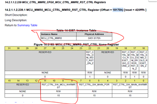

    And anyway they can accomplish the same thing using SW_MAIN_WARMRSTz in WKUP_CTRL_MMRx_RST_CTRL.

    Using a push button is likely to be problematic since there is a good chance contact bounce will produce a low pulse that violates the min reset pulse of 1200ns defined by parameter RST3.
    The recommendation is to consider using a reset supervisor that is able to debounce the switch and hold the signal low long enough to meet the 1200ns requirement.
    Adding a capacitor at the input of MCU_PORz (>22pF) is not recommended because it would cause the signal to rise/fall too slow for the cold reset inpu
     If there is a MCU or FPGA connected to the same signal, the attached device may operate as an input and open-drain output (similar to how our warm reset pin works on AM335x).  It may be able to detect any falling edge created by the pushbutton switch or any other device that can pull the signal low, and apply a debounce period where it holds the signal low long enough for the switch bounce to end, and long enough to meet the 1200ns requirement.

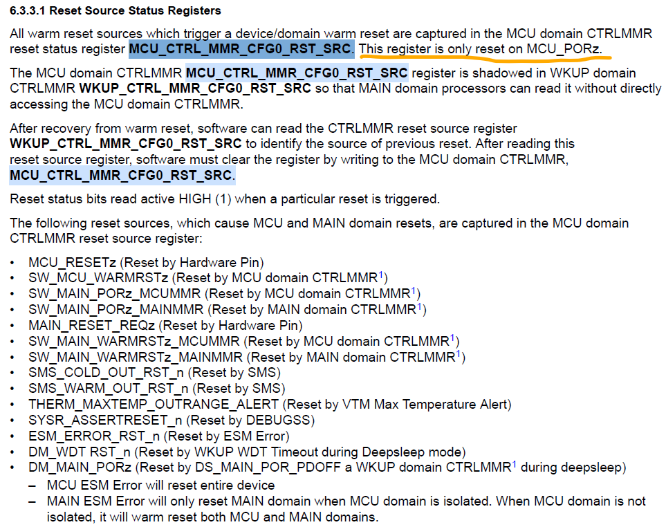

    MCU_PORZ:  MCU and Main Domain cold reset.  This is the power-on reset for the MCU/entire device and is required.
    MCU_RESETZ:  MCU and Main Domain warm reset  This is the warm reset request for the MCU/entire device, optional. Pull-up if not used
    RESET_REQZ:  Main Domain external warm reset request input.  This is main domain warm reset request, optional.  Pull-up if not used
    Cold (power on reset) resets the entire device (all registers).  Warm reset reset most of the registers, but does not reset everything.  See TRM for definitions of which resets are NOT reset with warm reset.   Support for separate warm reset is optional.
    PORZ_OUT:  Power-On reset status output, simply buffered version of MCU_PORz input.
    MCU_RESETSTATZ:  MCU Domain warm reset status output.  This the reset output of the MCU/entire device.  Is asserted for both external reset (MCU_PORz) and internal reset conditions (in the mcu domain).
    RESETSTATZ:  Main Domain warm reset status output, this reset output of the main domain, asserted for both external reset (MCU_PORz) and internal reset conditions (in the main domain).

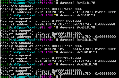

    The Section, Reset Source Status Registers of the AM62Px TRM provides a good explanation of the WKUP_CTRL_MMR_CFG0_RST_SRC register behavior:
    The WKUP_CTRL_MMR_CFG0_RST_SRC may be at 0x0 because there was a MCU_PORz power-on cold reset triggered.

     RE: AM6442: Is MCU only (M4F) reset possible?
    when i try to reset the only m4f with SOC_generateSwWarmResetMcuDomain() function, both of mcu and main domains are resetting.
    Yes, this is expected behavior only. When MCU Reset, then reset will be effected for both MAIN and MCU cores and this is how SOC works.
