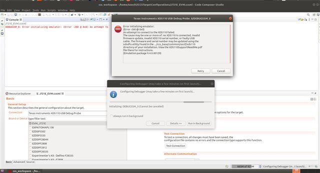

1. I am using VMware (Installed in windows) to use Ubuntu 18.04.5 LTS.
2. I installed CCS 10.4.0 in linux to connect to TDA4.
Issue : I see attached error
Connection Check between CCS and TDA4:

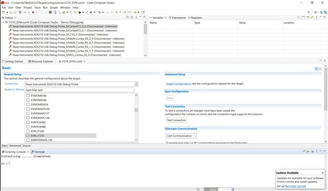

However, when I connect to TDA4 via CCS 10.4.0 in windows it connect without any issue. (refer Windows_1.JPG)
Can you please help me with this? On why I see error in connection in Linux

Hello Brijesh, Yes, USB device is allocated to VM.Also, if you see the output of the xdsdfu -e on the terminal. It's able to detect it
