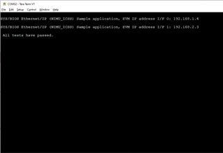

        UART_printStatus("\n All tests have passed.\n");                                                         // �e�X�g����̍쐬�ɍ��i

    I was trying to use Modbus tool but it always gave me "Time Out" error. Do you know what I missed?
    I used NIMU_ICSS_FtpExample without any modification. Below is what I saw on UART console. Did your customer see the same?
    Like you, I also get "Time out" when I use "NIMU_ICSS_FtpExample" without modifying it. I don't know the behavior of the sample code, but I think it is because there is no action to respond to data. I am looking for a way to get the same problem to occur in the sample project.
    Attached are the results of the UART console screen for the two different projects. The left one is the sample project and the right one is the customer's project.
