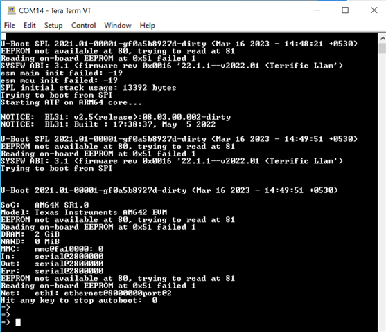

I am facing issue while loading u-boot. I tried loading u-boot on one of our AM64x custom board via USB-DFU. I successfully loaded tiboot3.bin and tispl.bin. After loading tispl.bin, the USB isn’t being detected in the PC hence I couldn’t load the u-boot.img file. (Screenshot of the USB-DFU utility and serial console of the board is attached below). Previously, these binaries were working fine on this board.
I tried flashing these files using dediprog at their respective location and after resetting the board, u-boot stops loading at the same location as in USB-DFU. (Screenshot of console is attached below)
Same binaries I could able to flash on other similar custom-board using dediprog and its working fine on that. (Screenshot of console is attached below)
What is the reason of this behavior and how it could be solved?
Below is the USB-DFU utility and serial-console logs.

Console log:
U-Boot SPL 2021.01-00001-gf0a5b8927d-dirty (Mar 16 2023 - 14:48:21 +0530) EEPROM not available at 80, trying to read at 81 Reading on-board EEPROM at 0x51 failed 1 SYSFW ABI: 3.1 (firmware rev 0x0016 '22.1.1--v2022.01 (Terrific Llam') esm main init failed: -19 esm mcu init failed: -19 SPL initial stack usage: 13392 bytes Trying to boot from DFU ##########################################DOWNLOAD ... OK Ctrl+C to exit ... init_env from device 10 not supported! Starting ATF on ARM64 core... NOTICE: BL31: v2.5(release):08.03.00.002-dirty NOTICE: BL31: Built : 17:38:37, May 5 2022

Yes, the other board is same as the non-working board. The u-boot images can be used as it is on this two boards.

Hi Hong - let me summarize.
There are two boards - one where the U-boot loads, and another where the U-boot does not load. Even after writing the same U-boot binary at the same location in both boards, the observation is that the U-boot does not get loaded. It seems the processor gets stuck inside the Arm Trusted Firmware. Dediprog is able to write to the memory in both boards and also RBL is able to load the SPL - so we can confidently rule out H/W issues with the memory itself in the second board. Vishal has confirmed that the chip versions on both boards are SR1.0. The method used by them to ascertain this was the one documented here. https://software-dl.ti.com/processor-sdk-linux/esd/AM64X/08_04_01_04/exports/docs/linux/Foundational_Components_Migration_Guide.html#device-types

The first stage R5-SPL is running from on-chip SRAM, and the next-stage A53 ATF/OPTEE/SPL/u-boot.... runs from external DDR.
