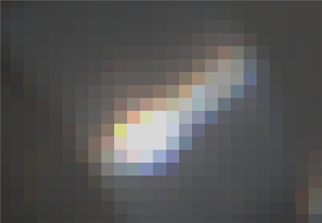

I have some new findings on the purple edge problem on TDA4, and there are new questions in the meantime.

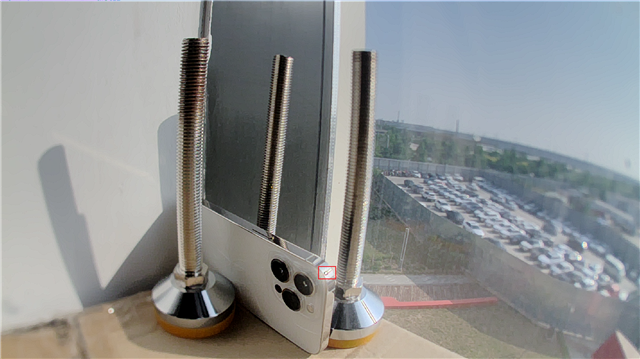

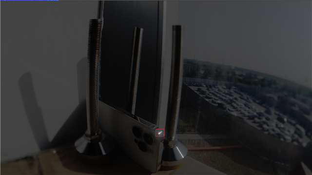

We found that the purple edge problem in RAW image is not so obvious as in YUV image around the hightlight part in image, as shown in the snapshots. The edge of the highlight in red rectangle in RAW image (fig1-1 & fig1-2) have color problem maybe cause by the lens, but the same place in YUV image (fig2-1 & fig2-2) become more serious and some of the pixels even turned black, which makes the purple edge problem looks more obvious. So, do you have any idea on which process in TDA4 will cause this problem?
We tried to turn off EE plugin, but there is no change on the purple edge.
Is this related to the PWL setting?
 fig1-1 raw image  fig1-2 partial magnification of fig1-1 (red rectangle)
 fig2-1 yuv image
 fig2-2 partial magnification of fig2-1 (red rectangle)
The RAW & YUV images are attached here: purple edge problem.zip
Thanks.

    In general, YUV is more colorful than RAW since WB and CCM are applied in YUV.
    The problem in your test scene is more complex than simple CA because of the high contrast from specular reflection and WDR tone mapping.
    Tone mapping may make the color worse.
    If you shift the red rectangle to the center of the view, do you see much less color artifacts?

  • Hi Zhili,
    There is a clear purple edge when the phone is around image corner and no purple edges when it is close to image center.
    The CA issue of purple edges should be reduced by CAC.
    Overall, the YUV images look very unnatural with heave posterization.
    You may have too strong noise filtering and/or tone mapping.
    The other issue of the darker band around the specular reflection seems to be related to tone mapping control.
    The transition is very sharp around the reflection.
    I will have to take a deeper look.
