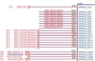

I have the problem on the GPMC interface. for hardware ,we have set cs0 for NAND (8 bit  A/D multiplexed mode). cs2 for 256K sram (18bit ad lines ,16 bit D lines).
cs3 for 1M FPGA (20 bit AD lines ,16bit D lines).so how to cofigure GPMC in the dts ?

    AM6254 :NAND,SRAM ,FPGA are all connect to A53 core interface.
    NAND :cs0, 8bit  Address and data multiplexed, 1G Byte.
    SRAM:cs2,16 bit Address and data None Multiplexed ,256k *16bit = 512K byte
    FPGA:cs3,16BIT Address and data None Multiplexed ,256K*16bit = 512K byte.

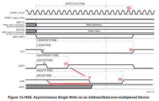

  • I  have configure the nand and sram  in the dts .
    &gpmc0 {
    status = "okay";
    pinctrl-names = "default";
    pinctrl-0 = <&gpmc0_pins_default>;
    ranges = <0 0 0x0 0x51000000 0x01000000>; /* CS0 space. Min partition = 16MB */
    ranges = <2 0 0x0 0x52000000 0x40000>; /* CS2 space. Min partition = 4MB */
    #address-cells = <2>;
    #size-cells = <1>;
    nand@0,0 {
    compatible = "ti,am64-nand";
    reg = <0 0 64>; /* device IO registers */
    interrupt-parent = <&gpmc0>;
    interrupts = <0 IRQ_TYPE_NONE>, /* fifoevent */
    <1 IRQ_TYPE_NONE>; /* termcount */
    rb-gpios = <&gpmc0 0 GPIO_ACTIVE_HIGH>; /* gpmc_wait0 */
    ti,nand-xfer-type = "prefetch-polled";
    ti,nand-ecc-opt = "bch8"; /* BCH8: Bootrom limitation */
    ti,elm-id = <&elm0>;
    nand-bus-width = <8>;
    gpmc,device-width = <1>;
    gpmc,sync-clk-ps = <0>;
    gpmc,cs-on-ns = <0>;
    gpmc,cs-rd-off-ns = <40>;
    gpmc,cs-wr-off-ns = <40>;
    gpmc,adv-on-ns = <0>;
    gpmc,adv-rd-off-ns = <25>;
    gpmc,adv-wr-off-ns = <25>;
    gpmc,we-on-ns = <0>;
    gpmc,we-off-ns = <20>;
    gpmc,oe-on-ns = <3>;
    gpmc,oe-off-ns = <30>;
    gpmc,access-ns = <30>;
    gpmc,rd-cycle-ns = <40>;
    gpmc,wr-cycle-ns = <40>;
    gpmc,bus-turnaround-ns = <0>;
    gpmc,cycle2cycle-delay-ns = <0>;
    gpmc,clk-activation-ns = <0>;
    gpmc,wr-access-ns = <40>;
    gpmc,wr-data-mux-bus-ns = <0>;
    partitions {
    compatible = "fixed-partitions";
    #address-cells = <1>;
    #size-cells = <1>;
    partition@0 {
    label = "NAND.tiboot3";
    reg = <0x00000000 0x00200000>; /* 2M byte*/
    partition@200000 {
    label = "NAND.tispl";
    reg = <0x00200000 0x00200000>; /* 2M */
    partition@400000 {
    label = "NAND.u-boot";
    reg = <0x00400000 0x00400000>; /* 4M */
    partition@800000 {
    label = "NAND.u-boot-env";
    reg = <0x00800000 0x00100000>; /* 1M */
    partition@900000 {
    label = "NAND.file-system";
    reg = <0x00900000 0x31600000>; /* 790M */
    sram@2,0 {
    //compatible = "ti,am64-nand";
    reg = <2 0 64>; /* device IO registers */
    nand-bus-width = <16>;
    gpmc,device-width = <2>;
    gpmc,adv-rd-off-ns = <35>;
    gpmc,adv-wr-off-ns = <35>;
    gpmc,we-off-ns = <50>;

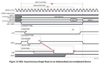

    gpmc,access-ns = <50>;
    gpmc,rd-cycle-ns = <60>;
    gpmc,wr-cycle-ns = <60>;

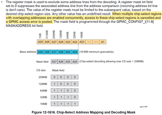

  • Hello Helen Han,

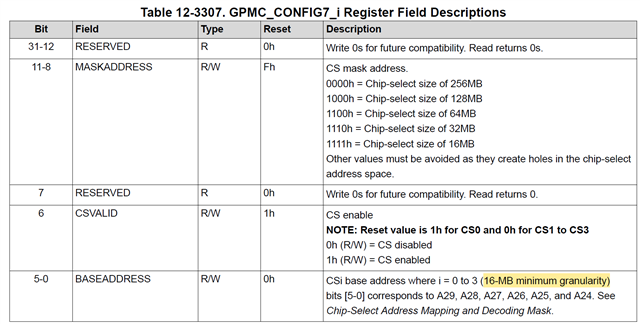

    In your project there are problems with the size configurations.
    For NAND memories there are no issues with size limitations.
    But for CS2 and CS3 you have configured 512K bytes, which is not supported by AM62X., In this 16bit not multiplexed, you can connect maximum 8M bytes for NOR and PSRAM .
    One more thing is that when you connect different memories on the same GPMC bus, which increases the bus capacitance which will create the malfunction of GPMC peripheral and to overcome these issues you need have proper pcb routing and will operate GPMC clock at lower frequencies.
    Please look at the FAQ below for more details about how much sizes can be connected to AM62x.
    https://e2e.ti.com/support/processors-group/processors/f/processors-forum/1349234/faq-am24x-am64x-am62x-what-are-the-maximum-sizes-of-nand-or-nor-or-psram-memories-that-can-be-connected-to-gpmc-for-the-am24x-am64x-am62x

  • Hi, Anil.
    what does this mean? the CS2 configured 512K , CS3 configured 512K . the total of CS2 and CS3 is 1M bytes. it is more minimum than 8M for NOR and PSRAM.
     I am sorry that i didn’t understand that it is not supported by AM62X.

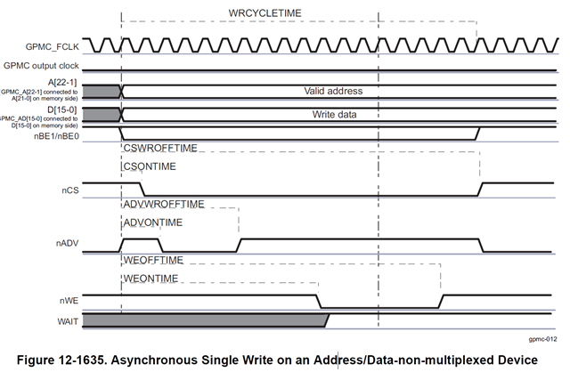

  • Hello Anil,
     I found some information in the datasheet(AM62x Processors Silicon Revision 1.0 Texas Instruments Families of Products).
     1.in chapter 2 of memory map ,page 43
    2.in chapter General-Purpose Memory Controller(GPMC) ,page10012
    why the GPMC0_DATA has different regions?

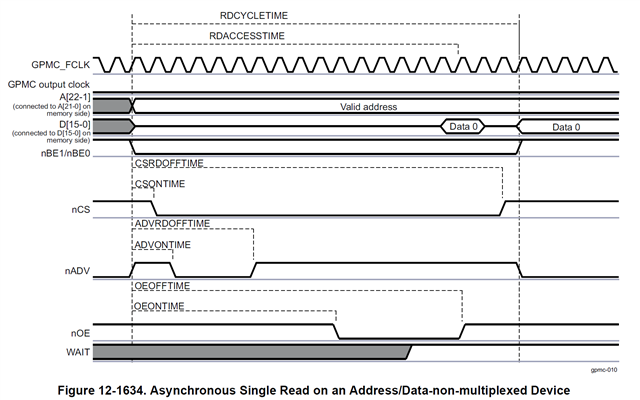

  • Hi  Swargam Anil,
     I found some information in ti-aemif.txt in kernel document .
    does the sram  support by compatible "ti,davinci-aemif"?
    I am urgent with the GPMC to connect the sram function .
    could you give me some advices or guides  how to achieve it ?

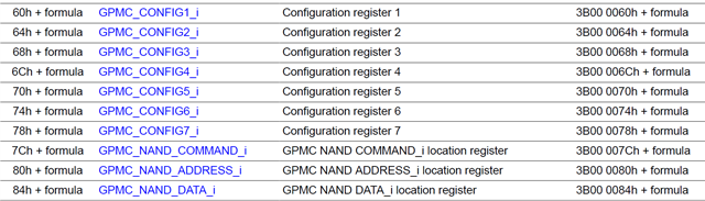

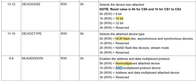

  • HI,I have confirmed the registers GPMC_CS_CONFIG0~GPMC_CS_CONFIG7, the configure is right.
    the gpmc ranges configure below:
    ranges = <0 0 0x0 0x52000000 0x01000000>, /* CS0 space. Min partition = 16MB */  //nand
    <2 0 0x0 0x51000000 0x01000000>; /* CS2 space. Min partition = 4MB */  //sram
    but after the system boot from nand , I use devmem2 command , I get the information like this:

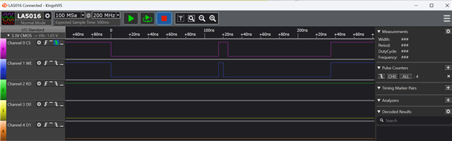

  • Hi Bin,
    now I use nandump cmd to read data from nand , I use oscilloscope to catch GPMC_CS0, the cs0 signal is  low in data tranmit.
    but when I use devmem2 0x52000000, the cs signal has no change , it is always high .
    so why devmem2 read phyical address didn't reach the nand device ?
    then whether I can doubt that the sram didn't work in the last response ?

  • Hi Bin,
    today I test the hardware of CS signal . I configure cs2 as a gpio . then write 0 , I catch low level .
    when write 1 , I catch high level. so the hardware of cs2 signal works ok .
    but configure cs2 to GPMC mode .  when run devmem2 cmd ,the cs2 is always high level.
    so I am sure that gpmc didn't  set cs2 low level when read the cs2 space address.
    so how to solve this problem ?

  • A  very long thread. Would like to input some thought.
    #1. The GPMC CSn is 16MB minimum granularity. although the SRAM, FPGA space is less then that, still can configure 16MB for each CSn.

  • Hi Tony,
    I have configure the CS2 register.
    the value is below:
    Read at address 0x3B0000C0 (0xffff8400b0c0): 0x00001000
    Read at address 0x3B0000C4 (0xffffa87760c4): 0x00060600
    Read at address 0x3B0000C8 (0xffffbea460c8): 0x00050500
    Read at address 0x3B0000CC (0xffffaca1c0cc): 0x07000401
    Read at address 0x3B0000D0 (0xffffa541e0d0): 0x00070808
    Read at address 0x3B0000D4 (0xffff947de0d4): 0x86000000
    Read at address 0x3B0000D8 (0xffff953190d8): 0x00000F51
    Read at address 0x3B0000DC (0xffffabcc80dc): 0x7F766E3B
    Read at address 0x3B0000E0 (0xffff872ec0e0): 0x77B779C7
    Read at address 0x3B0000E4 (0xffffa467f0e4): 0x7CF3D960
    I have confirmed the GPMC_COFNIG1_2 and GPMC_CONFIG1_7, it is as sram and  space address start 0x51000000 .
    but what means of  0x3B0000DC 、0x3B0000e0、  0x3B0000E4 for sram?
  • Hi Helen,
    From upper registers dump, CS2 mapped to 0x5100 0000, 16bit, asynchronous NOR-Flash like, Nonmultiplexed device.
    Ignore the NAND registers, not related to SRAM.
    Refer below Figure to configure rest timing field, you should be able to access the SRAM start from 0x51000000 to 0x51000000+SRAM size now.
  • HI, I have configured the timing register like this:
    sram@2,0 {
    compatible = "ti,fram";
    phy_base = <0x51000000>;
    max_size = <0x40000>;
    #size-cells = <1>;
    //reg = <2 0 0x40000>; /* device IO registers */
    gpmc,cs-rd-off-ns = <85>;
    gpmc,cs-wr-off-ns = <90>;
    gpmc,we-on-ns = <5>;
    gpmc,we-off-ns = <60>;
    gpmc,oe-on-ns = <10>;
    gpmc,oe-off-ns = <60>;
    gpmc,access-ns = <75>; //max75
    gpmc,rd-cycle-ns = <90>; //min =75ns max=90ns
    gpmc,wr-cycle-ns = <90>; //min65ns
    gpmc,cycle2cycle-delay-ns = <30>;
    our sram is  IS62WV25616EBLL-45TL.
    FA05-A76L-0101-0016 存储器 ISSI IS62WV25616EBLL-45TLI.pdf
    then below is my test:
    root@am62xx-evm:/root# devmem2 0x51000000 w 0x123456
    /dev/mem opened.
    Memory mapped at address 0xffffaeee9000.
    Read at address 0x51000000 (0xffffaeee9000): 0xFFFEFFFE
    Write at address 0x51000000 (0xffffaeee9000): 0x00123456, readback 0x00123456
    root@am62xx-evm:/root# devmem2 0x51000004 w 0x11223344
    /dev/mem opened.
    Memory mapped at address 0xffff9eb81000.
    Read at address 0x51000004 (0xffff9eb81004): 0x00120012
    Write at address 0x51000004 (0xffff9eb81004): 0x11223344, readback 0x11223344
    root@am62xx-evm:/root# devmem2 0x51000008 w 0x55667788

  • Based on the parameter, we can get below timing or writing and reading. as ADV is not used in non mux mode, it should not matter, but better to decrease ADVWEOFFTIME, ADVRDOFFTIME.
    As you configured 3 CS, dump out the rest 2 set of gpmc config 0-7 registers. and the two error registers to check if any error triggered.
    the read value  is wired, and at the same time , the cs2 is always high
    Can other signal also be probed? Can see signal toggling on other signal?
  • HI,I have  decrease ADVWEOFFTIME, ADVRDOFFTIME value from 35 to 10 and increase we-on-ns and oe-on-ns to 20ns.
    test the result not change. the cs2 is always high, I checked the oe and cs3 signal are always high.

    	gpmc0_pins_default: gpmc0-pins-default {
    		pinctrl-single,pins = <
    			AM62X_IOPAD(0x00b8, PIN_OUTPUT, 1) /* (U22) VOUT0_DATA0.GPMC0_A0 */
    			AM62X_IOPAD(0x00bc, PIN_OUTPUT, 1) /* (V24) VOUT0_DATA1.GPMC0_A1 */
    			AM62X_IOPAD(0x00e0, PIN_OUTPUT, 1) /* (V20) VOUT0_DATA10.GPMC0_A10 */
    			AM62X_IOPAD(0x00e4, PIN_OUTPUT, 1) /* (AA23) VOUT0_DATA11.GPMC0_A11 */
    			AM62X_IOPAD(0x00e8, PIN_OUTPUT, 1) /* (AB25) VOUT0_DATA12.GPMC0_A12 */
    			AM62X_IOPAD(0x00ec, PIN_OUTPUT, 1) /* (AA24) VOUT0_DATA13.GPMC0_A13 */
    			AM62X_IOPAD(0x00f0, PIN_OUTPUT, 1) /* (Y22) VOUT0_DATA14.GPMC0_A14 */
    			AM62X_IOPAD(0x00f4, PIN_OUTPUT, 1) /* (AA21) VOUT0_DATA15.GPMC0_A15 */
    			AM62X_IOPAD(0x00f8, PIN_OUTPUT, 1) /* (AB24) VOUT0_HSYNC.GPMC0_A16 */
    			AM62X_IOPAD(0x00fc, PIN_OUTPUT, 1) /* (Y20) VOUT0_DE.GPMC0_A17 */
    			AM62X_IOPAD(0x0100, PIN_OUTPUT, 1) /* (AC25) VOUT0_VSYNC.GPMC0_A18 */
    			AM62X_IOPAD(0x0104, PIN_OUTPUT, 1) /* (AC24) VOUT0_PCLK.GPMC0_A19 */
    			AM62X_IOPAD(0x00c0, PIN_OUTPUT, 1) /* (W25) VOUT0_DATA2.GPMC0_A2 */
    			AM62X_IOPAD(0x00c4, PIN_OUTPUT, 1) /* (W24) VOUT0_DATA3.GPMC0_A3 */
    			AM62X_IOPAD(0x00c8, PIN_OUTPUT, 1) /* (Y25) VOUT0_DATA4.GPMC0_A4 */
    			AM62X_IOPAD(0x00cc, PIN_OUTPUT, 1) /* (Y24) VOUT0_DATA5.GPMC0_A5 */
    			AM62X_IOPAD(0x00d0, PIN_OUTPUT, 1) /* (Y23) VOUT0_DATA6.GPMC0_A6 */
    			AM62X_IOPAD(0x00d4, PIN_OUTPUT, 1) /* (AA25) VOUT0_DATA7.GPMC0_A7 */
    			AM62X_IOPAD(0x00d8, PIN_OUTPUT, 1) /* (V21) VOUT0_DATA8.GPMC0_A8 */
    			AM62X_IOPAD(0x00dc, PIN_OUTPUT, 1) /* (W21) VOUT0_DATA9.GPMC0_A9 */
    			AM62X_IOPAD(0x003c, PIN_INPUT, 0) /* (M25) GPMC0_AD0 */
    			AM62X_IOPAD(0x0040, PIN_INPUT, 0) /* (N23) GPMC0_AD1 */
    			AM62X_IOPAD(0x0064, PIN_INPUT, 0) /* (T25) GPMC0_AD10 */
    			AM62X_IOPAD(0x0068, PIN_INPUT, 0) /* (R21) GPMC0_AD11 */
    			AM62X_IOPAD(0x006c, PIN_INPUT, 0) /* (T22) GPMC0_AD12 */
    			AM62X_IOPAD(0x0070, PIN_INPUT, 0) /* (T24) GPMC0_AD13 */
    			AM62X_IOPAD(0x0074, PIN_INPUT, 0) /* (U25) GPMC0_AD14 */
    			AM62X_IOPAD(0x0078, PIN_INPUT, 0) /* (U24) GPMC0_AD15 */
    			AM62X_IOPAD(0x0044, PIN_INPUT, 0) /* (N24) GPMC0_AD2 */
    			AM62X_IOPAD(0x0048, PIN_INPUT, 0) /* (N25) GPMC0_AD3 */
    			AM62X_IOPAD(0x004c, PIN_INPUT, 0) /* (P24) GPMC0_AD4 */
    			AM62X_IOPAD(0x0050, PIN_INPUT, 0) /* (P22) GPMC0_AD5 */
    		gpmc,adv-rd-off-ns = <10>;
    		gpmc,adv-wr-off-ns = <10>;
    		gpmc,we-on-ns = <20>;
    		gpmc,oe-on-ns = <20>;

  • Hi, Helen,
    too busy.
    I am sure I can capture the CS toggling with logic analyzer. by devmem2 configure GPMC directly.
    The timing is not good enough, I will adjust if I have energy in the weekend
    1 devmem2 0x3b000090 w 0x00001000
    2 devmem2 0x3b000094 w 0x000f1001
    3 devmem2 0x3b000098 w 0x00060321
    4 devmem2 0x3b00009c w 0x1005f011
    5 devmem2 0x3b0000a0 w 0x000d1010
    6 devmem2 0x3b0000a4 w 0x89000000
    7 devmem2 0x3b0000a8 w 0x00000f52
    root@am62xx-evm:~# devmem2 0x52000004 w 0xa5a5a5a5
    /dev/mem opened.
    Memory mapped at address 0xffff8f841000.
    Read at address 0x52000004 (0xffff8f841004): 0x005A005A
    Write at address 0x52000004 (0xffff8f841004): 0xA5A5A5A5, readback 0xA5A5A5A5
