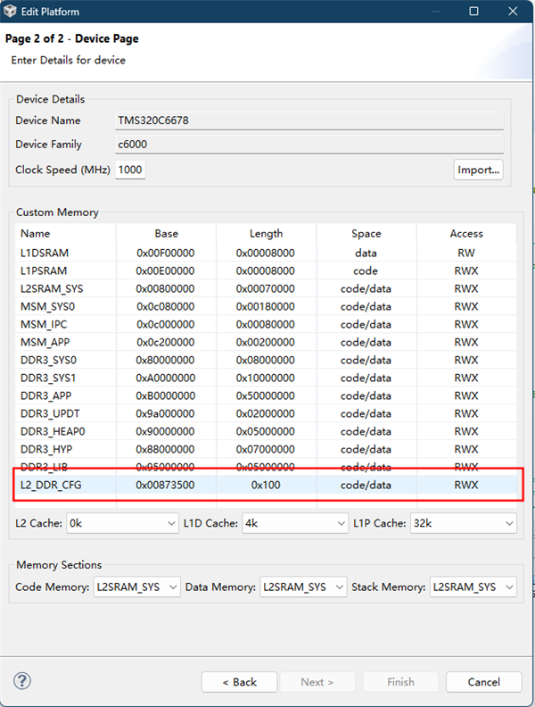

2. In order build it, I add a memory section defination in my platform, like this:
3. Add the memory mapping in the core.cfg file, like this:
Program.sectMap[".emif4Cfg"]            =   "L2_DDR_CFG";   /* 保存启动参数的配置表的内存段定义 */
Then I rebuild the project, in the output .map file,  I found that  there is no used in L2_DDR_CFG, and also no segment, like this:

Dose this mean RBL will not move anything to the 0x00873500(DDR configuration table address according to the manual file of C6678)? And DDR will NOT be configured in this condition?

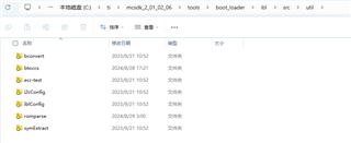

    Not yet, here comes a new problem:
    While using the spiboot.bat to create the SPI-NORFlash bootable image, I found After executed   hex6x.exe core0.rmd, in the output core0.mxp file, the .emif4Cfg gone away.
    Here post my output files and  the  core0.rmd:

  • Here is my CCS compiling output files, and the core.rmd is used for hex6x.
    6712.compile_output_files.zip

    set IBL_UTIL=C:\ti\pdk_c665x_2_0_16\packages\ti\boot\ibl\src\util
    I'm using C6678, mcsdk_2_01_02_06, pdk_C6678_1_1_2_6. So, the IBL_UTIL is under C:\ti\mcsdk_2_01_02_06\tools\boot_loader\ibl\src\util
    Post your screenshot and its output when you execute the "spiboot.bat".
    By the way, the  size of core.out(compiled by CCS)is 11MB, and hex6x output file core.btbl is 2.17MB.(you can see it in the zip). Maybe you can use my items to execute with hex6x, you may got the problem i'm faing now.
    I think if we should modify the .rmd file, to let Hex6x treat .emif4Cfg as a bootable section? Because, Hex6x only convert the initilized sections according to the SPRUI03B.
    Thanks !
