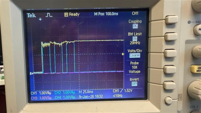

    Q.4

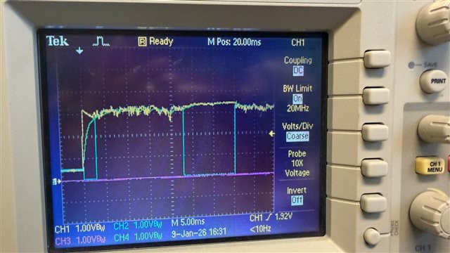

    (+) TPS65219: 3.3V no output - Power management forum - Power management - TI E2E support forums
    The TPS65219 PMIC executes two residual voltage checks; the first one occurs before the power-up sequence is executed and a second occurs during the power-up sequence (right before each rail is turned ON).
    The first check can be disabled by changing register field "Register field "BYPASS_RAILS_DISCHA RGED_CHECK" but the second one cannot be disabled. Please note that changing any register field would require to turn-ON the PMIC first and get the device in Active state to enable I2C communication.
    we found out where the residual voltage is coming from. This is come from E-PHY
    - Residual voltage VLDO4 , 2.5V line : 4~500mV /  VDDIO, 3.3V line : 50mV.
    If the backfeeding issue on VLDO4 exist before the PMIC executes the power-up sequence, then none of the rails will turn-ON. The reason is because as I mentioned in my previous message, the PMIC performs the first residual voltage check before executing the power-up sequence.
    Do you see a voltage on VLDO4 before Buck2 is turned ON?

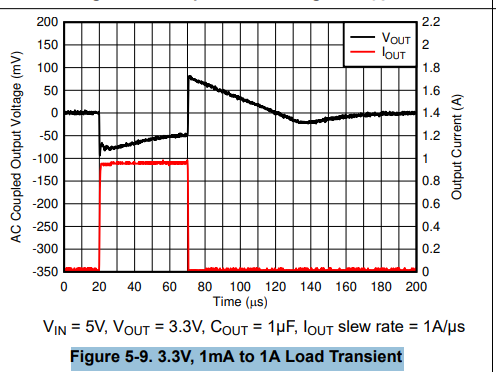

    (+) TPS65219: Can the maximum load capacitance of the channels be exceeded? - Power management forum - Power management - TI E2E support forums
    If the maximum output capacitance on the PMIC rails is exceeded, the phase margin starts to drop and stability gets affected.

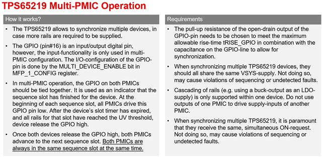

    Just for reference, the TPS65219 PMIC has an option for "multi-PMIC operation" that allows to fully synchronize the sequencing between multiple TPS65219 devices. This feature might help to split the load/POL capacitance across the PMIC rails. Is this a non-automotive application? The TPS65215 has a 4x4mm package option that helps to keep the overall power solution small even when using 2x TPS65219 devices.
    https://e2e.ti.com/support/power-management-group/power-management/f/power-management-forum/1204248/tps65219-reprogramming-the-tps65219
     This is a great feature in the TPS65219 PMIC that allows synchronizing multiple devices to power processors and SoCs that require multiple rails! Here is some information for the multi-PMIC operation, feel free to let us know if you have any questions and we will be happy to help.

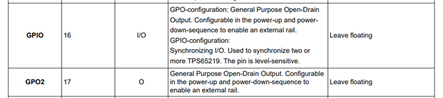

    • GPIO (pin#16) is used to synchronize the two PMICs.
    • To configure the GPIO pin for multi-PMIC, register field "MULTI_DEVICE_ENABLE" must be changed to 1.
    • The GPIOs on both PMICs should be tied together sharing the same pull-up resistor.
    • The I2C address for the 2nd PMIC must be changed on register field "I2C_ADDRESS" so they can both be connected to the same I2C bus without conflict.

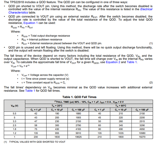

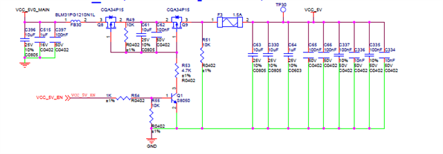

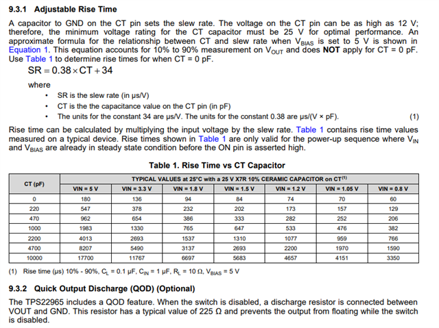

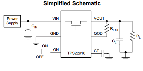

    Refer below input related to eFuse caps and pinout
    TPS22918 5.5-V, 2-A, 52-mΩ On-Resistance Load Switch

    Inputs related to load switch slew rate control, QOD and output cap.
    https://www.ti.com/lit/ds/symlink/tps22918.pdf
    9.2.2.1 Input Capacitor (CIN)
    To limit the voltage drop on the input supply caused by transient in-rush currents when the switch turns on into a
    discharged load capacitor or short-circuit, a capacitor needs to be placed between VIN and GND. A 1 µF ceramic
    capacitor, CIN, placed close to the pins, is usually sufficient. Higher values of CIN can be used to further reduce
    the voltage drop during high-current application. When switching heavy loads, it is recommended to have an
    input capacitor about 10 times higher than the output capacitor to avoid excessive voltage drop.
    9.2.2.2 Output Capacitor (CL) (Optional)
    Becuase of the integrated body diode in the MOSFET, a CIN greater than CL
    is highly recommended. A CL
    greater than CIN can cause VOUT to exceed VIN when the system supply is removed. This could result in current
    flow through the body diode from VOUT to VIN. A CIN to CL
    ratio of 10 to 1 is recommended for minimizing VIN
    dip caused by inrush currents during startup.
    8.3.2 Quick Output Discharge (QOD)

  • Hi Board Designers,
    Inputs related to load switch implementation using FET
    FET based switch implementation for peripheral supply control
    General implementation
    Can cause reverse voltage to be applied during power cycle
    Recommended implementation
    Note: Verify the slew rate requirement for the connected peripherals
