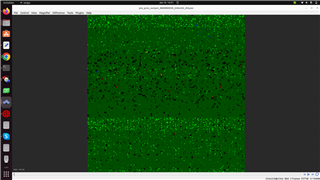

I'm working on J722S board with sdk 10. My application pipeline is scaler->Preproc->TIDL->Post-proc.
Unlike for J721E, it is known that we cant use pre and post-processing kernels which are part of img_proc kernels for c66 core in vision_apps.
So we have created custom kernels for both. We have developed a custom kernel for Nv12 to RGB planar conversion.It gives  the expected output.But when it is given as input to TIDL node, not getting expected output.
Please not that we have taken the empirical formula for conversion.
int R = (298 * C + 409 * E + 128) >> 8;
int G = (298 * C - 100 * D - 208 * E + 128) >> 8;
int B = (298 * C + 516 * D + 128) >> 8;
Is the idea proper and will there be any difference in the output of pre-processing present in img_proc and our simple conversion from NV12->RGBPLanar?

  •  Hi sir,
    As part of debugging, I integrated my custom pre-proc kernel in demo app_tidl_od application in 8.2 SDK. As the model size is 1024x512, I adjusted the custom logic to give 1024x512 BGR planar output. I dumped pre-proc output in both cases, one with SDK's preproc and other with custom logic.
    When I dumped with sdk's pre-proc, I found the tenosr width and height as 1025 and 515. I assume it is due to the padding. I dumped the pre-proc outpur for one frame and checked the pattern. I could not understand the way of padding.
    Please guide me how could I change my custom logic with respect to this?
    Raju

  • Hi sir,
    We have found a source file vx_dl_pre_proc_target_no_dma.c avaible in SDK 10.1 at $vision_apps/kernels/img_proc/c66 and ported to a new custom kernel for pre-processing on C7x core. When this node is integrated in the demo application app_tidl_od( SDK 8.2) running on J721E, the application is giving proper bounding boxes on the display.When the same node is integrtaed in SDK 10.1 in our custom file based application, the pre-processing node is not giving expected outupt.
    Note:
    1)Custom pre-proc kernel is built on C7x core in both SDK 8.2 and 10.1
    2)In the 8.2 SDK, eventhough the detections are proper on the display, I have verified the pre-proc dump using VOOYA app, it is not coming as expected.
    3)In the experiment done with J721E, the reference application is "app_tidl_od" where the input resolution is 1024x512 whereas J722S experiment has our custom application where tidl expects 224x224, thats the reason you observed the size change in below attached files but output are from the same input YUV image.
    Please find the pre-proc dump in both SDK 8.2(J721E) and 10.1(J722S) respectively.
    Please provide any reliable source code available in SDK 10,1 for pre-processing(NV12->RGB) that can be ported on to J722s as there are no working demo available on J722S which has pre-processing module.
    Thanks and Regards,
    Raju
