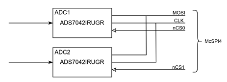

We have the following hardware configuration:
The two ADCs are attached to McSPI4 in multi-controller mode on an AM6442 SoC and are to be used on the R5F side. The requirements are as follows:
  • 128 KSPS readout rate
  • Sequential readout, first ADC1 and then ADC2. We have to be able to distinguish the data source, i.e., if the sample comes from ADC1 or ADC2
  • Stable readout frequency - max. jitter 10ns
  • Interrupt every 32 samples
We already have another ADC, attached to the SoC (8-channel ADS127L18), which acts as an SPI master and generates nCS and clock for 2 McSPI in peripheral mode. This ADC is being read out through PKTDMA+PDMA, being triggered on an McSPI RX.
Our intention was to use either the nCS, generated from the ADS127L18 (internally, as an internal trigger, or externally, as a GPIO interrupt), or a timer to trigger a second DMA, which has to read both ADCs sequentially.
Please note that a timer interrupt is not an option here, as it will cause a significant amount of jitter, leading to distortion in the digitized signal. We need a stable readout frequency.

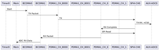

  • Now that I have a better idea of what should or could be done, I have drawn a sequence diagram illustrating how I envision the process:
    The above is repeated twice, for McSPI4-CH0 and McSPI4-CH1. The timers, delivering the start trigger, must be configured to work with an offset of at least 1us, since that would be the minimum time to complete the ADC Read (16 clocks@16 Mhz).
    Since it doesn't seem possible to trigger the BCDMA transfer from the event I originally intended (PDMA Transfer Complete or McSPI Peripheral RX Complete), I would like to explore triggering it from an internal DMTimer. According to a related post, this should be feasible, though with an IEP unit in the PRU. Following the same logic, the path from a DMTimer PWM Output could also be utilized, according to the TRM.
    From my understanding, this approach should be possible. If I am correctly interpreting the TRM, the events from Timer0 to Timer3 should be usable to trigger the BCDMA.
    Additionally, for the BCDMA channels, it appears that separate RX and TX channels should be used to connect to the PDMAs of the McSPI. Is that correct?

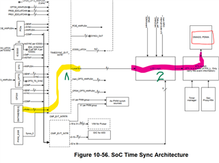

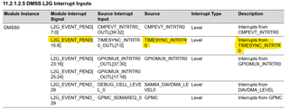

    2. How can the event routing from the corresponding timers (Timer0 to Timer3) to the L2G be configured?
    3. How should the BCDMA Tx channels be configured to be triggered by those timers?

  • Hi Anil,
    Thanks for your comprehensive reply. However, I don’t think it fully addresses my use case. Let me explain again:
    I need a BCDMA/PDMA configuration that meets the following criteria:
    1. We have decided to forgo triggering from the main ADC for now. Instead, our entire chain will be triggered by the DMTIMER0 in PWM mode, which delivers a pulse every 7.8125 µs (128 KHz) with a duration of 500 ns.
    2. This trigger should initiate a BCDMA write transfer to MCSPI4, CH0.
    3. Upon completion of (2), another PKTDMA/PDMA read channel on MCSPI4, CH0 should automatically be triggered via a DMA read request.
    4. Simultaneously, the completion of (2) should trigger another BCDMA write transfer on a separate channel to MCSPI4, CH1.
    5. This, in turn, should automatically trigger another PKTDMA/PDMA read channel on MCSPI4, CH1 via a DMA read request.
    6. After 32 SPI4-CH1 reads, an interrupt will be generated, at which point the gathered data will be processed.
    We already know how to implement points (3) and (5). I believe I have successfully triggered (2) from (1). My main question now is: How can (4) be triggered by (2)?
    To summarize, we are working with four DMA channels:
    • 2 BCDMA-PDMA channels
    • 2 PKTDMA-PDMA channels

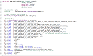

  • Hi Anil,
    We are trying to write 16-bit to the SPI, so it can also output 16 bit to the ADC.
    Please find some code segments below, however I am absoletly not sure if that is the correct configuration.

        //Configure BCDMA Ch0
        Udma_ChPrms chParams;
        UdmaChPrms_init(&chParams, UDMA_CH_TYPE_PDMA_TX);
        chParams.fqRingPrms.ringMem     = m_udmaCh0RingMem;
        chParams.fqRingPrms.ringMemSize = sizeof(m_udmaCh0RingMem);
        chParams.fqRingPrms.elemCnt = m_UdmaCh0TrCount;
        chParams.peerChNum = UDMA_PDMA_CH_MAIN1_MCSPI4_CH0_TX;
        // Open channel for TX
        int32_t retVal = UDMA_SOK;
        retVal = Udma_chOpen(m_udmaHandleBc, m_udmaCh0TxHandle, UDMA_CH_TYPE_PDMA_TX, &chParams);
        if (retVal != UDMA_SOK) {
            return std::make_error_code(TxEngine_ErrorCode::DMAChOpenError);
        // Config TX channel
        Udma_ChTxPrms txPrms;
        UdmaChTxPrms_init(&txPrms, UDMA_CH_TYPE_PDMA_TX);
        retVal += Udma_chConfigTx(m_udmaCh0TxHandle, &txPrms);
            return std::make_error_code(TxEngine_ErrorCode::DMAChInitError);

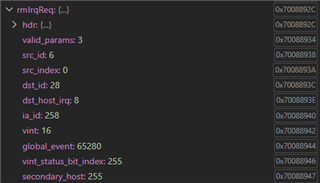

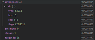

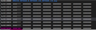

        //Configure events
        uint32_t globalEvent0 = Udma_chGetTriggerEvent(m_udmaCh0TxHandle, CSL_UDMAP_TR_FLAGS_TRIGGER_GLOBAL0);

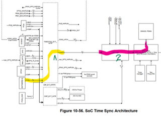

        //Maps Timer0 PWM to the output of the Interrupt Router
        configureRouter(Config::Aux::PulseRoutingDeviceId, Config::Aux::PulseRoutingSourceIdLocal, Config::Aux::PulseRoutingTargetIdLocal);
        //Configure the L2G mapping
        configureIntaggrL2G(Config::Aux::PulseRoutingL2GId, globalEvent0);
        //Config the PDMA peer Channel on the McSPI side
        Udma_ChPdmaPrms pdmaPrms;
        UdmaChPdmaPrms_init(&pdmaPrms);
        pdmaPrms.elemSize = UDMA_PDMA_ES_16BITS;
        pdmaPrms.elemCnt = 1U;
        pdmaPrms.fifoCnt = 1U;
        retVal = Udma_chConfigPdma(m_udmaCh0TxHandle, &pdmaPrms);
            return std::make_error_code(TxEngine_ErrorCode::PDMAConfigureError);
        retVal += Udma_chEnable(m_udmaCh0TxHandle);
        DebugP_assert(UDMA_SOK == retVal);
        //Submit TRPD to the TX channel
        uint64_t trpdMemPhysicalAddr = (uint64_t)Udma_defaultVirtToPhyFxn(m_udmaCh0TrMem, 0U, NULL);
        retVal = Udma_ringQueueRaw(Udma_chGetFqRingHandle(m_udmaCh0TxHandle), trpdMemPhysicalAddr);
            return std::make_error_code(TxEngine_ErrorCode::DMADescriptorEnqueue);
        m_init = true;
        return std::error_code();

    //Interrupt & L2G mapping
    //We use timer PWM events, which are router trough the Timesync Router
    const uint16_t PulseRoutingDeviceId = TISCI_DEV_TIMESYNC_EVENT_INTROUTER0;
    //Timer0 has PWM event id 0. Consult TRM 9.5.2/Table 9-73
    const uint16_t PulseRoutingSourceIdLocal = 0;
    const uint16_t PulseRoutingTargetIdLocal = 0;
    //The above PWM event local event will be mapped to bit 0 of the L2G inputs.
    //Consult TRM 11.2.1.2.5
    const uint16_t PulseRoutingL2GId = CSLR_DMASS0_INTAGGR_0_INTAGGR_LEVI_PEND_TIMESYNC_EVENT_INTROUTER0_OUTL_0 + PulseRoutingTargetIdLocal;

    void TxEngine::configureRouter(uint16_t device_id, uint16_t src_index, uint16_t dst_index) {
        int32_t status;
        struct tisci_msg_rm_irq_set_req rmIrqReq;
        struct tisci_msg_rm_irq_set_resp rmIrqResp;
        rmIrqReq.valid_params = TISCI_MSG_VALUE_RM_DST_ID_VALID | TISCI_MSG_VALUE_RM_DST_HOST_IRQ_VALID;
        rmIrqReq.src_id = device_id;
        rmIrqReq.dst_id = device_id;
        rmIrqReq.src_index = src_index;
        rmIrqReq.dst_host_irq = dst_index;
        rmIrqReq.secondary_host = TISCI_MSG_VALUE_RM_UNUSED_SECONDARY_HOST;
        status = Sciclient_rmIrqSetRaw(&rmIrqReq, &rmIrqResp, SystemP_WAIT_FOREVER);
        if (status != SystemP_SUCCESS) {
            DebugP_log("[Error] Sciclient_rmIrqSetRaw() returned %d.\r\n", status);
            DebugP_log("rmIrqReq.src_id = %d, ", rmIrqReq.src_id);
            DebugP_log("rmIrqReq.src_index = %d, ", rmIrqReq.src_index);
            DebugP_log("dst_host_irq = %d.\r\n", rmIrqReq.dst_host_irq);
    void TxEngine::configureIntaggrL2G(uint32_t localEvent, uint32_t globalEvent) {
        uint32_t eventRegOffset = CSL_DMASS0_INTAGGR_L2G_BASE + (localEvent * 0x20U);
        CSL_REG32_WR(eventRegOffset, (1U << 31U) | (globalEvent & 0xFFFFU));

    void TxEngine::udmaTxTrInit(uint8_t* pTrMem, uint32_t cqRingNum, const void* srcBuf, uint32_t length)
        //One TRPD (Transfer Packet Descriptor) can have multiple TRs (Transfer Request)
        //Make TRPD with TR15 TR type, size is 1 TR
        UdmaUtils_makeTrpdTr15(pTrMem, 1U, cqRingNum);
        //Set infinte reload count
        CSL_udmapCppi5TrSetReload((CSL_UdmapCppi5TRPD *)pTrMem, 0x1FFU, 0U);
        //Get a pointer to the firs t TR in the TRPD and set the TR parameters
        CSL_UdmapTR15* pTr = UdmaUtils_getTrpdTr15Pointer(pTrMem, 0U);
        pTr->flags    = CSL_FMK(UDMAP_TR_FLAGS_TYPE, CSL_UDMAP_TR_FLAGS_TYPE_1D_DATA_MOVE);
        pTr->flags   |= CSL_FMK(UDMAP_TR_FLAGS_STATIC, 0U);
        pTr->flags   |= CSL_FMK(UDMAP_TR_FLAGS_EOL, CSL_UDMAP_TR_FLAGS_EOL_MATCH_SOL_EOL);
        pTr->flags   |= CSL_FMK(UDMAP_TR_FLAGS_EVENT_SIZE, CSL_UDMAP_TR_FLAGS_EVENT_SIZE_COMPLETION);
        pTr->flags   |= CSL_FMK(UDMAP_TR_FLAGS_TRIGGER0, CSL_UDMAP_TR_FLAGS_TRIGGER_GLOBAL0);
        pTr->flags   |= CSL_FMK(UDMAP_TR_FLAGS_TRIGGER0_TYPE, CSL_UDMAP_TR_FLAGS_TRIGGER_TYPE_ICNT1_DEC);
        pTr->flags   |= CSL_FMK(UDMAP_TR_FLAGS_TRIGGER1, CSL_UDMAP_TR_FLAGS_TRIGGER_NONE);
        pTr->flags   |= CSL_FMK(UDMAP_TR_FLAGS_TRIGGER1_TYPE, CSL_UDMAP_TR_FLAGS_TRIGGER_TYPE_ALL);
        pTr->flags   |= CSL_FMK(UDMAP_TR_FLAGS_CMD_ID, 0x25U);  /* This will come back in TR response */
        pTr->flags   |= CSL_FMK(UDMAP_TR_FLAGS_SA_INDIRECT, 0U);
        pTr->flags   |= CSL_FMK(UDMAP_TR_FLAGS_DA_INDIRECT, 0U);
        pTr->flags   |= CSL_FMK(UDMAP_TR_FLAGS_EOP, 1U);
        pTr->icnt0    = length;
        pTr->icnt1    = 1U;
        pTr->icnt2    = 1U;
        pTr->icnt3    = 1U;
        pTr->dim1     = pTr->icnt0;
        pTr->dim2     = 0U;
        pTr->dim3     = 0U;
        pTr->addr     = (uint64_t) Udma_defaultVirtToPhyFxn(srcBuf, 0U, NULL);
        pTr->fmtflags = 0x00000000U;
        pTr->dicnt0   = 0;
        pTr->dicnt1   = 0;
        pTr->dicnt2   = 0;
        pTr->dicnt3   = 1U;
        pTr->ddim1    = pTr->dicnt0;
        pTr->ddim2    = 0U;
        pTr->ddim3    = 0U;
        //Perform cache writeback for 1 TR
        CacheP_wb(pTrMem, UDMA_GET_TRPD_TR15_SIZE(1), CacheP_TYPE_ALLD);
        return;

    2) Map the events from DMTIMER0 to the initialized BCDMA channel so that the timer periodically triggers the DMA transfer. This involves:
        //Configure events

    4) Configure the Transfer Requests (TRs) and send them to the BCDMA channel:
    5) The TR itself:
        pTr->icnt1    = 1U;
        pTr->icnt2    = 1U;
        pTr->icnt3    = 1U;
        pTr->dim2     = 0U;
        pTr->dim3     = 0U;
        pTr->dicnt0   = 0;
        pTr->dicnt1   = 0;
        pTr->dicnt2   = 0;
        pTr->dicnt3   = 1U;
        pTr->ddim2    = 0U;
        pTr->ddim3    = 0U;
        return;

  • Hi Anil,
    Just to clarify, as I want to ensure we're on the same page:
    1. I have an ADC attached to McSPI4 CH0 and CH1, with the SoC operating in Multi-Channel Controller mode.
    2. I am using a timer to generate a 128 kHz PWM signal, which should trigger a 16-bit DMA WRITE—first on CH0, then on CH1. I achieve this using two BCDMA+PDMA channel pairs. The first channel triggers the DMA that writes to McSPI CH0, and upon completion, the second DMA channel is triggered from the first and writes 16-bit data to McSPI CH1.
    3. I have configured two additional BCDMA+PDMA pairs (one for McSPI CH0, one for McSPI CH1) that will be triggered by an McSPI DMAR from the respective McSPI channel. The DMAR is generated on reception, which occurs as a result of (2).
    Let’s focus on (2), as I believe the rest is straightforward to implement.
    Once again, the TX direction (BCDMA+PDMA, McSPI4 TX) is functioning perfectly. I have verified this on the oscilloscope—the data is present and correct. I can share a screenshot of the scope if needed.
    Below is my TR setting procedure for both McSPI4 TX channels (McSPI4 CH0, McSPI4 CH1):
        pTr->flags   |= CSL_FMK(UDMAP_TR_FLAGS_WAIT, 1);
        pTr->flags   |= CSL_FMK(UDMAP_TR_FLAGS_TRIGGER0_TYPE, CSL_UDMAP_TR_FLAGS_TRIGGER_TYPE_ALL);
        pTr->icnt1    = 0;
        pTr->icnt2    = 0U;
        pTr->icnt3    = 0U;
        pTr->dim1     = 0;
        pTr->dim2     = 0U;
        pTr->dim3     = 0U;
        pTr->dicnt0   = 0;
        pTr->dicnt1   = 0;
        pTr->dicnt2   = 0;
        pTr->dicnt3   = 0;
        pTr->ddim1    = 0;
        pTr->ddim2    = 0U;
        pTr->ddim3    = 0U;
        CacheP_wb(&m_txData, sizeof(m_txData), CacheP_TYPE_ALLD);
        return;
    The line:
    • pTr->addr = (uint64_t) Udma_defaultVirtToPhyFxn(srcBuf, 0U, NULL);
    specifies the address of the dummy data to be sent over the SPI interface to trigger the ADC to output its data.

  • Hi Anil,
    To your suggestion above:
    As expected, it didn't work, because the SciClient returned an error:
    Below the values of the request to the SciClient:
    ...and the response from the client:
    don't think you can use the SciClient in such a way in this case, the routing should rather take place in the TimesyncEventRouter itself, ie.

  • One more thing:
    I have checked the registers ot the TimeSync Router and the L2G:
    • For the TimeSync Router:
    From the TRM:
    If I am reading it correctly, that means: Interrupt output 0 is mapped to Interrupt Input 0 (PWM0), and the output is enabled.
    • For L2G:
    From the TRM:
    I am using GlobalEvent8, which is tied to the TimeSync Router output 0, so the offset is 8*20h=100h, which gives us L2G Register address 0x48120100. The register's value (0x8000C40C) decodes as follows:
    Bit 31 = High, meaning Rising Edge event detection mode
    GEVIDX = 0xC40C, which is exactly the Global Event Index for the BCDMA Channel:
    According to what I am reading in the TRM and if I am correctly interpeting the information, the TimeSync router and L2G are configured properly.
    Regards!

    What does that mean? Did you manage to trigger some DMA channel? Ohterwise, if not, how do you know, that you successfully set the TSR?
    Follow-up:
    I tested your suggestion, it apparently sets the IR route correctly, as seen from the register values. However, I am still not seeing the DMA channel to be triggered.

    · · rmIrqReq.src_id · · · · · · · · = TISCI_DEV_TIMESYNC_EVENT_INTROUTER0;
    · · rmIrqReq.src_index · · · · · · ·= 0U;
    · · rmIrqReq.dst_id · · · · · · · · = TISCI_DEV_DMASS0_INTAGGR_0;
    · · rmIrqReq.dst_host_irq · · · · · = 8U;
    XXXXXXXXXXXXXXXXXXXXXXXXXXXXXXXXXXXXXXXXXXXXXXXXXX
    I have followed the above steps.

    Please look at the architecture below.
    I am thinking it could be ok to go further with 4-D transfer, I am currently looking at 11.1.3.3.2.1 Linear Addressing (Forward). That is the algorithm, used with the 4D-Transfer, right?

    Is it possible for you to try to make a test project, similar to my problem: Let say:
    1. BCDMA TX channel, bound to a PDMA on McSPI multichannel controller on Ch0. Trigger is Timer0 PWM output
    2. BCDMA TX channel, bound to a PDMA on McSPI multichannel controller on Ch1. This channel chained to (1), means TR completion on (1) triggers this channel
    Actually, even only (1) would be enough to see, that this combination works.

    #define UDMA_GET_TRPD_TR3_SIZE(n)      (UDMA_ALIGN_SIZE(sizeof(CSL_UdmapTR3) + ((n) * (sizeof(CSL_UdmapTR3) + 4U))))
    static void MCSPI_udmaTrpdInit(uint8_t* pTrMem, uint32_t cqRingNum, const void* Buf, uint32_t length)
        CSL_UdmapTR3 *pTr = NULL;
        UdmaUtils_makeTrpd(((uint8_t *) pTrMem ), UDMA_TR_TYPE_3, 1, cqRingNum);
        pTr = UdmaUtils_getTrpdTr3Pointer((uint8_t *)pTrMem , 0);
        pTr->flags = CSL_FMK(UDMAP_TR_FLAGS_TYPE, CSL_UDMAP_TR_FLAGS_TYPE_4D_DATA_MOVE);
        pTr->addr = (uint8_t)Buf;
        pTr->icnt0 = (uint16_t)length;
        pTr->icnt1 = 1;
        pTr->icnt2 = 1;
        pTr->icnt3 = 1;
        pTr->dim2     = (pTr->icnt0 * pTr->icnt1);
        pTr->dim3     = (pTr->icnt0 * pTr->icnt1 * pTr->icnt2);
        CacheP_wb(((uint8_t *)pTrMem  ), UDMA_GET_TRPD_TR3_SIZE(1), CacheP_TYPE_ALLD);

    Unfortunately, we are again there, where we already were: Type 3 TR works, however not with an external trigger. I have the follwoing remarks:
    1) The example you posted might be working, but has some bugs:
    • I think it is not correct to use CSL_UDMAP_TR_FLAGS_TYPE_4D_DATA_MOVE in the flags
    • pTr->addr = (uint8_t)Buf is a wrong cast!
    • The rest of the descriptor's flag has to be set, in order to enable TR0 repetition
    2) I have corrected the above bugs and I am able to trigger the transfer, I see the correct data on the SPI lines, but I am still unable to trigger the DMA requests with DMTIMER0 and chain 2 requests.
    Once again, I am pretty sure, that the problem hides in the event propagation within the DMASS, but I cannot investigate further, as the description of the Interrupt Aggreagator and the L2G in the TRM is awful, for example things like:
    and
    speak for themselves.
    Regards!
  • Hi Anil,
    Meanwhile I was able to find out several things:
    • The PWM signal from DMTIMER0 is functioning correctly—it reaches the TimeSync Router and we managed to route it out of the SoC to the SYNC_OUT2 output, where we were able to observe the signal. Simultaneously, the same signal is being routed to the L2G module on Input 8, so the signal visible on SYNC_OUT2 also propagates to the L2G module.
      Unfortunately, the DMA still doesn’t trigger.
    • In the TimeSync Router, when we set the trigger mode to CSL_UDMAP_TR_FLAGS_TRIGGER_LOCAL_EVENT, we observe that the DMA writes continuously to SPI4—not due to the PWM trigger, but rather because it repetitively executes the Transfer Request (TR). These SPI writes occur approximately every 150 ns, which is way faster than the PWM signal (about each 10us).
    • I implemented a TR0-type Transfer Request Packet Descriptor (TRPD), which significantly simplifies the configuration of icnt, dim, and related parameters. This should be the appropriate TR type (1-D transfer) for our use case.
    The PDMA channels cannot be paired with Type 15 Transfer Requests (TRs).
    Hence, I proceeded to implement a Type 3 TR in the driver and verified the setup.
    • I'm not sure what led you to believe that the TR type affects the ability to pair BCDMA and PDMA channels—perhaps you have access to information I don't. If that's the case, I’d really appreciate it if you could share it.
      Regardless, I observe the same behavior when using TR15, TR3, or TR0 types. Whether triggered via software or using CSL_UDMAP_TR_FLAGS_TRIGGER_LOCAL_EVENT, the SPI interface writes correctly, seemingly independent of Global Trigger 0.
      Therefore, I believe the area we should focus on for further investigation is BCDMA channel triggering and possibly the L2G mapping—although I don't currently suspect there's an issue there.
    Angel
