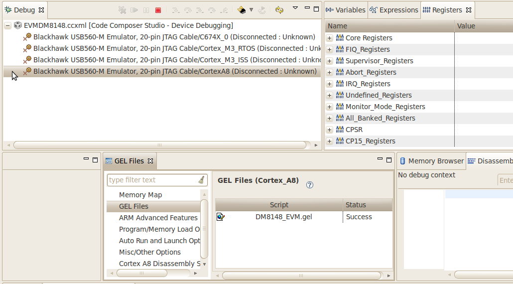

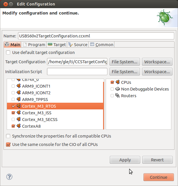

DM814x DDR3 SW Leveling - Byte Wise
Tool      : CCS 5.5.0.00077
Platform  : Ubuntu 12.04
Objective : Byte wise SW leveling
Ref.      : http://processors.wiki.ti.com/index.php/TI814x-DDR3-Init-U-Boot
Under CPSR, if T=1 (THUMB) the code ran automatically after being loaded and the console input option ]does not appear.
So, I've changed T=0 (ARM), but I got the error messages as shown in Run-Err.png.

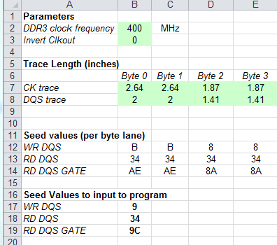

The input parameters are in these order:
0
0x9C
0x34
0x9
RVR_DDR3_SW_LEVELING_OUTPUT
Are my inputs wrong?
RVR-Output - Output from the "DDR0_RegisterReadBack" hot menu.
Help please....

    The ARM mode is set by default and you should keep it. I mean there is no need to manually change this CPSR.T bit to 0 (ARM mode), as it should be by default.
    Le George said:
    2. When CortexA8 is connected, the default GEL file (e.g. DM8148_EVM.GEL) is auto-executed, how do I verify that this action has taken place? To manually reload it and rerun the GEL initialization, what are the required initialization steps (scripts)?
    Before you connect to Cortex-A8 core, you should check that the DM8148_EVM.GEL file is selected:
    Tools -> GEL files -> DM8148_EVM.GEL
    See the screen shot below:
    Make sure you have selected the Cortex-A8 core (as in the screen shot).
    Then, when connect to the Cortex-A8 core, you should see in the CCS console the below output:
    CortexA8: GEL Output:
    Connecting Target...
    CortexA8: Output:      ****  DM8148 ALL ADPLL INIT IS In Progress .........
    CortexA8: GEL Output:      A8 ADPLLJ CLKOUT  value is  = 600
    CortexA8: GEL Output:      L3  ADPLLJ CLKOUT  value is  = 200
    CortexA8: GEL Output:      DSP ADPLLJ CLKOUT  value is  = 500
    CortexA8: GEL Output:      DSS ADPLLJ CLKOUT  value is  = 200
    CortexA8: GEL Output:      HDVICP ADPLLJ CLKOUT  value is  = 266
    CortexA8: GEL Output:      SGX ADPLLJ CLKOUT  value is  = 200
    CortexA8: GEL Output:      USB ADPLLJ CLKOUT  value is  = 192
    CortexA8: GEL Output:      VIDEO-0 ADPLLJ CLKOUT  value is  = 54
    CortexA8: GEL Output:      VIDEO-1 ADPLLJ CLKOUT  value is  = 148
    CortexA8: GEL Output:      VIDEO-2/HDMI ADPLLJ CLKOUT  value is  = 148
    CortexA8: GEL Output:      AUDIO ADPLLJ CLKOUT  value is  = 200
    CortexA8: Output:      ****  DM8148 ALL ADPLL INIT IS  Done **************
    CortexA8: Output:     PRCM for C674x is in Progress, Please wait.....
    CortexA8: GEL Output:      CP0...Done
    CortexA8: GEL Output:      CP1...Done
    CortexA8: GEL Output:      CP2...Done
    CortexA8: GEL Output:      CP3...Done
    CortexA8: GEL Output:      CP4...Done
    CortexA8: GEL Output:      CP5...Done
    CortexA8: GEL Output:      CP6...Done
    CortexA8: Output:     User Can Connect to C674x
    CortexA8: Output:     PRCM for C674x is DONE ******
    CortexA8: Output:     PRCM for Control Module in Progress
    CortexA8: Output:     PRCM for Control Module Done
    CortexA8: Output:     PRCM for OCMCRAM0/1 Initialization in Progress
    CortexA8: Output:     PRCM for OCMCRAM0 Initialization Done
    CortexA8: GEL Output:      ***** Configuring ethernet Clk and Mux....*****
    CortexA8: GEL Output:      ***** GMII pin mux and Clk initialized....*****
    CortexA8: Output:     PRCM for SPI-0 CS-0 is in Progress, Please wait.....
    CortexA8: GEL Output:      ***** SPI-0 CS-0 is initialized....*****
    CortexA8: Output:     PRCM for SD/MMC0 are in Progress, Please wait.....
    CortexA8: GEL Output:      ***** MMC0/SD is initialized....*****
    CortexA8: GEL Output:      ****  Configuring DDR PLL to 533 MHz.........
    CortexA8: GEL Output:      DDR ADPLLJ CLKOUT  value is  = 533
    CortexA8: Output:      ****  DM8148 DDR3 EVM EMIF0 and EMIF1 configuration in progress.........
    CortexA8: Output:     Busy reading back DMM registers Please wait ...
    CortexA8: Output:     DMM register read successfully
    CortexA8: Output:      ****  DM8148 DDR3 EVM EMIF0 and EMIF1 configuration is DONE ****
    CortexA8: GEL Output: Connecting Target... Done.
    This is auto-executed, as we have the below function into the DM8148_EVM.GEL (which is auto-executed when connect to the Cortex-A8 core):
    OnTargetConnect()
        GEL_TextOut( "\nConnecting Target...\n" );
        GEL_Reset();
        ALL_ADPLL_CLOCKS_ENABLE_API();
        C674xClkEnable_API();
        ControlModule_ClkEnable();
        PrcmAlwayOnClkEnable();
        Ethernet_PinMux_Setup();
        SPI_Setup();
        SD_MMC0_Setup();
        DDR3_EMIF0_EMIF1_533MHz_Config();
        GEL_TextOut( "Connecting Target... Done.\n\n" );
    If you do not have any initialization when connect to the Cortex-A8 core, you should manually add/load some fully operational GEL file (not only for DDR3) and manually start the scripts to initialize the things that are initialized from the auto-executed function (PLLs, PRCM, Control Module, etc)

    2. DM8148_EVM.GEL
       Running this GEL prior connecting the Cortex-A8 core has little effect with our tests.
       However, we got the message below of both custom boards with most fields contains 0's:
         "... MINIMUM VALUE DIDN'T CONVERGE"
       The EVM board had no problem.
    Note: Using a different GEL file, the CONVERGE message went away for the custom board. The result is identical for 3 repeated tests with the same input data set. However, the output is the same with the TI input values. Hmmm...
    [CortexA8] Enter 0 for DDR Controller 0 & 1 for DDR Controller 1
    0
    DDR START ADDR=0x80000000
    Enter the Seed Read DQS Gate Ratio Value in Hex to search the RD DQS Gate Window
    0x9c
    Enter the Seed Read DQS Ratio Value in Hex to search the RD DQS Ratio Window
    0x34
    Enter the Seed Write DQS Ratio Value in Hex to search the Write DQS Ratio Window
    0x9
    Enter the input file Name
    DM8147_400MHz_RRGEL_1

  • Le George,
    Le George said:
    2. DM8148_EVM.GEL
    This DM8148_EVM.gel file should be run (automatically) at the same time of connecting to the Cortex-A8 core or (manually) after connecting to the Cortex-A8 core. This DM8148_EVM.gel file should not be run (manually) prior/before connecting to the Cortex-A8 core.

    Please go through all the steps described in the wiki:
    http://processors.wiki.ti.com/index.php/TI814x-DDR3-Init-U-Boot#Overview
    1. Calculate the seed values to be input to the slave ratio search program ie:“DDR3_SlaveRatio_ByteWiseSearch_TI814x.out” as described in the subsequent sections.
    2. Configure the DDR controller (Also referred as EMIF) with the timing parameters calculated from the spreadsheet File:DM814x DDR Controller Register Configuration spreadsheet v1.0.zip based on the timing parameters mentioned in the data sheet of the specific DDR device being used.
    3. Configure the DDR PHY slave ratio registers with the respective seed values calculated from the spreadsheet.
