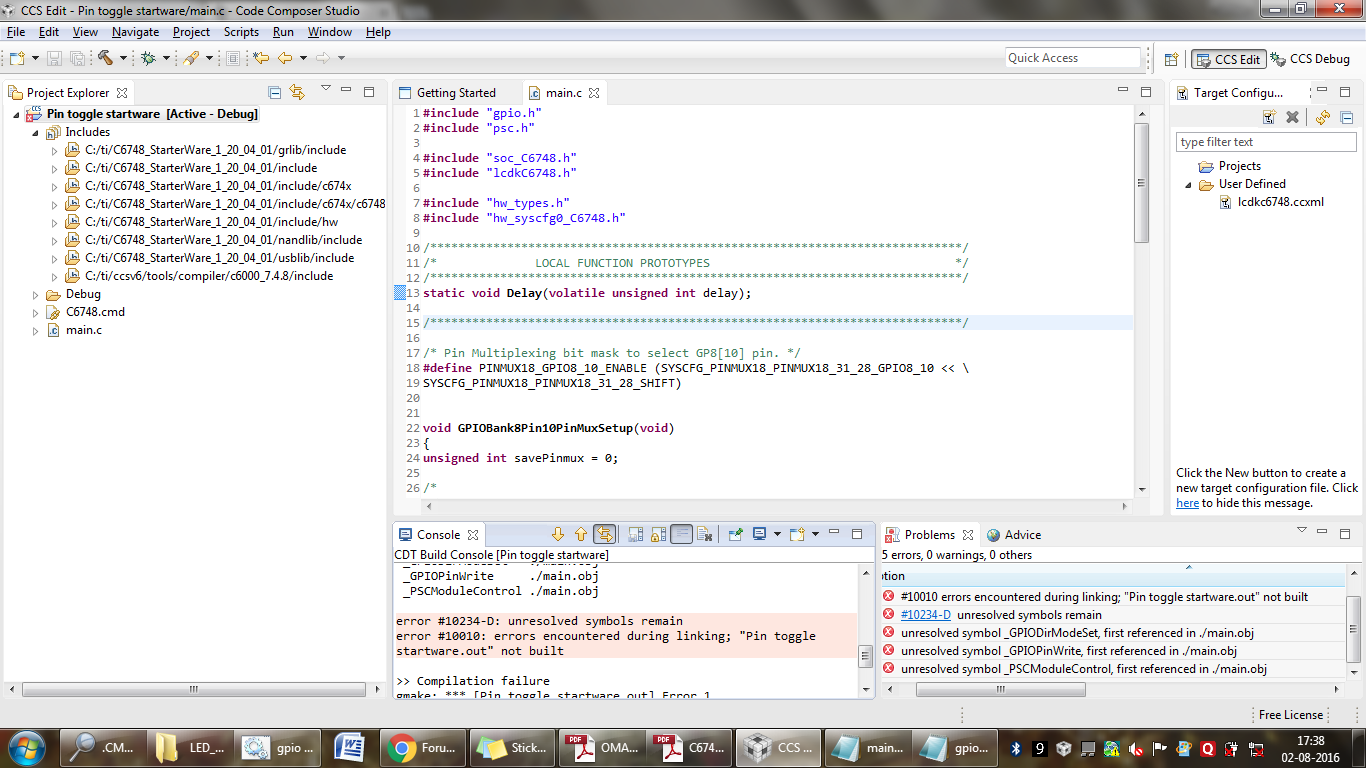

  • Hello Shankari,
    Thanks for above clarification.
    But getting some issues regarding linking.
    I tried to link with C6748.cmd and also with gpio.cmd from StarterWare as below.
    C:\ti\C6748_StarterWare_1_20_04_01\build\c674x\cgt_ccs\c6748\lcdkC6748\gpio
    But for both I am getting errors.
    Could you please help me with this.
    Onkar

    In continuation with above query,
    I think I am not able to link proper .lib files in File search path.
    Could you please tell me names and location of those files in StarterWare because there are many .lib files in the starterWare.
    And I am not sure which are to be included.
    Onkar
