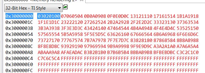

    I don't know how you know the data was written to your QSPI. Then you power cycle, you found the data is zero. Is the data really written to there but read back problem or the data writing didn't happen at all?
    For the IDK here, I knew the pattern as below. Then I power cycle the board, I run the same program again and after SF25FL_open() I halt the A9 core. Then from CCS window I looked at the address 0x30000000 to make sure the pattern is still there.
    Are you able to do the same to read back?
    Regards, Eric
