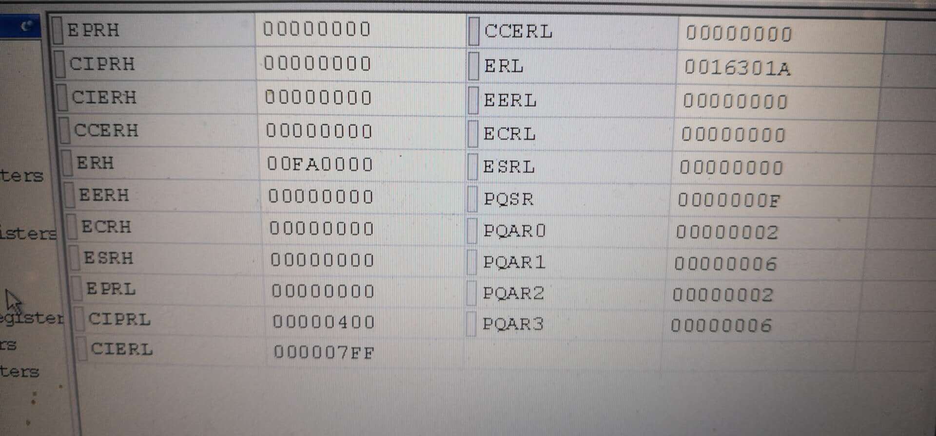

My program work flow is: FPGA trigger INT4(ever 0.5ms)----->ISR(INT4) start edma transmit(move data from EMIFA to L2 SRAM,need 150us to complete the tranfer),using TCC=10----->EDMA_int  ISR.
My problem is, when the EDMA transmit complete,the CPU interrupt (EDMA_int  INT8) is not triggered?And the problem happen rarely,Maybe happen once in an hour.
