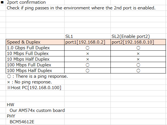

My customers check RGMII on AM5746's custom board.
They found a problem that communication was not possible only 10BASE-T.
(10BASE-T test on IDK574x had no problem.)
We noticed that rgmii0_txctl (V9) was not High at 10BASE-T.

    I'm sorry for my late reply. My customers were working on another issue.
    The SL_MACCONTROL register was "0x40020". (Destination is 10Mbps Half)

    And they also dumped registers that might be related.

          SL_MACCONTROL  00040020   FULLDUPLEX          0         LOOPBACK    0
                                    MTEST               0         RX_FLOW_EN  0
                                    TX_FLOW_EN          0         GMII_EN     1
                                    TX_PACE             0         GIG         0
                                    TX_SHORT_GAP_EN     0         CMD_IDLE    0
                                    IFCTL_A             0         IFCTL_B     0
                                    GIG_FORCE           0         EXT_EN      1
                                    TX_SHORT_GAP_LIM_EN 0         RX_CEF_EN   0
                                    RX_CSF_EN           0         RX_CMF_EN   0
          SL_MACSTATUS   80000000   TX_FLOW_ACT         0         RX_FLOW_ACT 0
                                    EXT_FULLDUPLEX      0         EXT_GIG     0
                                    IDLE                1
          SL_SOFT_RESET  00000000   SOFT_RESET          0

          SL_MACCONTROL  000000A1   FULLDUPLEX          1         LOOPBACK    0
                                    TX_PACE             0         GIG         1
                                    IFCTL_A             0         IFCTL_B     0
                                    GIG_FORCE           0         EXT_EN      0
          SL_MACSTATUS   80000018   TX_FLOW_ACT         0         RX_FLOW_ACT 0
                                    EXT_FULLDUPLEX      1         EXT_GIG     1
                                    IDLE                1

    Rei
  • Hi Ming,
    Do you have any updates?
    Rei
  • Hi Rei,
    In your previous post, you said that the SL_MACCONTROL is 0x40020, but in emac_cpsw_info.pdf, you mentioned that the macControl is 0x40021. What is the actual value in SL_MACCONTROL? also make sure it is agree with the phy settings.
    Ming

    I'm sorry to bother you over and over.
    My customer also failed to communicate at 10Mbps on the SL2 side.
    The following are comments from customers.
    So we think we have another issue. Customers are confirming about PHY registers.
    Regards, Rei
  • Hi Rei,
    Can they repeat the same experiment on AM572x GP EVM or IDK?
    Our developer cannot re-produce the issue on AM572x IDK, but can re-produce the issue on eth0 of AM572x GP EVM.
    If they cannot reproduce the issue on IDK or eth1 on GP EVM, then the problem is likely the customer board or phy.
    Ming

    In IDK574x, CRC became 0 and Good increased. Thank you soooo much!
    However, customer environment remains unable to communicate....
    All we know is that TX_CTL is not driven only during 10Mbps communication.
    Customer's PHY seems to be working(10Mbps) when using other processor.
    I discuss with customers how to resolve this.
