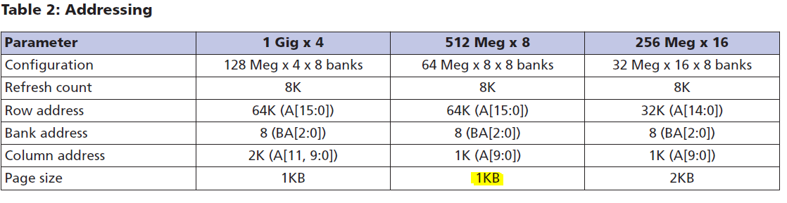

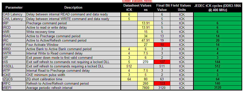

But, when I try to calculate EMIF values using app. note below, I'm confused what value I should select especially tFAW and tRFC.
As it's basic part is MT41K512M8, I input the parameters from it, but it was colored as red in the EMIF cal. excel file as below.
In MT41K512M8,
https://www.micron.com/products/dram/ddr3-sdram/part-catalog/mt41k512m8da-107-it
I found the page size is 1KB and thus tFAW is 27 as it is 8bit die.

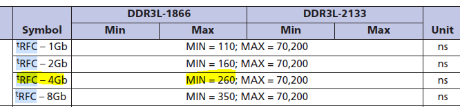

For tRFC, I selected 260ns because single die is 4Gb.

  • SI, it looks like you have input the timings correctly, but you probably did not fill out the DDR memory specs correctly on the System Details tab.  For the memory your customer chose, it should look like this:
    Detail Description Value Units
    6 Speed Bin: Data Rate 1866 MT/s
    7 Density (per device) 4 Gb
    8 Number of Rows 16 -
    9 Number of Columns 10 -
    10 Number of Banks 8 -
    11 Speed Bin: CAS Latency @ 1866MT/s data rate 13 ntCK
    12 Width (per device) 8 Bits
    13 Average Periodic Refresh Interval 7800 ns
    This should fix the red cells in the spreadsheet.

  • Hi James,
    That is the point. The red cells were removed with this modification you suggested, but I'm not sure if this is right because the device has 8Gb density and 16bit I/F by combining 2 dies.
    I found there is no difference in the EMIF register values with/without your modification, and my customer can access just up to 512MB region of total 1GB region.
    Do you think what should be modified to access remained 512MB of DDR memory?
