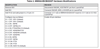

    I have not done the out of the box demo for IWR6843ISK as there were hardware modifications to be done on the MMWAVEICBOOST Board .
    Is it possible to run the out of the box demo even after making these changes?
    Vandana
    Yes it looks like it should still be fine to run the OOB demo. You will just need to set the switch settings back to default. These settings will be in the schematic for the ICBoost. Please make sure the OOB demo runs before setting up the wireless transfer.

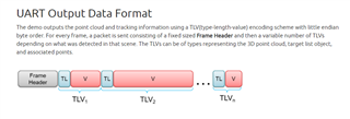

    Thank you for providing the link to the mmwave sdk. When I read the OOB demo documentation they are saying the output can be saved in .dat format in mmwave demo visualizer or through DCA1000. I also found another example 3D People Counting where the output is transmitted through UART in the following format.
    This is similar to the output from TIDA-010022. which is then transmitted through wireless transmission. Which one do you suggest that I should go on with?
    Vandana
    I suggest using the mmWaveDemo Visualizer, as it will save the UART data. If you use the DCA, it will output raw ADC data which still needs to be processed.
