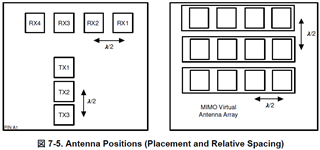

    2) For example,
     A) Use AWR1843AOP in the same direction as in the below image
     B) Use AWR1843AOP rotated 180 degrees from the below image (the order of chirp signal transmission is the same as A))
     are there any differences for estimating AOA between A) and B)?
    Please advise.
    Thank you.
    Shoko

  • Hello Shoko-san,
    Please find my responses as follows:
    1) Are there any differences for estimating AOA between these sequences?
    Yes. You would need to re-order the data before performing any angle processing based on the appropriate virtual antenna sequence following the physical placement of the antennas. If not, it does not have any meaningful information.
    2) Are there any differences for estimating AOA between A) and B)?
    For a 180-degree shift along the depth-axis, the effective azimuth angle measured will incur a sign flip provided the processing algorithm remains exact. For example: 30 deg will be come -30 deg if the sensor facing forward is rotated by 180 deg along the boresight axis.
    Based on your questions, please understand that the order of the antenna physically and virtually is fundamental information required to estimate angle from MIMO radars.
    Let me know if there are further questions.
    Kaushik

  • Hi Shoko-san,
    The order in all cases (A, B and C) needs to be re-ordered before performing angle processing. If it is not in the right order, then there is no angle estimate that would be right. After re-ordering, the AoA estimate from all cases are theoretically the same.
    Kaushik
